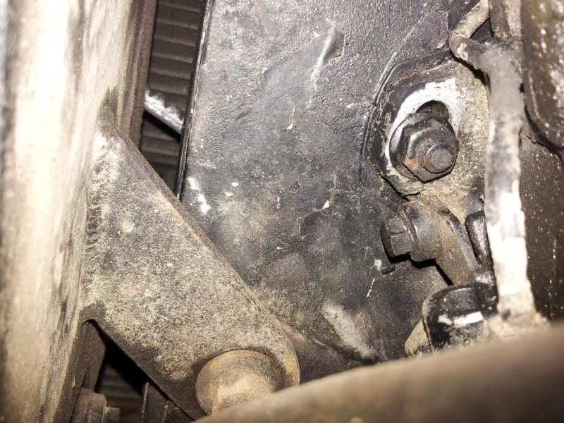

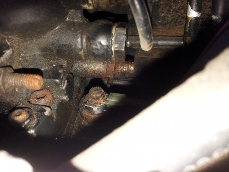

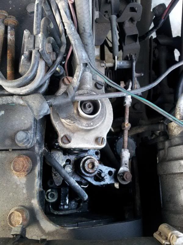

To the trained eye, how does the setting look on the pump?
This is the driver side pump bolt, is there a mark on the timing cover under the gunk to match the one on the pump?
