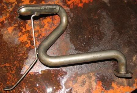

this is what they look like right off the truck
do you think theres enough room to get a wrench in the pan if you pull all the bolts but not lift the motor

Postby cummins king » Fri Mar 28, 2008 5:40 am
and the other side

Postby 284 » Fri Mar 28, 2008 5:09 pm
Joel,
Thanks for the pics. Now I know there's a screen on it, so that protects me.
My ranger didn't and it sucked a piece of gasket cork up into the tube, blocking it.
Tomorrow's the day to start going at it.
