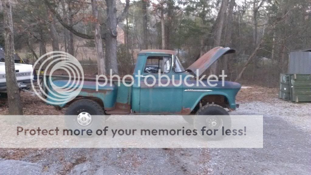

Any more pics of the truck?
Re: Number 6 cylinder knock
Postby Luther Grimace » Thu Feb 14, 2013 3:11 pm
Yeah. Here is when I first got it.
Then I threw on some 37s and rebuilt the Getrag.
Drove it like this for a while. Even with the knock which started a month after I bought it.
http://www.youtube.com/watch?v=Xb_Y0DxnpoE
Shortened it and bobbed a swb bed.
Found a 55.2 Chevy Truck at the junk yard and have been working on a cab swap for a long time now. Ready to drive it but decided to fix the knock.
