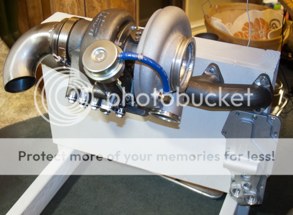

So I decided to go the he351 route for now bc the PO gave me one when I bought the van (1990 12v swapped E350)
Over the next year I think I’ll start doing valve springs and studs to get ready for a s362sxe, but need to make sure it will fit with my flipped manifold and lack of space.
Does anyone have a pic of their 362 with wastegate? Just trying to get an idea of how it’s oriented.
Also any comments on spool time for the borg warner? I drive around town a lot and want quick spool and little to no smoke.
Thanks.

Keep in mind this install is with the stock location manifold that's been flipped . . . .

Thanks that’s exactly what I needed to see. My manifold is flipped.
How much does the wastegate actuator stick out past the compressor housing?

Postby Justgosurfin » Fri Dec 13, 2019 3:01 pm
BC847 wrote:Keep in mind this install is with the stock location manifold that's been flipped . . . .
Also, what do you use that stand for?

Postby BC847 » Mon Dec 16, 2019 3:31 pm
Justgosurfin wrote:Thanks that’s exactly what I needed to see. My manifold is flipped.
2~3ish inches give or take.

Postby BC847 » Mon Dec 16, 2019 3:36 pm
Justgosurfin wrote:Also, what do you use that stand for?
I built it to generally mimic the basic long-block for the purpose of fitting mess to it.
