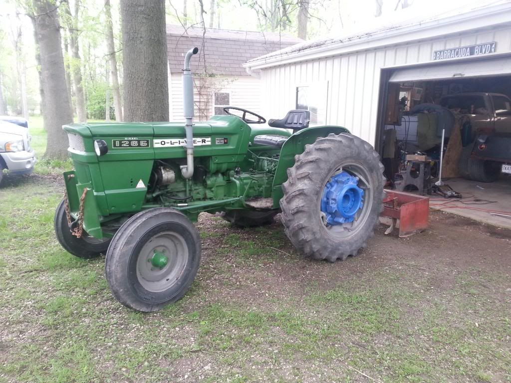

Pops got his tractor back the other day. Stupid, simple fix for the fuel issue and a new starter got her running real nice. We (me) need to reinstall the thermostart so it will fire without ether in the cold. Anybody know where I can find some rear tires?

What does the thermostat have to do with it starting? Or not the water thermostat?

Postby RumbleFish » Fri May 16, 2014 5:56 pm
Its thermostart Pete. It shoot warm fuel into the intake so it will start when its cold out.
The truck on jackstands is a 1st gen dakota with a 426ci smallblock. It goes 10.80s. Beside it is his ratrod, you can just see the corner of the bed.

What was the fuel issue?

Theyre cracked and rotted pretty bad Caleb. He found some on ebay, near new, for $365 each in chillicothe oh. The fuel issue was that neither of us found the ip bleeder screw high on the inside of the pump. That explains why itd start by cracking the injectors. Couple this with a weak starter and you get total aggrovation of my dad who is new to diesel tractors lol. To make it worse, he has a fuel system book for this thing i didnt know about and he hasnt opened!
