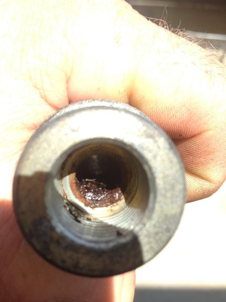

Bitchin? I'd like to say that I ain't bitching now,you should have heard me when I found out what was wrong with this thing :?
I boardered on insanity when I found out I had to remove all these parts again....pump,injectors,and complete rail/line system. To clean this
To add to things I just got off the phone with the injector shop.....one of there hands called me to tell me there was nothing wrong with those injectors. Bs I say,I got an extra gallon of oil......where in the hell did it come from? Gotta be a stuck one some where. I told him to look harder :? And call me back. I ain't stupid,one is/was bad.
I'm fixin to go work construction or something :roll:
Postby ellis93 » Wed Jun 04, 2014 1:15 pm
God smiles upon me :)
Getting all 8 replaced for free under the builders warranty.
Now I just have to get the rest cleaned up :(
Do y'all have any idea what gm wants for those injector lines and two rails? I do and it's freakin high.....1600$ :shock:
Guess I'll be dropping these in my chemical dip for carbs for a few days :lol:

Any screens in those rails or lines?
Better check them pretty thoroughly, our 6.0 and dad's injectors had screens all over the place. Don't want them holding anything.
Postby ellis93 » Wed Jun 04, 2014 2:21 pm
Non that I can see Levi.
Postby dazedandconfused » Wed Jun 04, 2014 4:03 pm
That's the worst rail I've ever seen. Blow all the big sthi out if you can before you soak them. Speaking of 6.0 how is the crew coming?

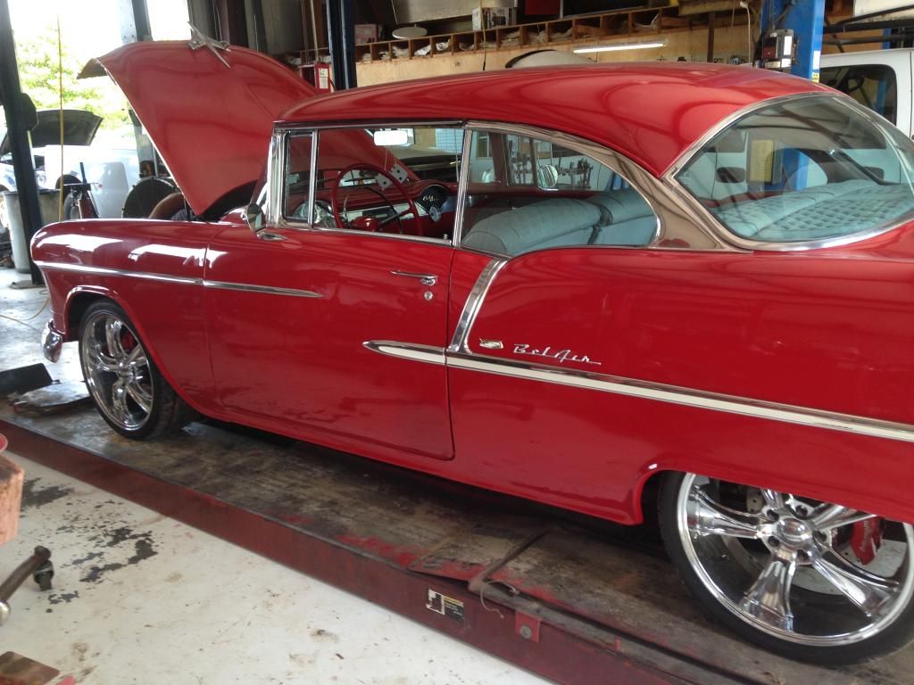

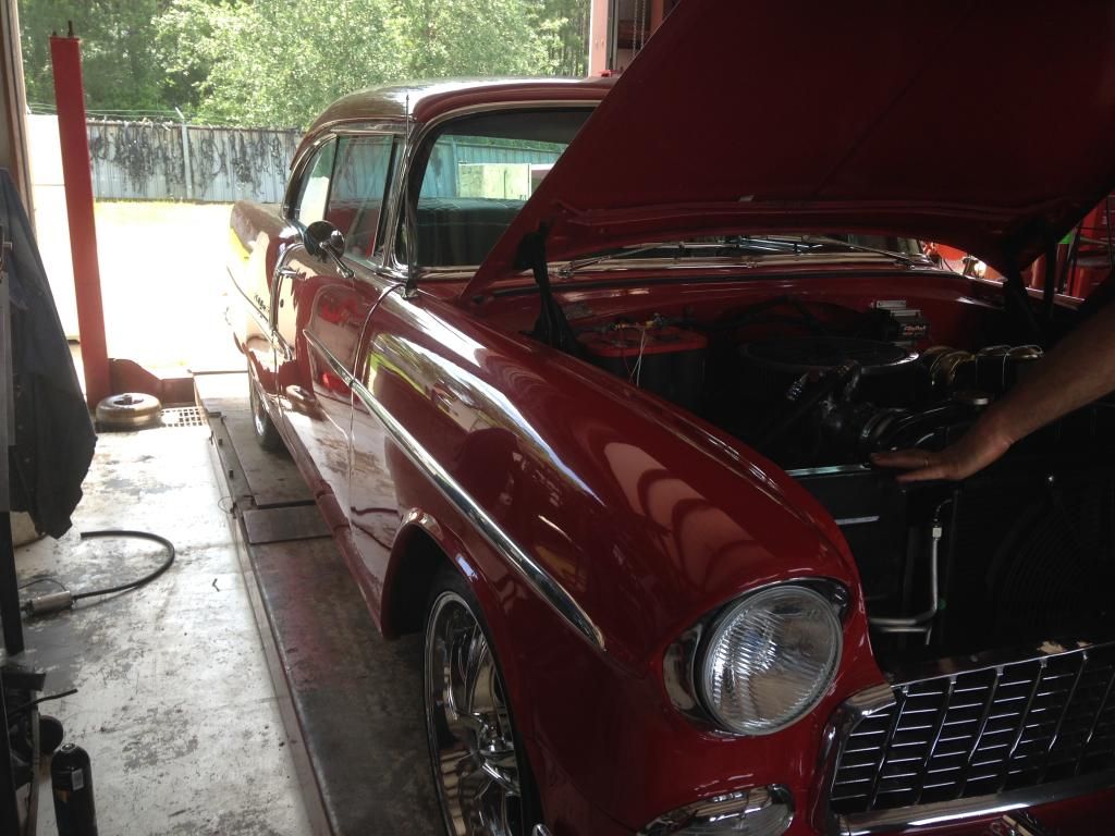

Sometimes I get to work on/drive cool schit :)
Nice car.......except for the G wheels on it :roll:
Postby RCCUMMINS89 » Thu Jun 05, 2014 3:16 pm
I think the "g" wheels fit the car.
Ellis.... just because you get to work on it, doesn't mean the owner was ok with you also driving it. Just to make sure when you changed the oil it didn't put the tires out of balance... piss poor excuse man.
Postby matthewh » Thu Jun 05, 2014 3:23 pm
No fins out back, so a '55? Nice car, not a huge fan of the wheels either. Some of these cars look good with big wheels, but they have to flow with the style, them dont.
For instance, awhile back there was a mid 50's Buick in Hot Rod mag, built by Rad Rides by Troy. That had 20's on it, but they fit with the car. I'll try and find a pic.
Either way, sweet car, owner can do as he wants, if he likes it, all that matters
