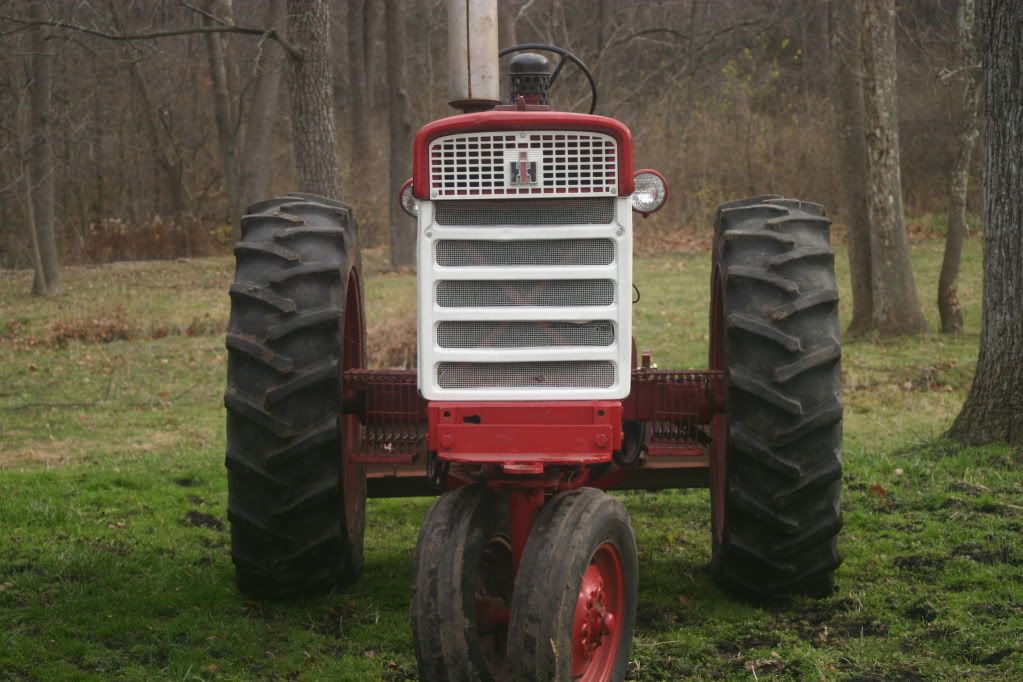

Get it warmed up,with the air cleaner off,rev it up and smoother it down with your hand over the carb till it nearly dies,remove hand and clean it out by reving it back up. I do this two or three times and it usually work good for clearing goo and trash out of the boosters,which is what's wrong with yours Caleb.
I'll be dogged! I think it worked. I got bored after watching it run flawlessly for 20 minutes, which is twice as long as it had been.
Thanks guys!

2 hours of mowing pasture and roadsides says the carb on my tractor is fixed. I dumped some cheap gas treatment in the tank for good luck. runs like a top again 8)
