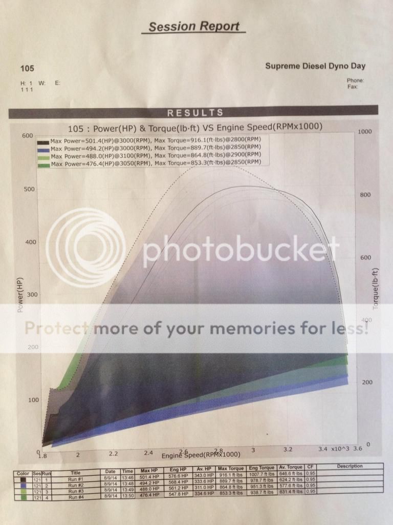

So jaeger went on the dyno today. Numbers were a bit low, but still managed 501/979 on a 3300us tune. It falls off hard by 3600 though. Also it could only hold 19-20ksi rail pressure while I was commanding 25-26k (it holds fine on a 2800us tune though)

On second thought I think my truck made the most hp on the 3200us tune rather than the 3300us tune.

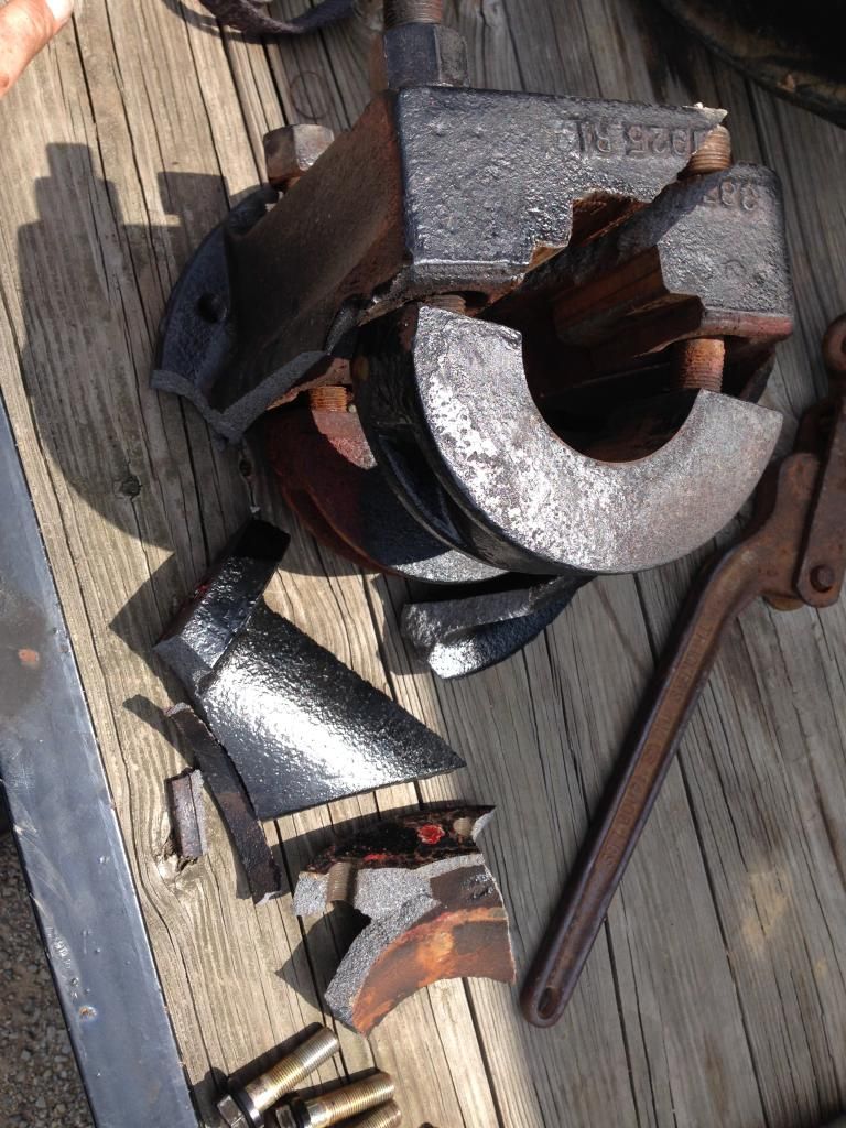

Carnage pic as promised.

well if its all a clean/new break I say you have exceeded the power limits of the hub clamps :mrgreen:
Postby diesel freak01 » Sun Aug 10, 2014 7:51 pm
I believe you are correct! Put a different style on until we can get weld on hubs installed this winter. Have a serious oil leak from the head gasket so I get to pull the head and change that in the next three days. Hope to have it back together by Thursday for the pull.

After talking to someone with some more experience I could've made better numbers by running in 5th or 6th, and loading the engine a lot more. Next time it hits the dyno I want to have something more in the way of the cp3, and an s475

I'll put hairspray on it if it makes you feel better. It's got two rings welded on and two clamps on it now. Hoping that holds. Gotta order the new head gasket this am.
