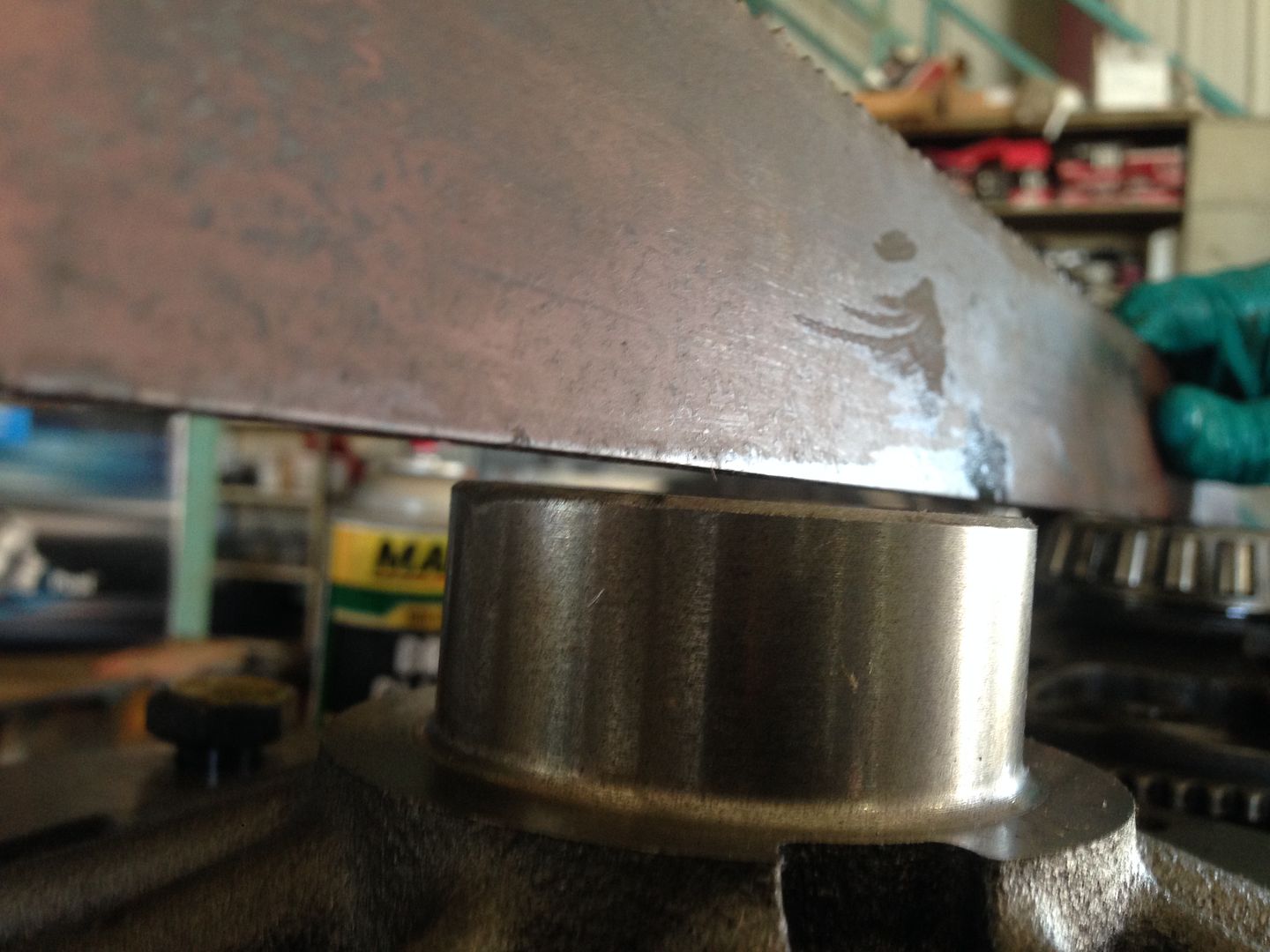

I've paid money to my local guy, and like I said dude's nice as hell but just isn't a dodge guy, so he's not much help in relaying what I'm trying to tell them. They're dead set that the carrier needs to be offset to compensate for the gears and I don't know if dude is just not telling them or not understanding himself that the housing is already made with the offset, but I'm getting nowhere...

They are wrong. That 4:56 carrier will not drop into the case with the 3:07 ring gear installed. It moves the ring gear to far to the right. The ring gear wouldn't have enough room to drop into mesh with the pinion.
Send it back and tell them to send you a carrier for a 3:54 to 4:10 gear ratio.
Remember Yukon gear does not make a 3:07 gear set. I dought if they have ever had a set in their grubby little hands.

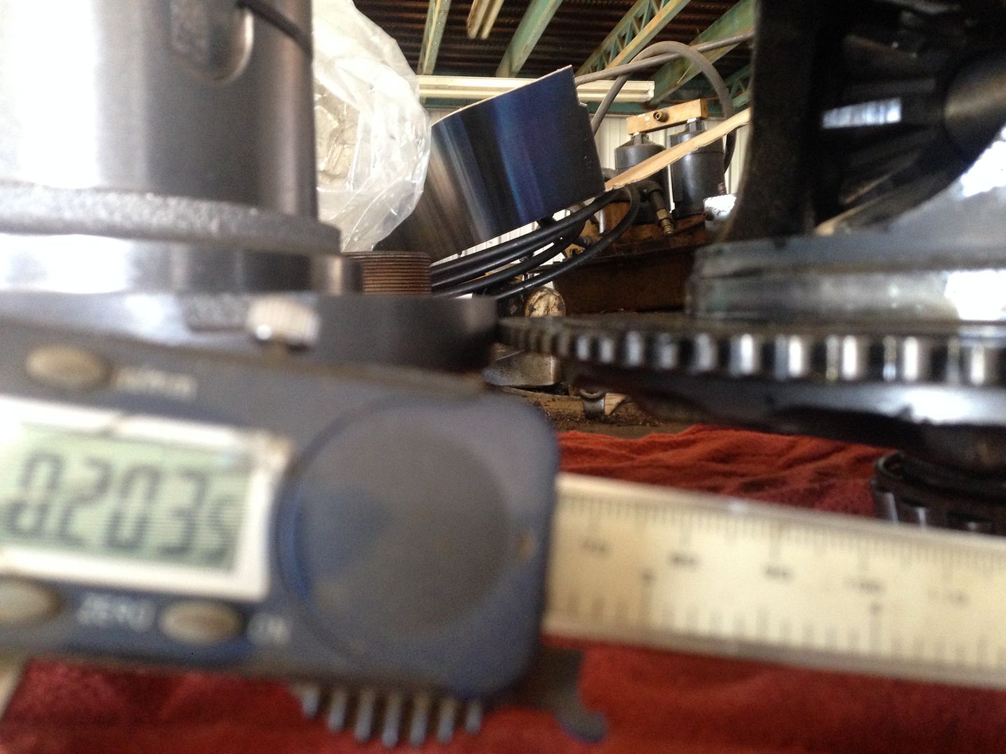

If you want a pic of a carrier that was installed in a 3:07 axle. I have one in a box ready to ship. I can unbox it and take a pic with a tape measure showing the ring gear height for the left side bearing hub.

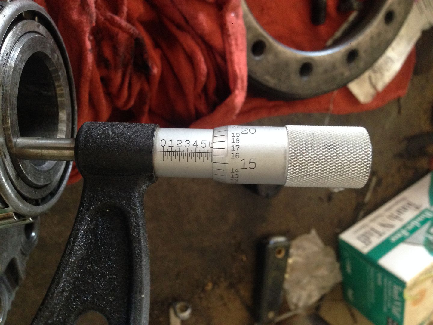

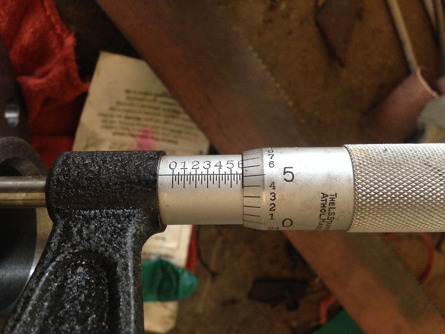

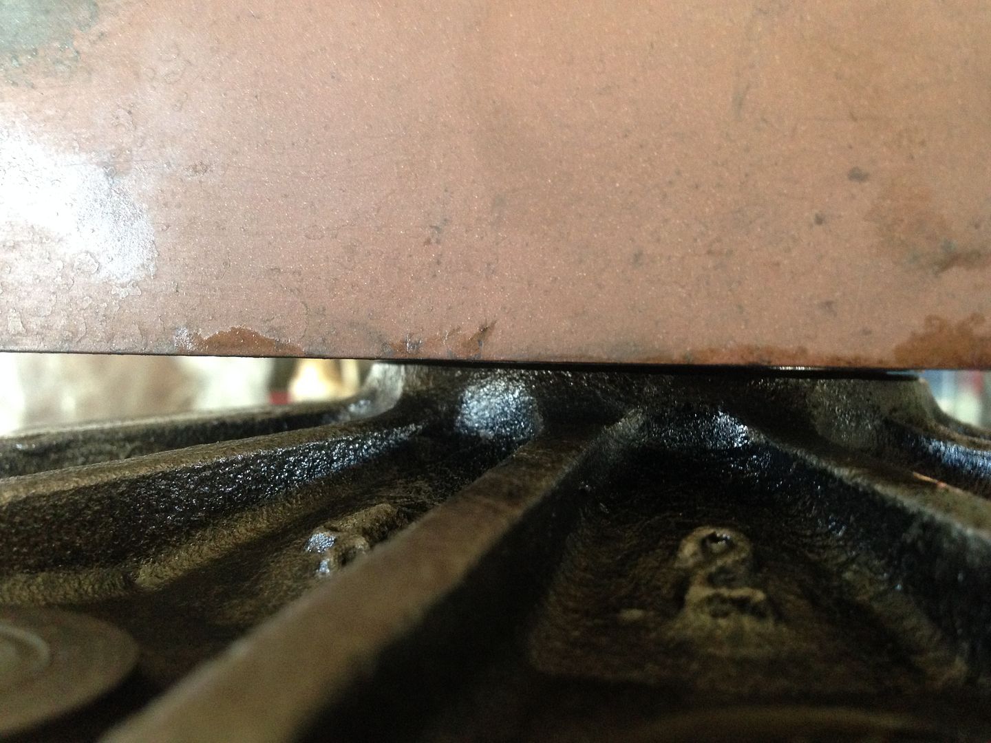

I took lots-o-pics while I had them out, no way to show them to Yukon but I assume local dude relay'd them. They still want me to try installing it. :?
Bearing seats are almost perfectly aligned, within .050" anyway.
As are overall lengths, so my measuring off the ends wouldn't cause a bad measurement.

Talked to the gear dude myself today, he insisted that not only are the housings different but the gears themselves are and I need that 4.56 Detroit. I tried explaining the housing offset like 3 times, but they were insistent that the 3.54-4.10 gears had an offset built into them as well. :?
