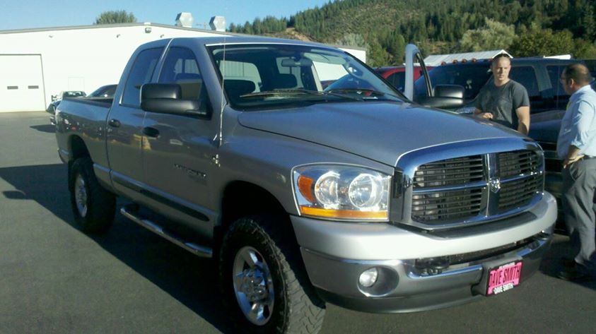

The new toy.... now real power is coming.

Nice!

Looks good Eric. Looks a bit down on power at the moment though (I'd love to tune one of those sometime)
Postby fatty » Wed Sep 10, 2014 7:03 pm
Good looking rig Eric. What's the mod list for this one?

Tranny....
Then, I'm not sure (ok I am, but we know how things are changed).... but It'll most likely see 2 stages. First being mild... custom tuning, 62fmw, and mild 30% injectors..... 2nd being 62/75 or 80, with twin or upgraded cp3 (not sure yet) and probably 75% overs.
Postby RCCUMMINS89 » Wed Sep 10, 2014 7:08 pm
This will be the FIRST truck that I have ever owned that will stay at stock height. Going for comfort, and raw stinking bad quickness. BUT I'm currently all about doing the mild, but matched set ups.
Postby DMan1198 » Wed Sep 10, 2014 7:34 pm
I'd go bigger on the injector in both stages (I'd probably say 60% for stage 1, and 100-125% for stage 2). That way you can run very low duration, and time it very carefully to get more usable, cleaner power. For cp3 go dual without question. They respond much faster, and it gives you a backup in case one fails
