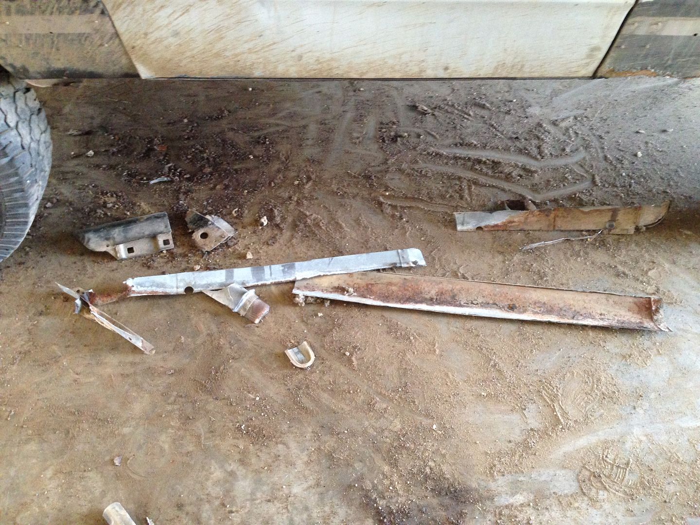

There's a lot of crap to cut out of there, it's not what I would call a fun job. :yuck:
I'm gonna run the strap up and weld another piece onto the front fender to bolt together there, it really seems to need the support down there. My front clip wiggles around like crazy with them unbolted. I'm also missing some inner fender bolts too, and the front fenders are pretty rusty, as you can see. The core support seems to be almost completely held in place by them.

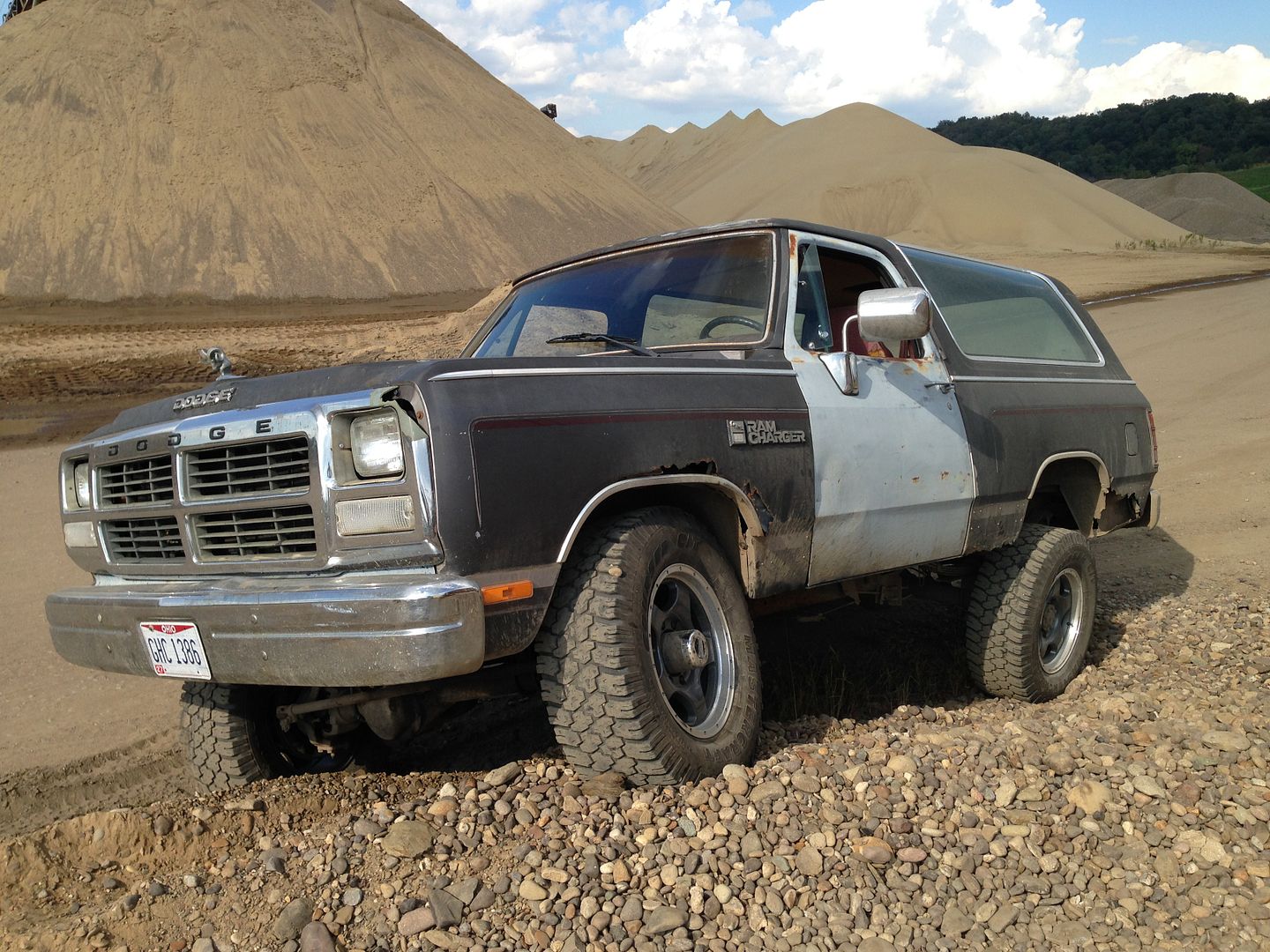

Are those tires the old at's or the ct's Levi?
They look pretty tame and mastercrafts are generally (relatively) cheap. I hate these mud tires I have now.

Courser C/T
They're loud little buggers, but not bad tires so far. I threw them on myself so they've got a decent wobble to them around 45-55 mph. Gonna buy some beads to throw in them.
Can't beat them for the price though. :mrgreen:

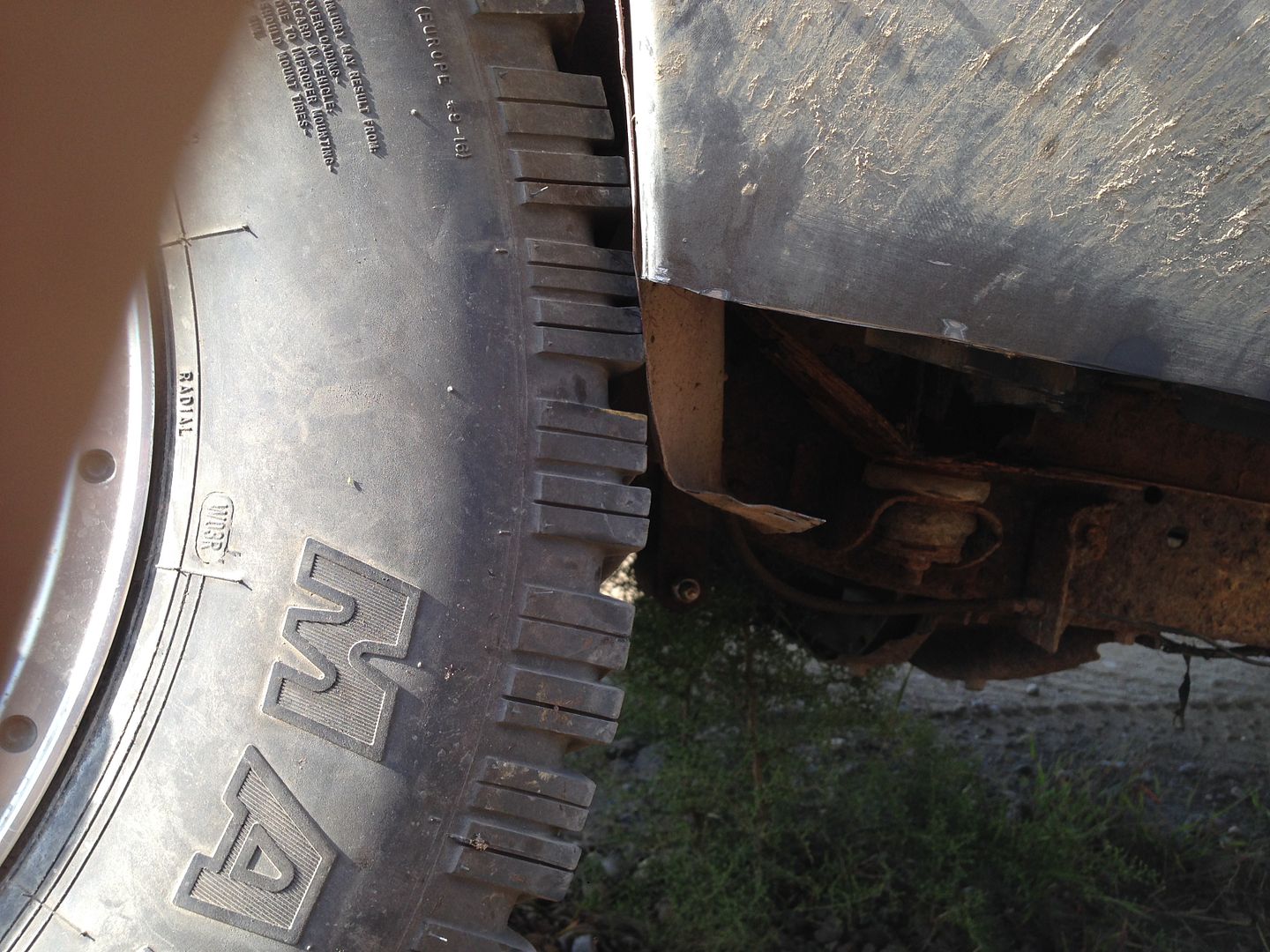

Those are Level 8 brand, Punch model, Pete. 17x8, -6 offset. They rub the draglink a little at full right, and get into the front fenders pretty bad when you twist it up. No contact besides the draglink on flat ground.
