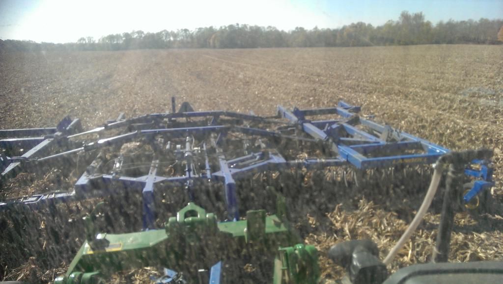

Postby cmann250 » Sat Oct 25, 2014 9:34 am
What I did at work today.

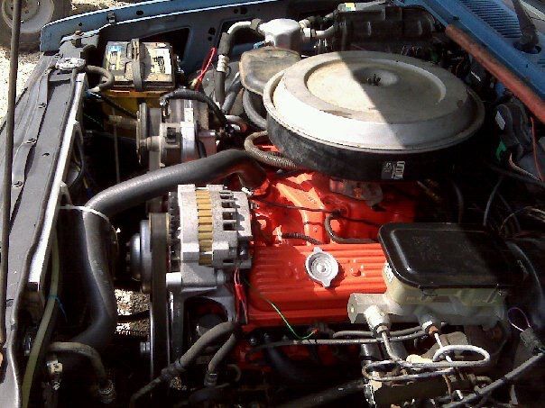

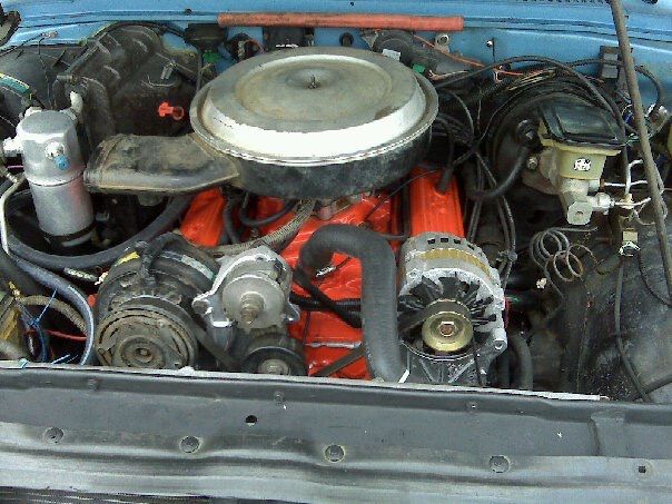

Postby ellis93 » Sat Oct 25, 2014 3:08 pm
Tbi motor with throttle body spacer and the z71 air cleaner,hood still had room to close
Look at the room with the rad recessed
That's the brackets/serp setup from a 94 z71. It doesn't look like much but it was all just crap I had laying around. After the 2.8 died at 280k I wasn't just gonna throw the truck away.
