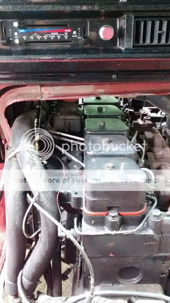

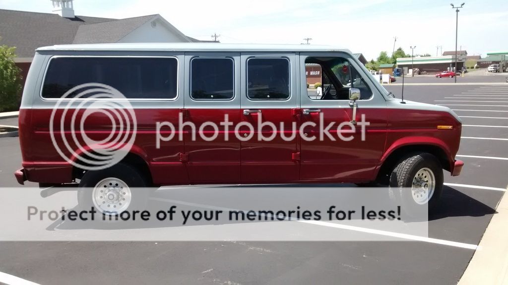

I`m 62 and retired. My vehicle is a `86 Ford 1 ton van with a 12 valve cummins. I plan on using it as a tow vehicle for a small, but heavy enclosed car trailer. It will need more power to pull the hills to my satisfaction. So, I joined this forum to have a place to turn to when I need advice. Thanks for being here. Here`s a couple of pics.

Postby RCCUMMINS89 » Tue Jun 30, 2015 1:37 pm
Welcome, and nice looking van.
Re: New here and to diesels
Postby Tacoclaw » Tue Jun 30, 2015 2:29 pm
That is clean, nice job!

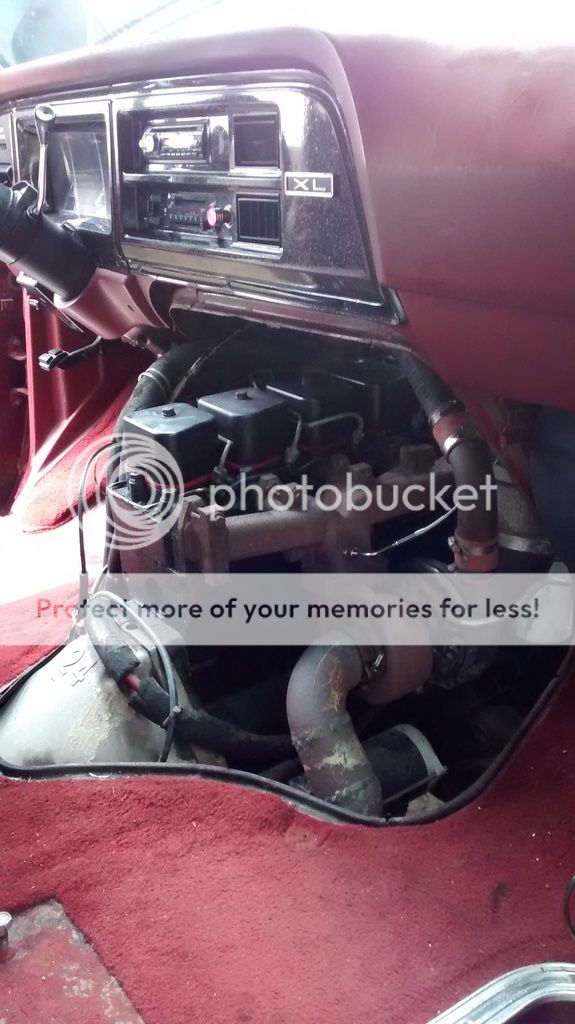

Postby RumbleFish » Tue Jun 30, 2015 7:55 pm
Interesting. So just how does a ctd fit in one of those? And welcome!
Postby thrashingcows » Tue Jun 30, 2015 9:03 pm
RumbleFish wrote:Interesting. So just how does a ctd fit in one of those? And welcome!
I was going to ask the same thing...and did you build it?

Postby bdub » Thu Jul 02, 2015 6:38 am
I bought it this way, but it didn`t run very well. The conversion was done maybe ten years ago or so. This is my first diesel and I was a little shy about working on it, so I had a local diesel guy work on it. He did several things to it including "turning it up". After getting the bill, I decided to get over my shyness and go ahead and own this thing.

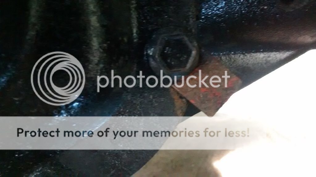

Postby ellis93 » Thu Jul 02, 2015 11:15 am
Given its a ford there should be a tag on the diff cover attached by a bolt. If you can,take a pic of the tag and we'll be able to tell you the ratio.

Postby bdub » Tue Jul 07, 2015 1:56 pm
I took a pic of that tag on the rear end, but all I can tell is it was red. I took a couple of extra pics to give some sort of reference as to how the 12v sits in the van.

Postby ellis93 » Tue Jul 07, 2015 6:37 pm
Yeah that's a no go on the tag.....to get the ratio you'll have to pop the cover off and turn the ring gear. It should be stamped on it.
