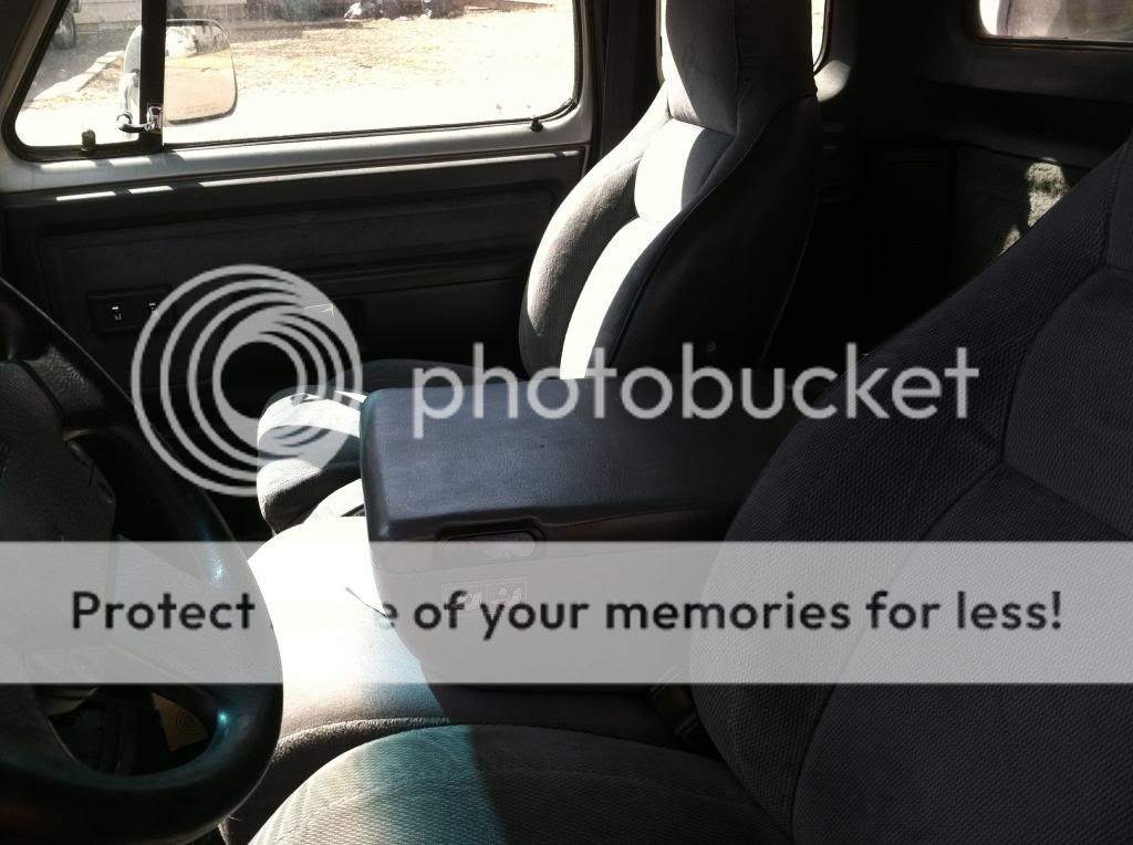

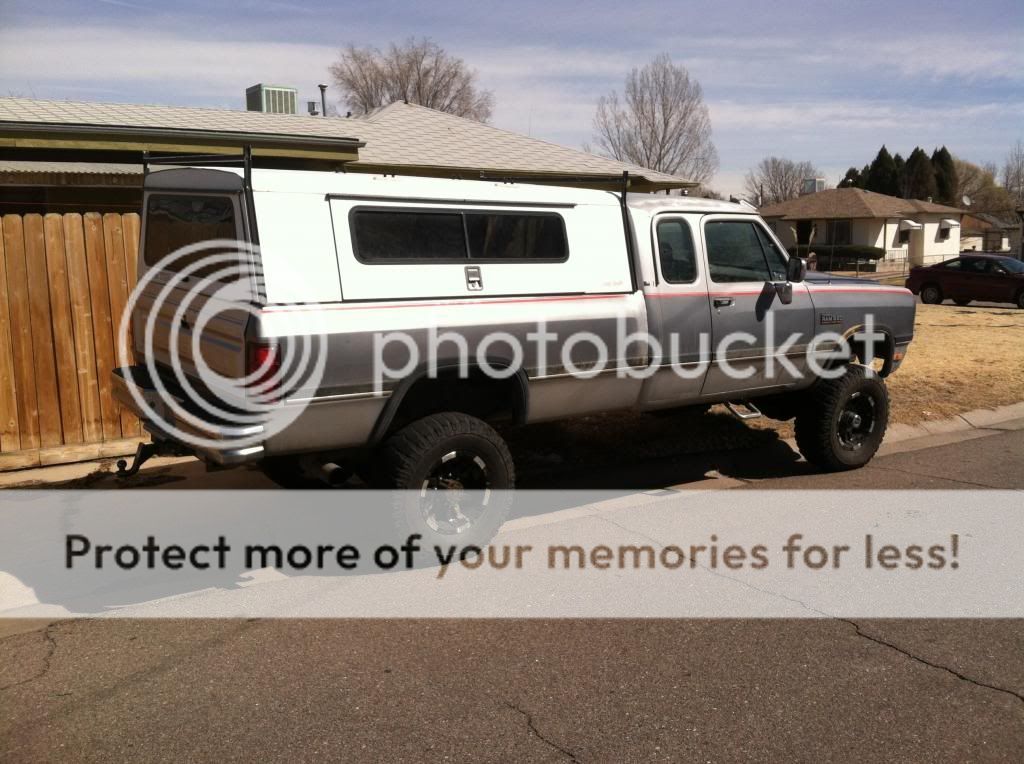

Re: New to 1stgen. 93 auto to nv4500 swap
Postby CumminsPower59 » Tue Mar 26, 2013 10:54 am
Very nice ride! Looks really rot free!!!
Yes, 16.5's suck, but there is one thing that is an advantage here. If the stock Humvee wheels are used ,i.e., Hutchinson D.O.T. legal beadlocks, the tires don't slip on the wheel because of one unique factor...the tire is actually sandwitched between the internal beadlock/runflat device and the two half's of the wheel. One thing is for certain though, you get a nail or a leak on one, getting that rubber beadlock/runflat out is a HUGE pain in the arse. It has to be compressed and then bent up like a banana, and forced out of the tire. Now, if you could get a set from Hutchinson that are beadlock only (no runflat part), those are pretty easy to change out...compared to the other style ;)
Postby oldestof11 » Tue Mar 26, 2013 1:55 pm
Welcome!
Looks awesome!
Postby Stoner93 » Tue Mar 26, 2013 4:04 pm
Yeah there isn't any rust on it I bought it from the original owner three years ago with no mods at all only had and extra 30 gal fuel tank where the spare tire goes. Normal sun damage on the top and clear is gone very clean interior.
