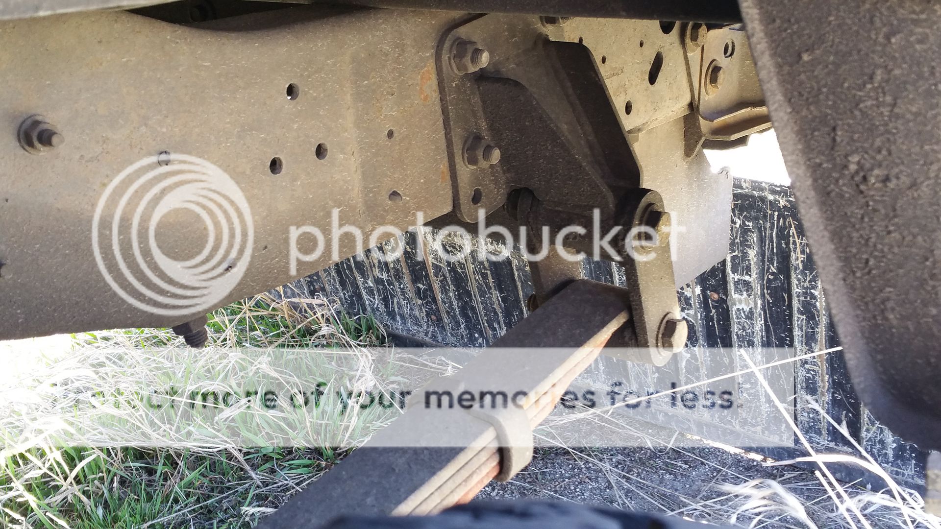

Got a question for you in regards to the rear shackle flip...How well did the truck sit after the flip versus before? I'm guessing that you removed the factory 5" lift block, but did you lower the forward rear spring mount?

I took out the block and put in the shackle flip after I destroyed my original Dana 70. I replaced it with a Dana 80 (recently passed on) and couldn't use the blocks. The flip raised it to its original height and took the edge off the rough ride. I would definitely recommend it. I didn't touch the forward mount, but I will when I put on longer springs one day, front and rear. I bought a kit from a guy on the Ramcharger forum.Image
