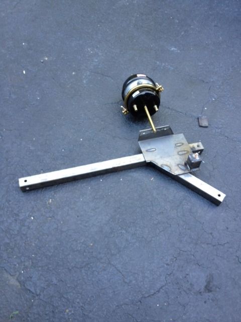

Hey all, despite not being done painting my cab, my bed needing to be sanded, and my flamethrower only partially hooked up, I have decided to put another project in the works. I probably won't get to fabbing anything until tomorrow night or sunday.
I'm adding an airbrake as my parking brake. Really no other reason then I think it would be cool to pull up to a fuel station and get that Psssssssss when I set the brake. I'm using a real deal can with all mechanical linkage that uses my highangle driveline brake to keep her from rolling. I just wanted to start this thread now and plan to update with pictures tomorrow or sunday.
Here's my brake.

I know a Case W26 wheel loader has an air brake on the driveline. Thought about adding one myself a time or 2. Would work great.

I'd use a different clevis though. I'd have one that is longer, to allow more adjustability. No real need for a clevis for an auto-slack either. What size brake chamber? Almost looks like a 30/30. Plenty of over kill. :lol:

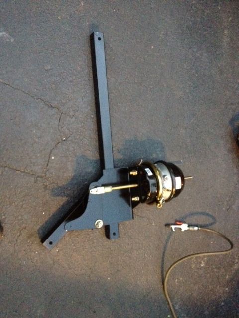

Correct, I think it's a 30/30. In any case definitely is overkill and then some. I got it mounted tonight but no time to get pictures of it under the truck because I ran out of light. I made a crossmember that mounts behind my trans case and puts the airbrake on the inside driver side frame rail. It goes on with three half inch bolts. The geometry on my pivot arm took some prototyping in cardboard to get it all figured out. But tomorrow I hope to either mount my switch or atleast fab the last connection between my brake L arm and trans case brake.
Here's a video of me running it on shop air

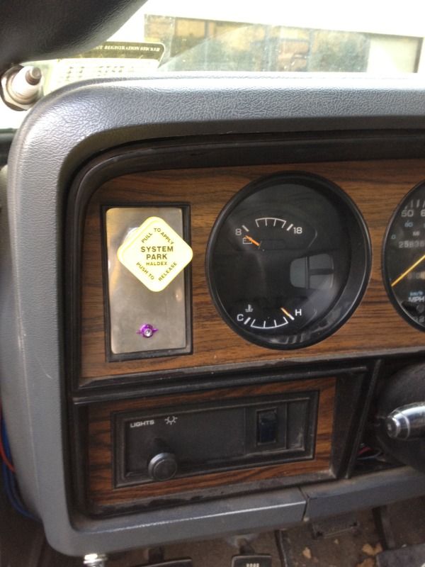

Thanks, so far I'm happy with how things are coming along. Today I mounted my valve. So I'm just waiting now on my tank and fittings to hook everything up. I have a flashing warning light and a buzzer that will be my low air pressure alarm. Tomorrow I'm hoping to get my last piece of linkage fabbed up from the airbrake to the driveline brake.
I had to sacrifice an AC vent but I think it's cleaner than trying to cobble a mount together somewhere else.

Is that a spare glowplug for your Cummins? :lol:
Do you have a cargo light switch? You could put it there, or where that green switch is by the light switch. I put my fuel pressure gauge next to the light switch. Worked out good.
Re: Airbrake
Postby Burritoboi5 » Mon Sep 17, 2012 8:15 pm
Haha that's an anti rattle device for my gauge pod. I do have a cargo light and my strobes take up the spot where my OD switch was before I swapped the nv4500. I'm pretty happy with where it is though.

Here's the setup all done! It sounds pretty good as long as the idiot taking the video doesn't keep his phone in the cab, my mistake.
I can get more pictures of the workings underneath if anyone is interested.
