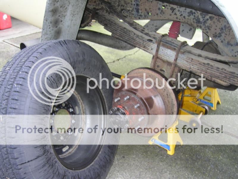

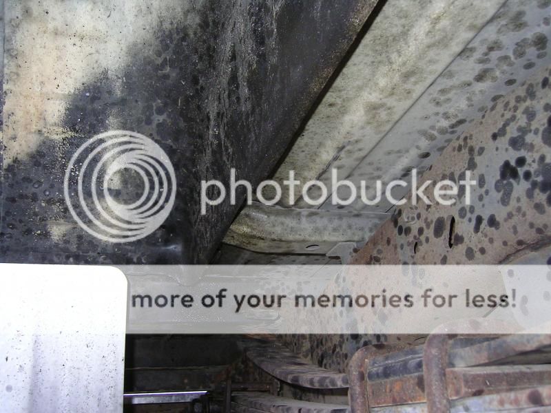

Well i redid the rear brake hubs a few weeks ago, new bearings and seals, but yesterday on my first day off in about a week I noticed that there was gear oil on the ground by the passenger side rear tire....Doooh!
So today I tore into it to see how bad it was....
All that oil everywhere...that can't be good.
