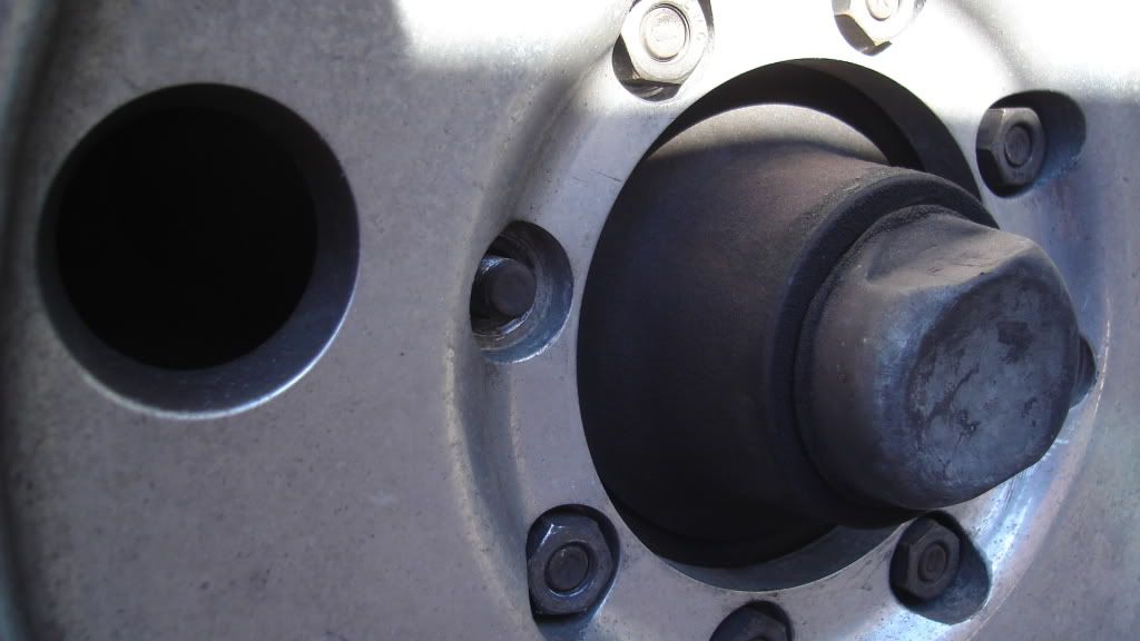

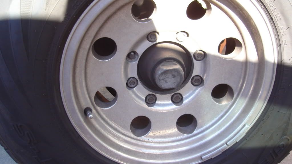

Postby Begle1 » Sun Jul 01, 2012 10:47 am
Stock studs with what I think are Ford wheels. (?)
Where can I get the PROPER lugnuts (and studs?) for this application?

A coned seat for the nut? I'd rather see a few threads out past the end of the stud as well.

Ford used 9/16" studs with those wheels. They used the same lug nuts on both steel and aluminum rims, as far as I know

Old Body Style as in '92-'97. Tell a parts store '95
After a little search, I doubt you'll be able to find 9/16" studs for the front. They are different than the rear. I'd just get a longer 1/2" stud and the proper nut

9/16 studs Part # 641-2794 at Napa/Balkamp brand, Part # 610-283 at Carquest/Doorman brand.

Dorman PN 610-283 will work perfectly. They can be had anywhere that has Dorman products.
I used 610-282's, they are a bit short, but work well. I also used 2nd gen lug nuts, as I had them laying around.
And IIRC, those aren't Ford wheels, they are Eagle's. The holes are much smaller on Ford wheels, and if you look on the back side, it will say American Eagle Wheel somewhere ;)

Begle, just run a tapered seat "extended" chrome lugnut.
By your pics, you have plenty of thread engagement there to keep the wheels from disappearing on you.
Just be sure to check them within 10, 30 and 50 mile increments, then at least once a month after.
Usually after 2 or 3 snug downs, they are not going to creep any more.

So the consensus here is conical seats, extended thread for enough engagement? How do I know if I should buy the 45 or 60 degree conical seats? Having a two-piece nut wouldn't help matters?
