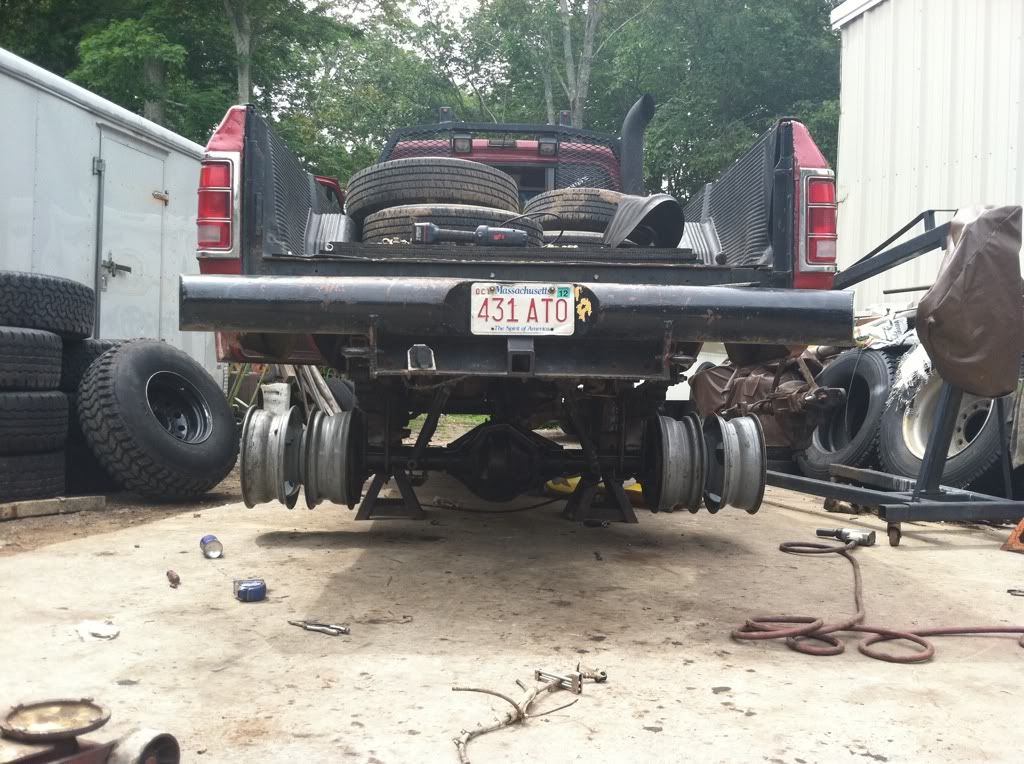

welp, lots more work done.
got the d80 in today, really easy swap.
hardest part was getting the 4inch 2ndgen blocks centered on the spring perches, both blocks had the lower centering pins sheared off... ened up getting them centered then welding them on, gives me some piece of mind that they wont move.
then came the issue of where to mount the shocks. I ended up drilling a 1/2 inch hole in the bumpstop castings on the blocks and used some shock mount studs I had laying around, that came out good as well.
mounted the swaybar backwards for huh? and giggles... made a huge difference, much more secure in corners just blasting around on backroads.
threw dually rims on just for kicks, they extend 2 inches out past the body lines
got the 3.54 d60 front sitting waiting to go in, think ill do that on monday.
how she sits now...
all in all it came out swell, brakes feel much better as well :grin:

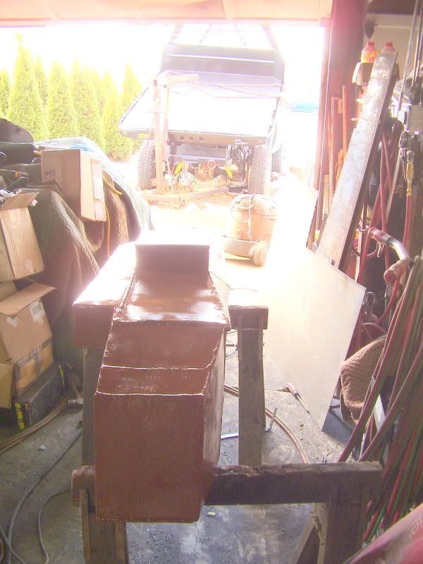

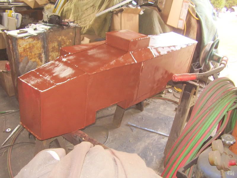

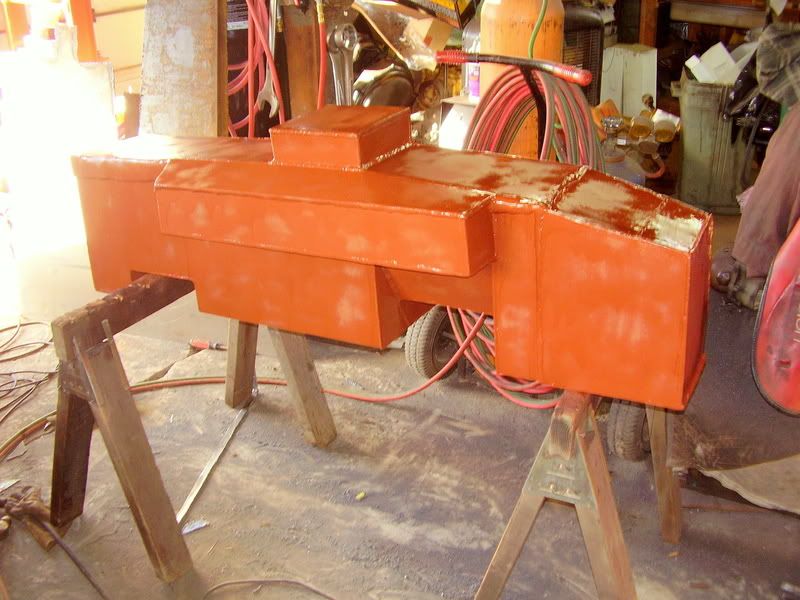

I am on RCCC i think lol...mummn I wonder where I could find the 3/4" grease bolts and 3/4" poly bushings?... I definately want greaseable pins and bolts.. the stock rot and crack is not what i want...argh.. I don't have the stock gas tank in my truck i made this one a few years ago.
Its made from plate and hads a sump with trap doors etc.. running big synflex etc
