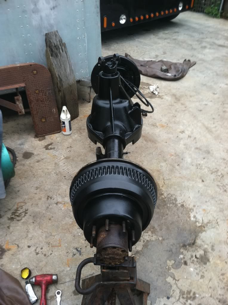

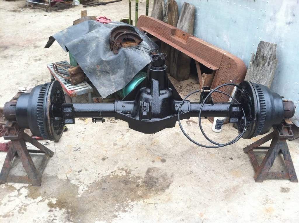

what should the wheel mounting flange-to-flange distance be (roughly) on this d80 (if its a dually)... i measured it today and THOUGHT i got about 68 inches flange-to-flange. ( i may have had a brain fart im going to measure again), tag on the diff definently says 3.54
i was just reading somewhere else that it should be something like 72 inches? wtf? did i get screwed? i was told it was a dually axle and by all other pictures ive seen it looks like one... backing plates are set way back to accomidate the dually rims... am i wrong?
here are some pics, im hoping its a dually...
all rebuilt cleaned and painted btw :grin: , drums, shoes, cables, seals, spring kits ect ect....

Re: best D80 dually axle?
Postby Mark Nixon » Tue Jul 26, 2011 7:13 pm
That appears to be a Cab and Chassis DRW axle, Alex.
It definitely has the DRW drums on it, they are unmistakable.
Postby ahale2772 » Tue Jul 26, 2011 7:30 pm
Argh, I though it might be, that kinda blows.... Should have checked
Thanks Mark
