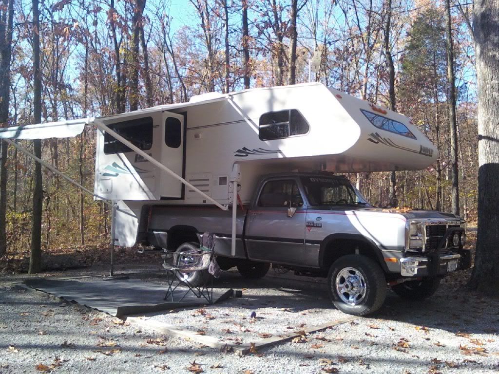

Postby 1STGENFARMBOY » Tue May 17, 2011 2:27 pm
Here is a couple pics.
with the SRW bed
and the dually bed
i have let the preshure down to 50psi i'm gona drive it and see if that helps unloaded, i know
i can't leave them down loaded.
Dar
