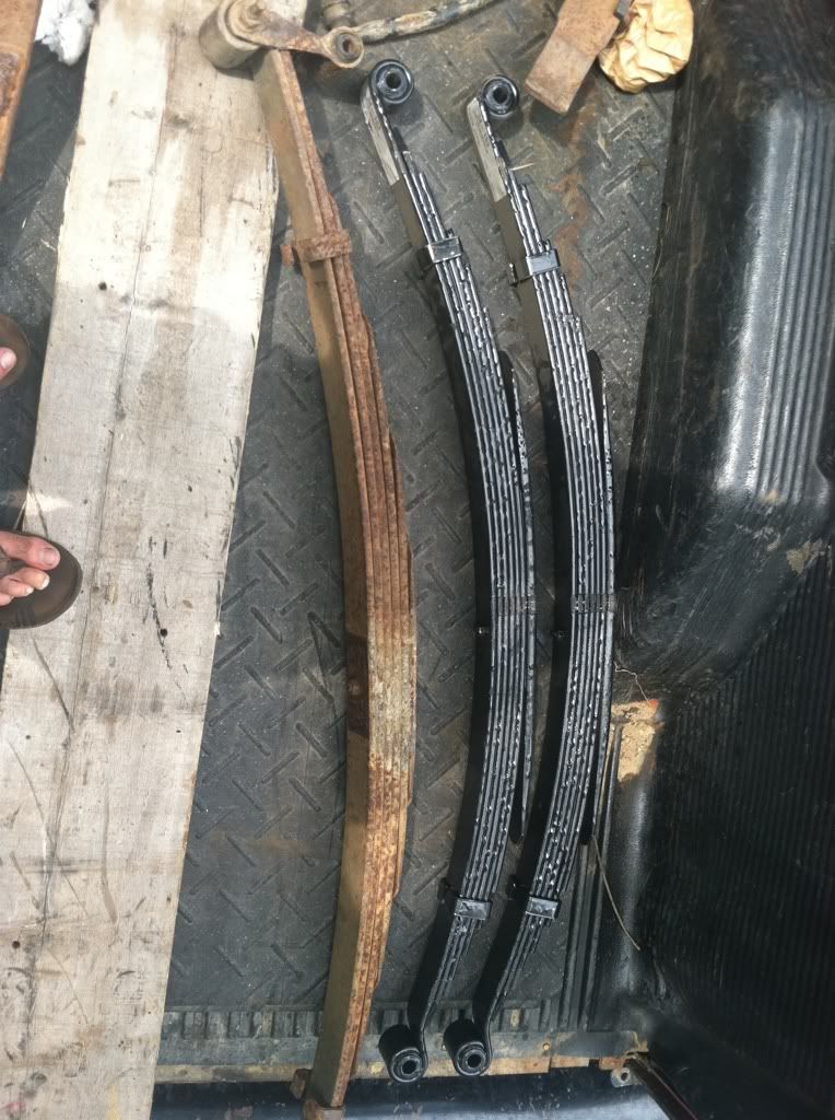

I was going to try to use the 2nd gen springs but i found out that they are about 8-9 inches too long and are 3 inch wide rather than 2.5 inch. they are also a bit thicker and measure just under 3/8 ( i still would have used them if I could but 4 inches longer on each end places hangers in weird spots)
also, the d80 perches have a hole that measures more like 5/8-3/4 for the center pin (after rust, wish i knew what they were new)
the block that were on it were about 6 inches tall.
springs:

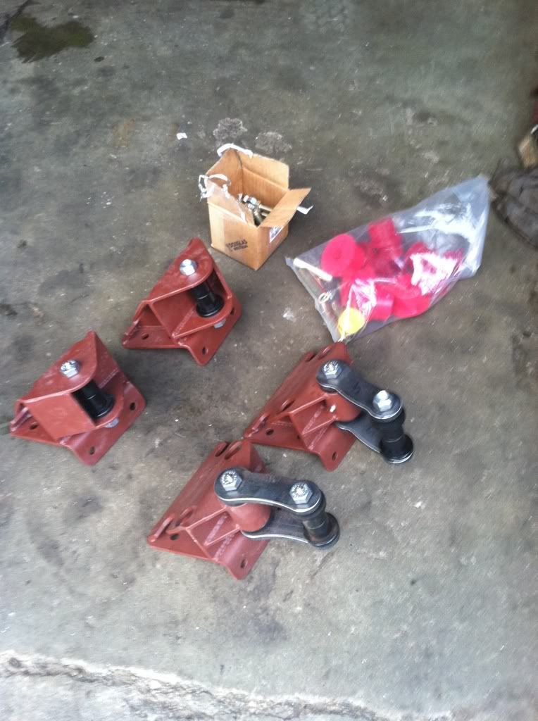

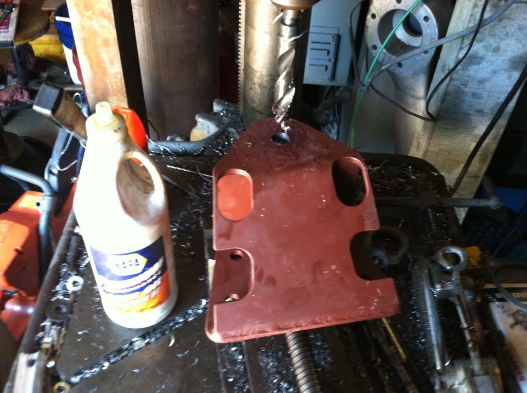

ill be using a new set of 1ton 1stgen springs, 7 leafs, 3/4 eye bolts.
I bought hangers/ bushings and shackles from "jungle" on ram charger central, the kit came to 520$ shipped, they are super high qualiy and look professionally made.
the downfall is that they are not really interchangable with firstgen CTD stuff at all...
bushings are different (5/8 bolts and 1.5 inch OD bushings), they are not made to bolt to stock locaions, hence you will have to drill new holes.
hoping to get some done on sunday, also have dually hubs coming for the front and im hoping to do 19.5's too.

Yep, 170 for stock 1ton with 3/4 eyes, the hd pack was 290 per spring and I was told adding leafs to the stock 1 ton packs I bought would bring the price per spring up to like 260 per
Re: d80 swap/ spring overhaul
Postby ahale2772 » Fri Jul 29, 2011 6:11 am
I would not have bought new if the packs on my truck now wernt TOAST :(

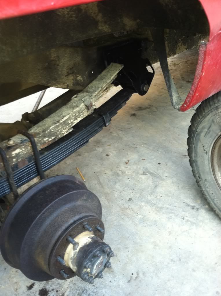

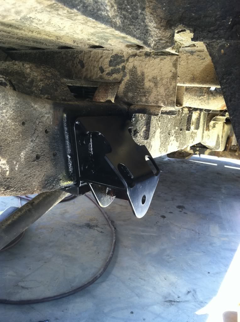

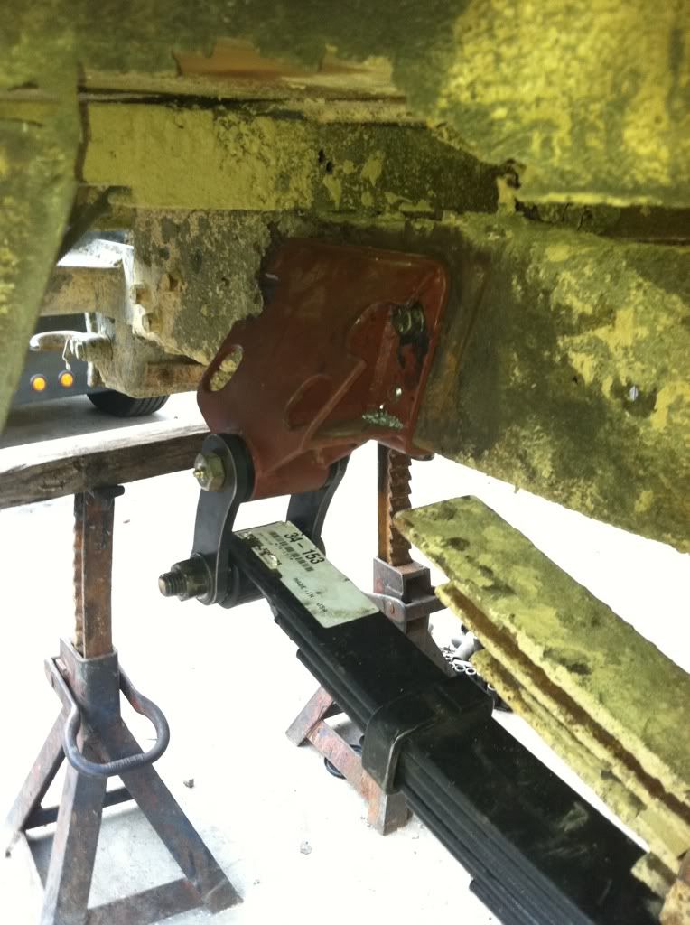

Postby ahale2772 » Sun Jul 31, 2011 6:26 am

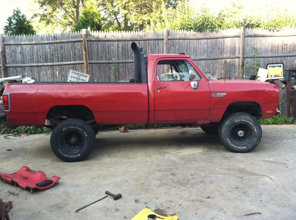

well... got the springs and hangers on yesterday, they came out good, after lots of work. the old hangers came off good, rears were bolted thankfully and the fronts i used the gasaxe on. once i got them off i realized the main/rear fuel tank hanger was going to give me trouble. the bottom lip of the crossmember wraps around the bottom of the frame where the brackets need to mount. I had to grind off the two lower rivits on that mount, pry it down and mount the front hanger there, today i'll re-drill that gas tank bracket and bolt it back up.
other than that it was just drilling and bolting, I used the hole in the frame where the front bracket bolt slides through to get my alignment for the front brackets. on the rears i just assembled the springs and put weight on the shackles till they gave me a good angle, then made sure both sides were the same and bolted
I did not throw the d80 in yet, ill do that once i finish making brake lines for it and get lugnuts in from Mark. the hard part is done for now, the d80 swap will be a cake walk now.
some pics, yes the truck is filthy and rotted underneath, and undrcoated with animal fat sludge from he previous owner (works wonders for perserving the frame)
....and yeah pete i did all this with my hippie toes hanging out of my sandles :lol:
the front hanger:
the right rear, still need to finish bolting
had to bolt up the old overloads just so i could reuse the old u-bolts FOR NOW, when I put the d80 in I will get all new purdy stuff.

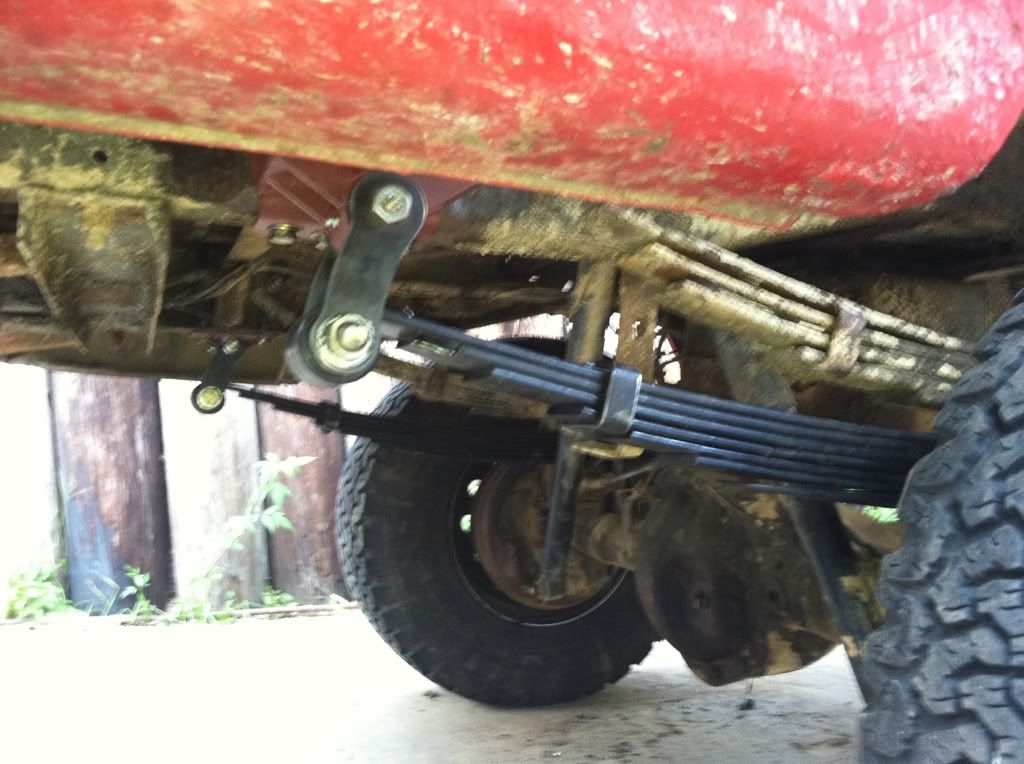

shackle angle, after every thing was bolted back up, with the truck sittin on its own.
she sits about 1.5 inches higher than she did before, took out one 3 inch block and the hangers raise the truck 4.5 inches....so that makes sence
had to drill out the front hangers and lower boltholeson the rear shackles to acomidate the 3/4 hols for the 1ton springs
more to come...
