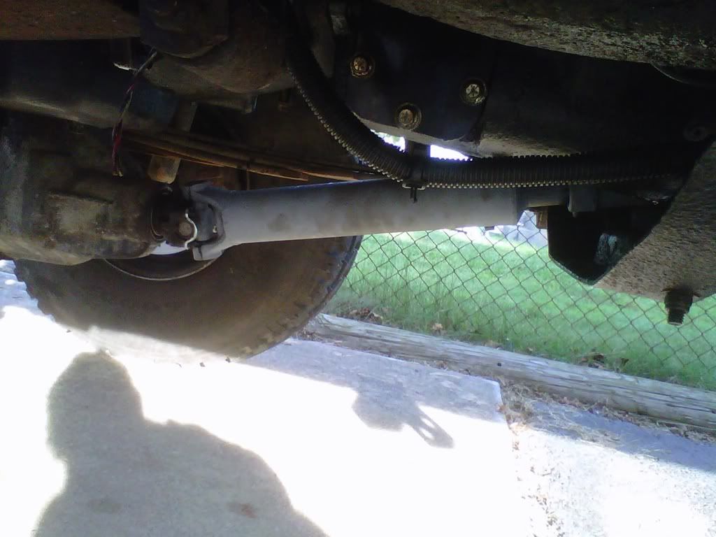

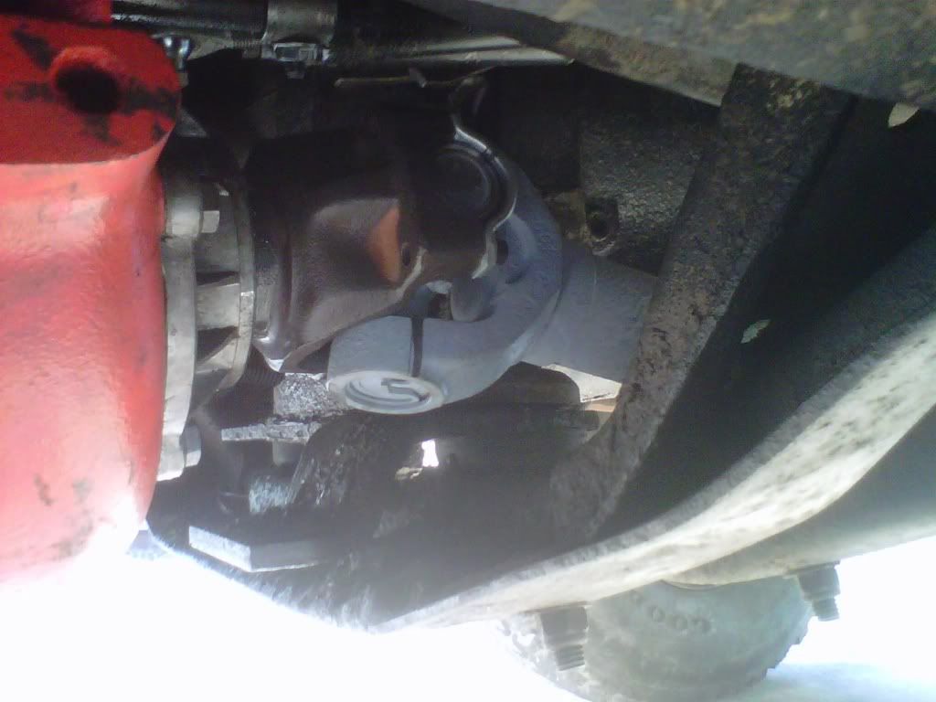

Postby ahale2772 » Mon Oct 24, 2011 6:05 am
made one!
32 spline 1410 yoke from the rear output of an np205 (you will need the larger rear output seal), 1410 yoke from a d70 on the pinion of the d60
cut a stock rear driveshaft down (i can get a measurement if anyone needs it) got her straight on the lathe and welded her up.
clearance is very good, lifted the front of the truck and let the trcuk sag, got about 6 inches before the greese fitting on the slipjoint threatned to hit the transmission crossmember.
drove around in front wheel drive, didnt feel any vibrations up to about 40mph
VERY WEIRD how the truck drives in FWD
