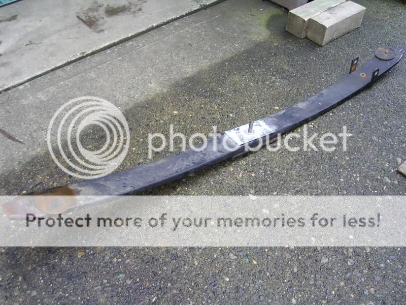

So first I had to pull apart an old set of rear springs and find two leafs that would be 34" long and allow an even 17" on each side of the center hole. Think it was the 3rd leaf up from the bottom.
One side already had a hole for the spring clamp and was 17", the other required about 3" to be cut off. Then I had to tapper the tip.
I then went down to the shop that sold me the Smooth Ride springs...they are local....and picked up some new wear tips and spring clamps.
The rubbers that came with the new spring clamps would not work with their style, so i used some neoprene sheet I had to cut out some new ones that would.
Then I had to drill three 1/2" holes in each spring. One for the wear tip, and two for the new spring clamps to lock into. I positioned the spring clamps 6" back from the wear tips.

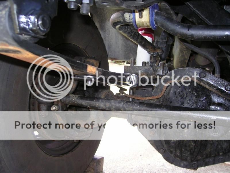

First was to get the sway bar end links off, and the shocks as well. Then remove the U-bolts. Once all the was off I could start to jack up the truck to give me enough clearance to loosen the retaining bolt in the center of the spring pack and remove the lower spring.
Ready to remove lower spring.

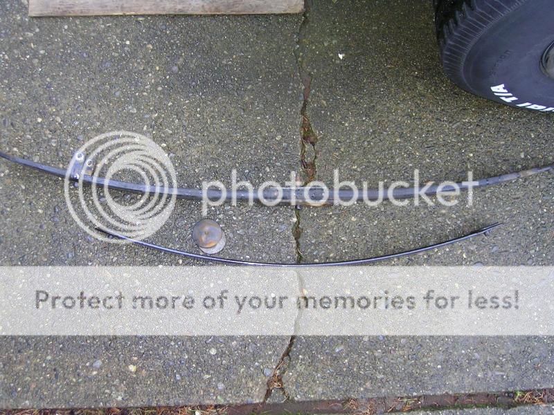

Here is a comparison of the second spring in this smooth ride set-up, and the new one that is going in.
Of the 3 wear tips on the lower springs only one was still in place and secure. The others had broken loose.

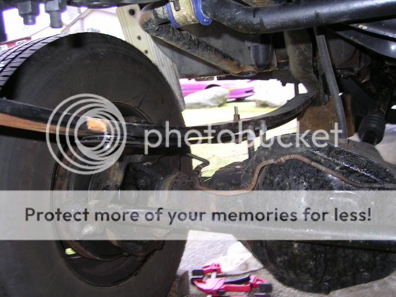

Transferred the two plates from the original pack to the new spring and installed. Required a couple clamps to compress the spring so I could get the threads started on the center bolt. Then it was just snug everything up and make sure all the plates and springs stayed in alignment.
Then once both side were done I had to lower the truck back down and get everything to line up. Had to go back and forth taking a few inches out of each side to slowly lower it back down. Once the weight was on the springs I installed the spring clamps. Then finished re-installing everything. Only had to cut about 3/4" to 1" off the U-bolts to make up for the difference in spring pack thickness.
All done and ready to go.
