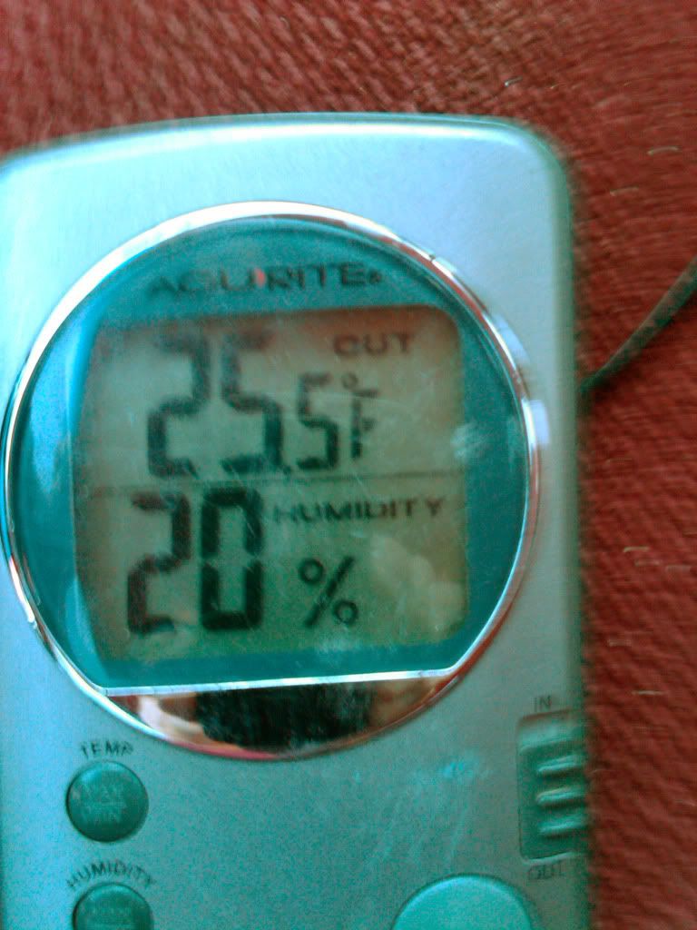

Postby mhuppertz » Thu Jul 29, 2010 3:40 pm
Here is proof!

Postby dpuckett » Sun Aug 01, 2010 7:47 pm
20% humidity- I'm SOOOOOO jealous. I havent seen that since, well, probably the last time I was in CO.
