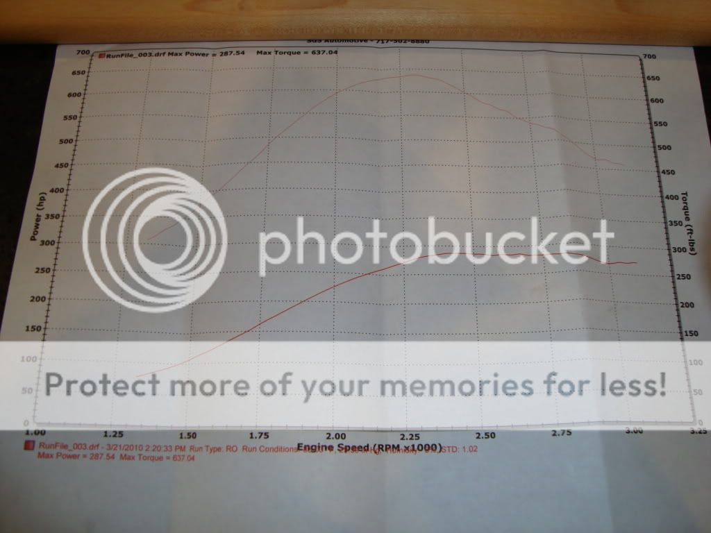

Postby 1bad93 » Thu May 31, 2012 6:59 pm
my old numbers from the last time i dynoed(about three years ago).at the time was hx35/40 hybrid, pod injectors, metal collar still intacked on the pump,timing to the head,sb clutch.
287 hp
637ftlbs
