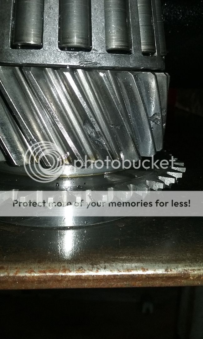

So I got my trans back. Top cover was good, input shaft was toast, pitting and chunks of teeth gone. New input, new syncros, new bearings....more than I wanted to spend but glad its done. I have some pictures but photobucket isnt cooperating so Ill have to try again later maybe.
Parts rig had a stock 13" Sachs clutch. The pilot bushing is so wore out and sloppy its no wonder why the input was trashed in a trans that otherwise looked pretty good overall.

This is the old input shaft : Image
