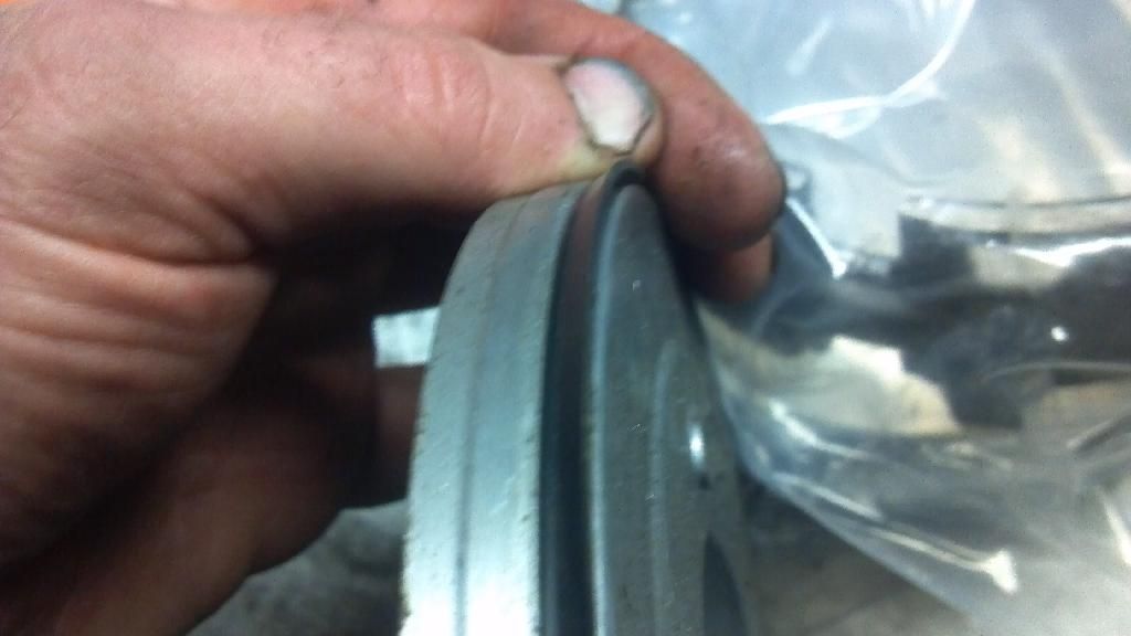

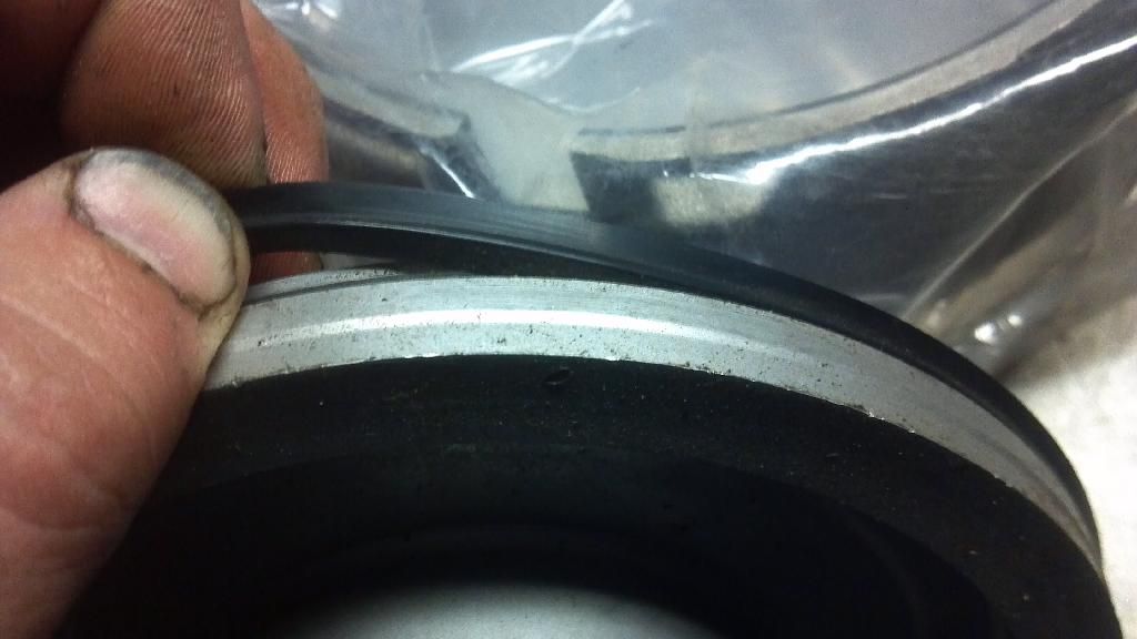

All lip seals point inward.....like what you've seen in your rear clutch. The fluid pushes the lips out and the lips hold the fluid behind the piston.
Re: The time has come. New trans time.
Postby ellis93 » Thu Feb 20, 2014 4:07 pm
Postby cmann250 » Thu Feb 20, 2014 4:45 pm
Alright thanks Ellis 8)
I put them that way after seeing them pointing in on the rear clutch. I have the front and rear packs together and on the input. Moving on into the case.
