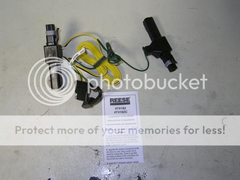

I used the Reese 74182 adapter to tie into the factory taillight harness....this gave me a 4 pin light connector plug.

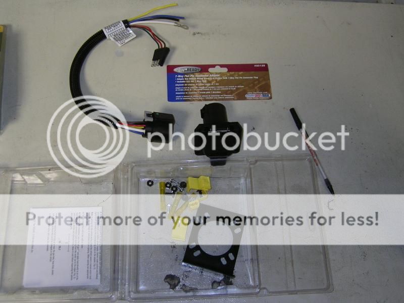

Then I bought a Tow Right 20125 - 7 pin trailer plug. This has a 4 pin plug in adapter for the lights, then you just need to run the white wire to ground, and then run the blue wire to the under dash brake controller, and the black wire to a 30amp circuit breaker off the battery. I think that is how the wiring went. The yellow is for reverse lights on the trailer...I didn't use that one.
I did it this way so I did not have to cut into any of my original wiring. Works great!
