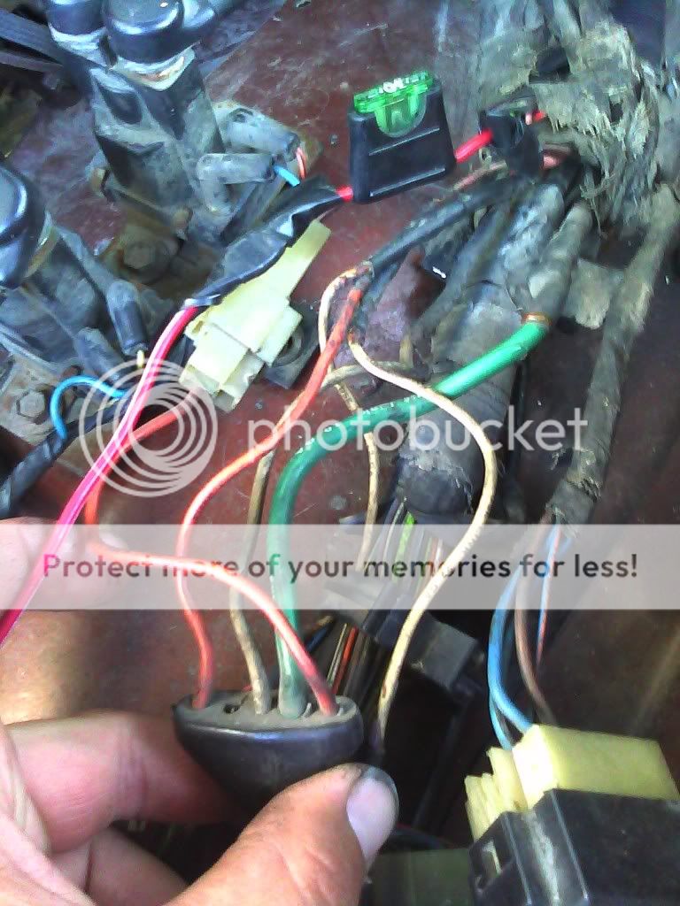

Postby Tacoclaw » Tue Oct 25, 2011 12:17 pm
Alright, here's a pic of the duckbill, of the two missing out of mine it's the smaller wire on the left:
And, on my 1990 W250(your truck *may* have different colors) it goes to this wire. This red wire, the one pulled out and with a knife pointing at it towards the edge, goes into the drivers side of the firewall bulkhead:
This is the battery hot that goes to your keyswitch, and looks to be your problem.

Postby Tsbourne09 » Tue Oct 25, 2011 12:57 pm
This is so frustrating. None of the orange wires run to 2 wires... I will put pics on my photobucket in a sec

Postby Tsbourne09 » Tue Oct 25, 2011 1:03 pm
Ok my pics are on photobucket links in my signature
