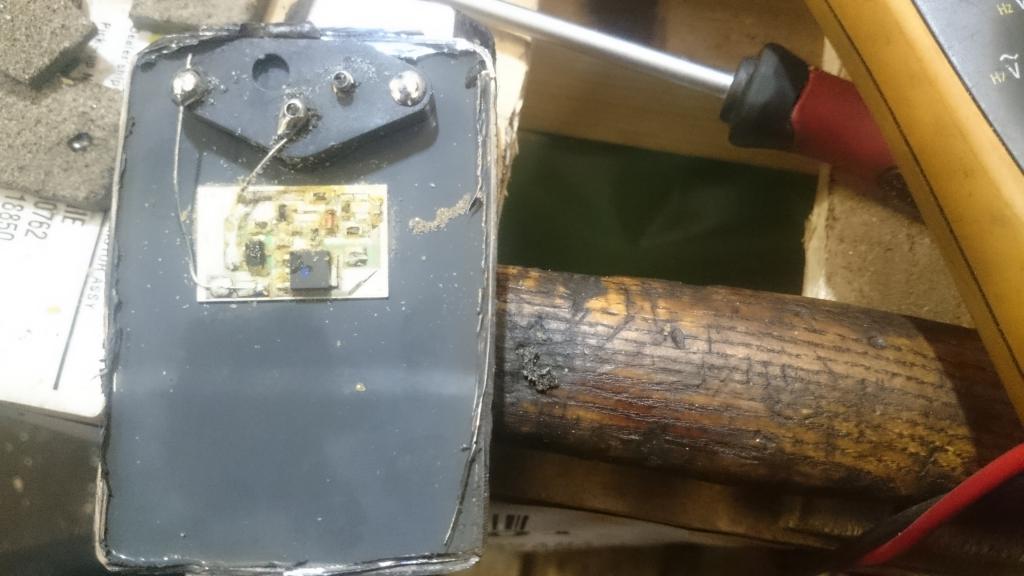

Last week it destroyed two vr, both https://www.rockauto.com/en/moreinfo.ph ... 93&jsn=415.
I had dark moment and I took some therapy with angle grinder to find out what is inside of vr.
That black stuff on back was about 5mm thick an rest of the space was filled with sand.
Electrical components are quite small.

The sand must be a combination heat sink to keep it cool and a shock absorber. Thanks for opening that up, I never would have guessed what was in there!

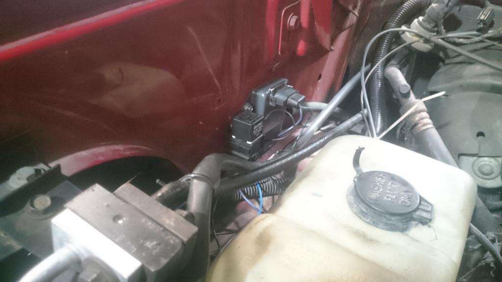

And today I relayed the vr.
I feel so stupid to wait this long before doing it.
Running 45mph small roads from work to home volts were 14,5-14,8.
Amp meter readings kind of makes sense and lights does not flicker, they dim slightly on idle though.

Postby PToombs » Tue Mar 15, 2016 3:46 pm
Good looking job!
