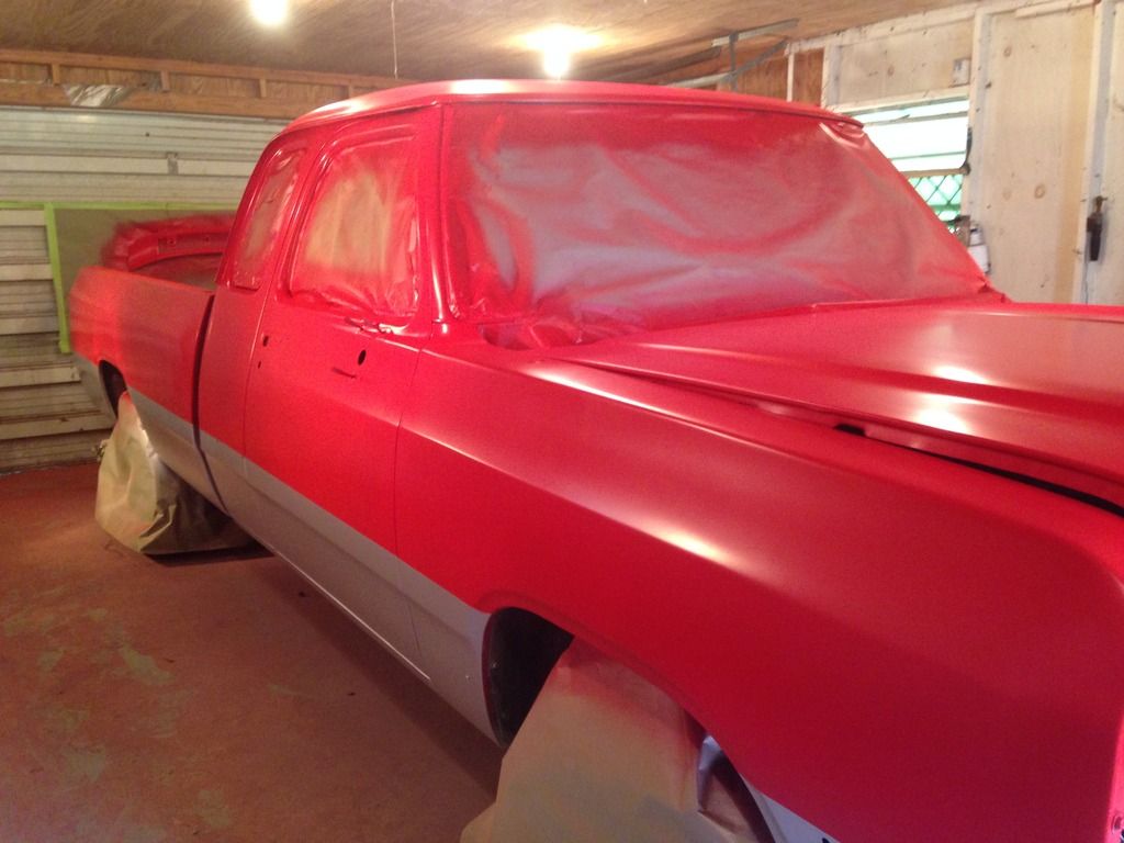

Well.....everything was going well. All was looking good. Got the silver base on,taped it off,sprayed the red,untapped it and started on the clear coat.
Clear

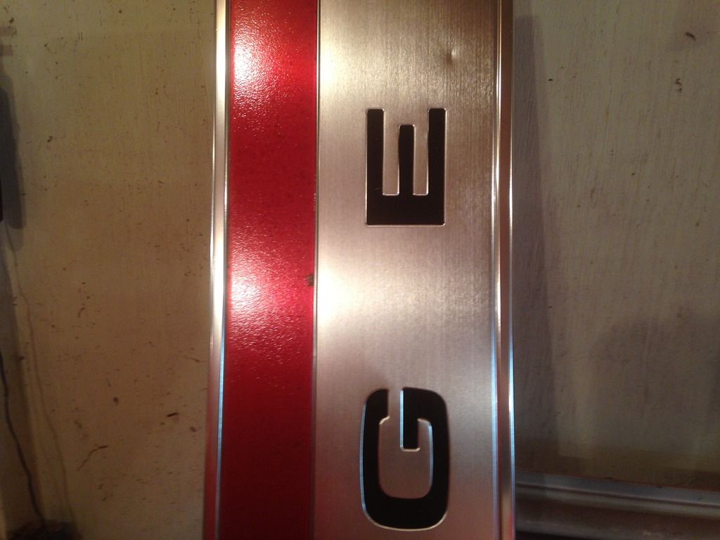

Even sprayed the tail gate banner thinger with the clear
Nice and shiny
And I was like yeah.....this is gonna look real nice
Then....the the turn for the worse. It gave me the finger.....
Talk about being pissed like I've never been before,I actually felt myself turning green and swelling.
The application of the second coat of clear caused this. I don't have a clue why.

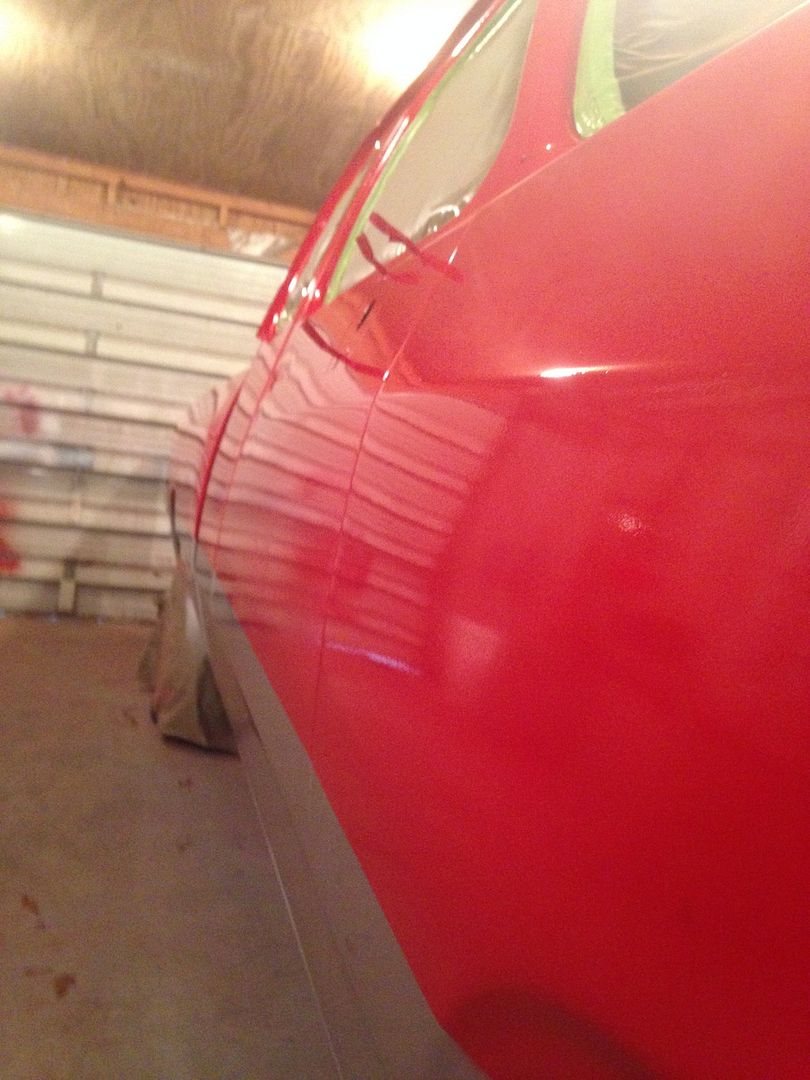

Got up at 4 this morning and readied myself for battle. Got to the little sheid around 5 and tacked off the dodge,mixed up some clear and got to spraying.
Looks damn good!
Of course.....I'm a freaking sweat hog,even in 70* temps. Just had to drop a little on the drivers finder.....guess I'll just buff it out
I didn't catch it till the second coat of clear so that's why it trailed off like that.
