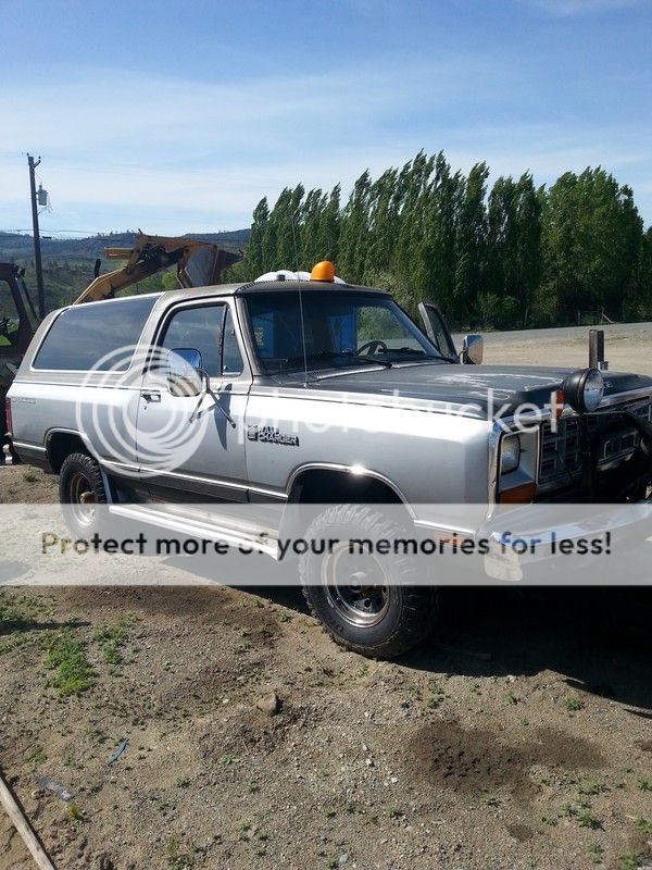

Pics from the sellers...

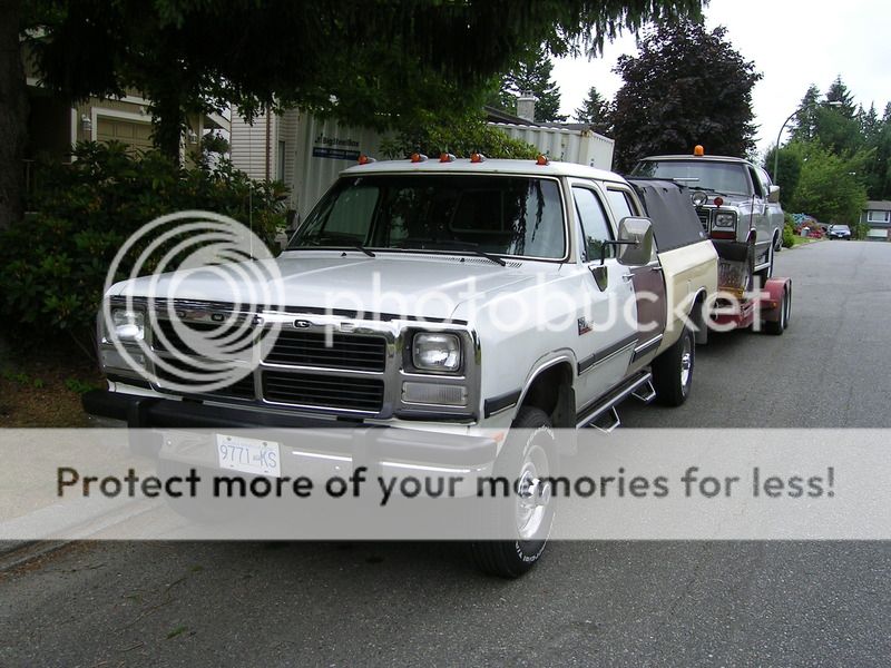

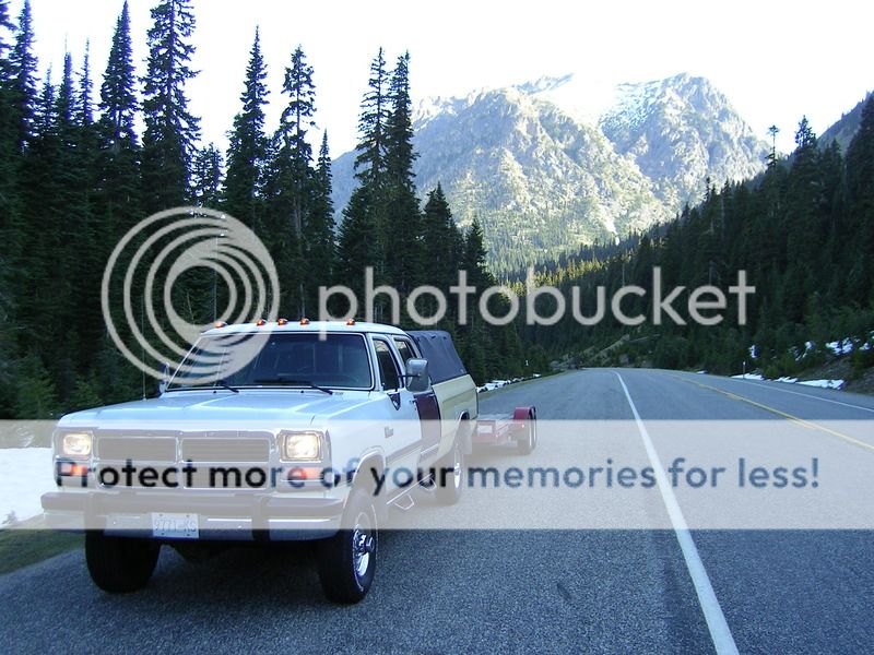

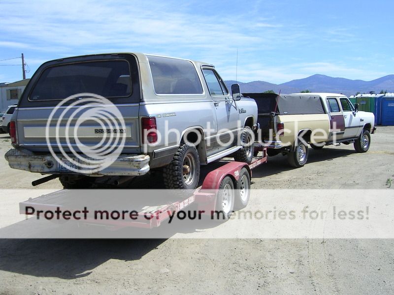

Couple nice pics at the top of one of the passes on the way there....about 4*C (40*F)...
And loaded up behind Ol' Patches....

Some pis of scenery while driving...
Don't think I saw EGT's over 750*....and that was only because i lugged it a bit and then started to power up again. Most of the pulling my EGT's were in the 600-700* range!

Couple pics at the same summit....
Learned some valuable lessons though on this trip through the mountains. NEVER use a rental trailer with surge brakes! I went down most of the long steep grades in 3rd gear, ding about 30 mph, and the RPM's up around 2500rpm. Even then I still had to ride the brakes a fair amount, and could smell my rear drums heating up more then a few times. I know my drums are glazed now so will have to pull them and sand the surfaces to break through the glazing.
If I had an Exhaust brake it probably would have been a lot better, but having electric brakes on the trailer would have made a huge difference....oh well made it through without incident, so lessons learned. ;)

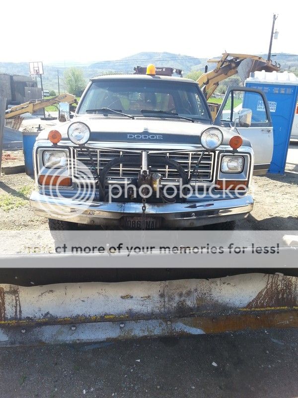

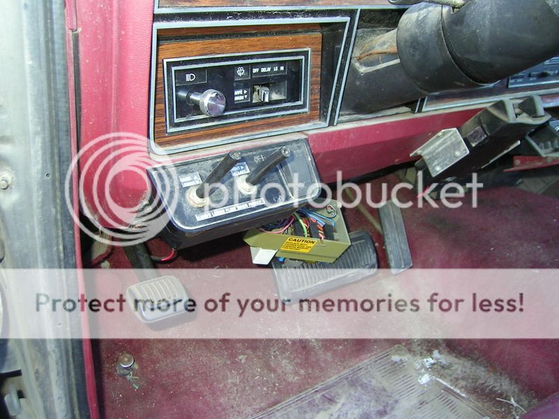

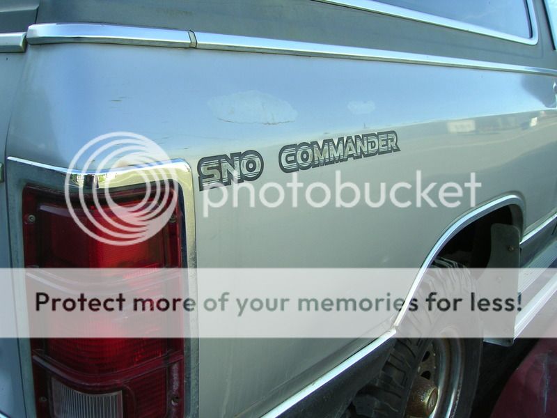

And a couple pics of the Sno Commander option and plow....

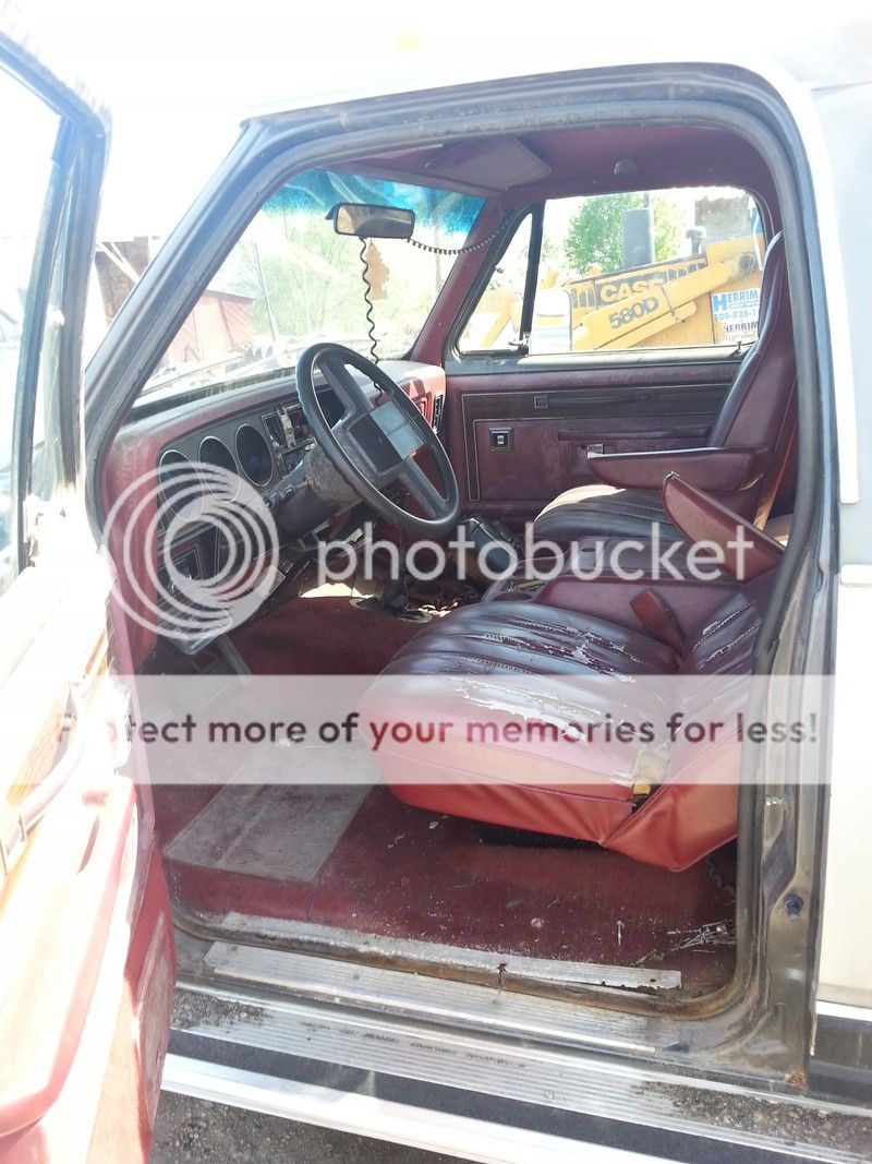

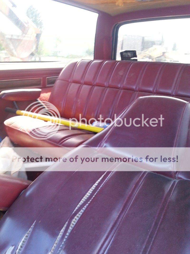

The Ram Charger is a full load too....A/C, Cruise, 360/auto, 4wd, power windows and locks, and obviously the plow option. Interior is a bit beat, but buckets and console, the driver seat back broken and laying flat...but hit a couple wreckers today and found a seat matching seat from a ram van in the same basic color....and in decent shape! So that will get swapped ASAP.
Drivers PW needs some lovin, and there is a few engine leaks that will need to be addressed. And the biggest issue is the tranny is about toast, which they told me about. It will "just" move itself around on the flat, but try and go up the ramps on the trailer and it powers out. Fluid is dark and smells like an old camp fire. So a new torque convert will need to be sourced, and a full rebuild kit. So will have to get on that quickly as well.

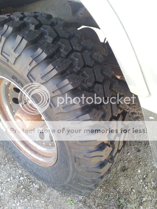

But it has brand new winter tires which was nice to see....

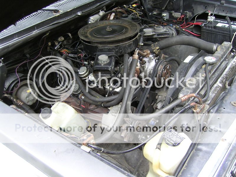

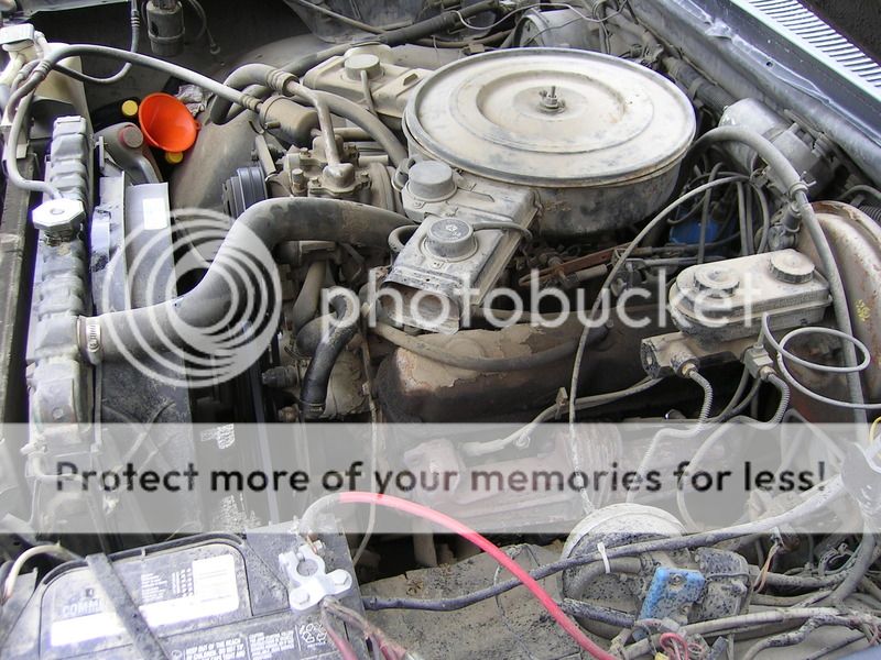

Getting it across the border from the USA to Canada went surprisingly well.....so once home I began checking things out. Pulled the rear bumper so I could open the hatch, in great shape. Then began pressure washing the engine bay, and underneath etc. once the engine was mostly clean I noticed that it had an older Eddy performer intake, and a 600 holley with Vac secondaries, and electric choke, also has one of those Leece neville 160 amp(?) alternators. But seems to run well enough.

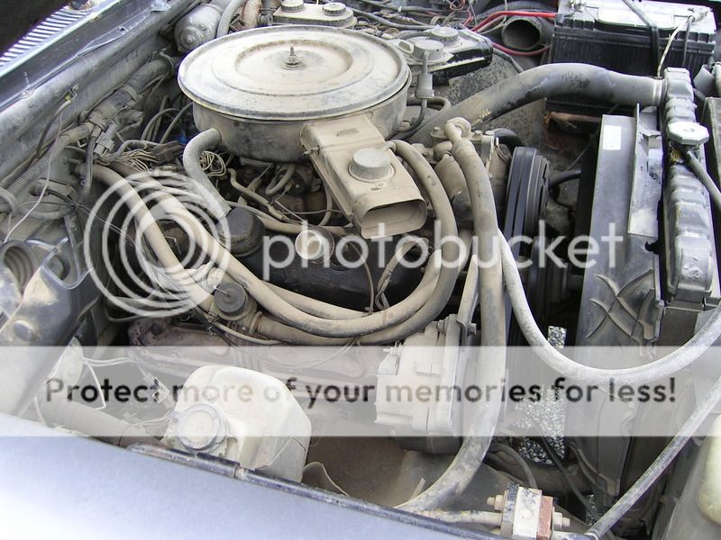

Engine bay before.....
After.....

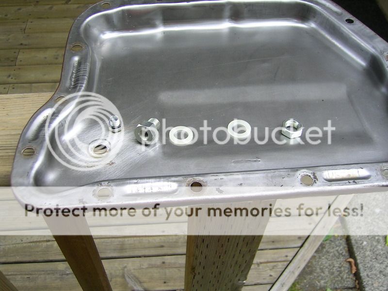

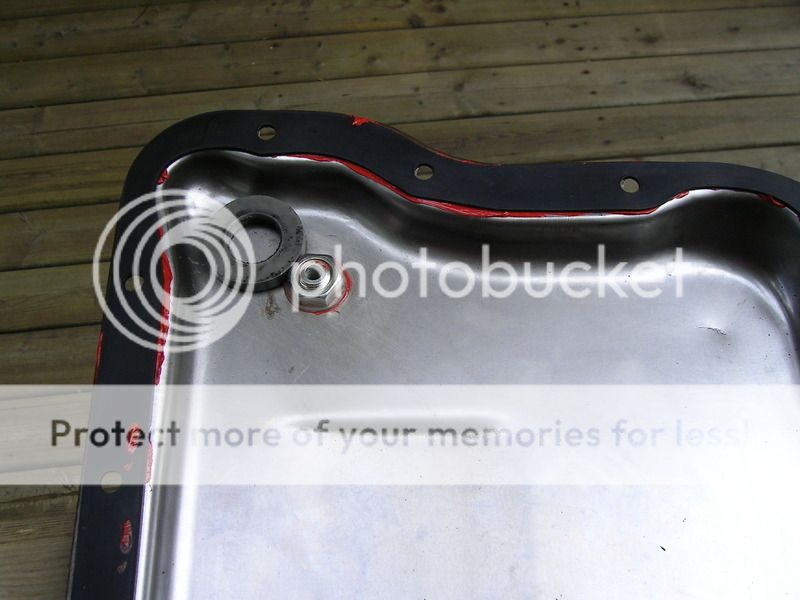

Once home I opened the tranny up and figured I'd do a band adjustment, filter change and replace the selector shaft seal.
Also added a drain plug...as I always do. Usually get the B&M kit, but NAPA has the exact same unit for about half the price. ;)
There is a small dimple where the magnet goes over to help keep it in place. I drill out the center of that to about 9/16, the hammer the dimple flat, then re-drill and install the drain. Magnet fits fine behind it and does not interfere with the dip stick.
thrashingcows
Posts: 575
Re: Project Sno Ball....85 RamCharger
Postby thrashingcows » Mon Jun 20, 2016 9:41 am
Thought I remembered how to adjust the bands....tightened them up to 72 inch/lbs and then sealed up the tranny, filled it and fired it up. Well it would not move! Thought the e-brake seized up so pull the rear drums and made sure the cables were free.....still no moving.
Took me a bit to figure out what I had done wrong. Then actually checked the FSM to double check the band adjustment, and realized that once at 72 in/lbs you have to back the band adjustment off a certain number of turns....Doooh! So had to drain the tranny and pull the pan so I could re-adjust things properly. Thanks goodness for the drain plug I just installed...;) :D
Once adjusted properly the tranny seems to work great! Don't think it will need a rebuild anytime soon....hopefully.

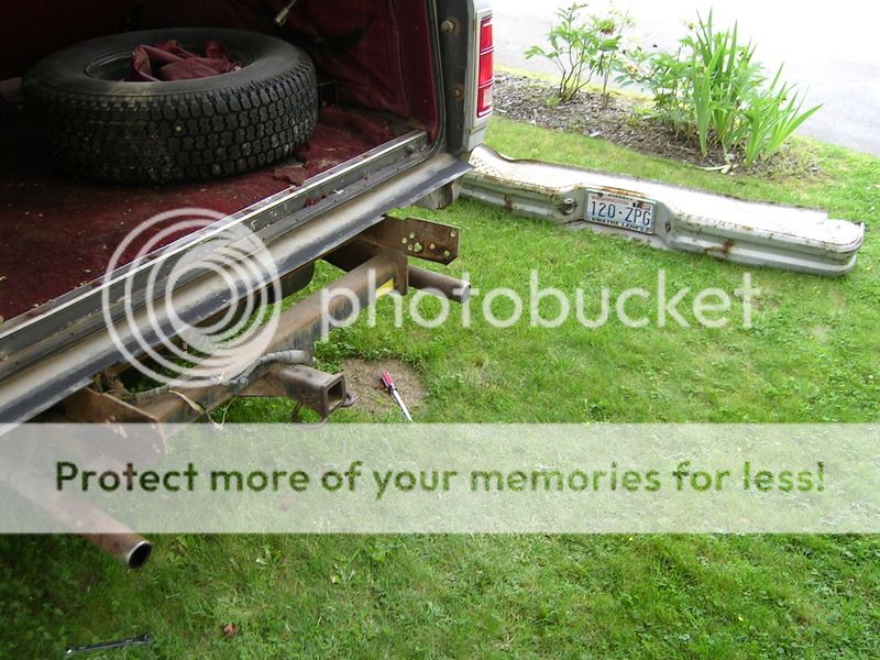

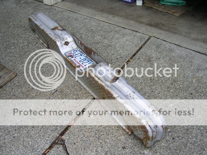

Postby thrashingcows » Mon Jun 20, 2016 9:48 am

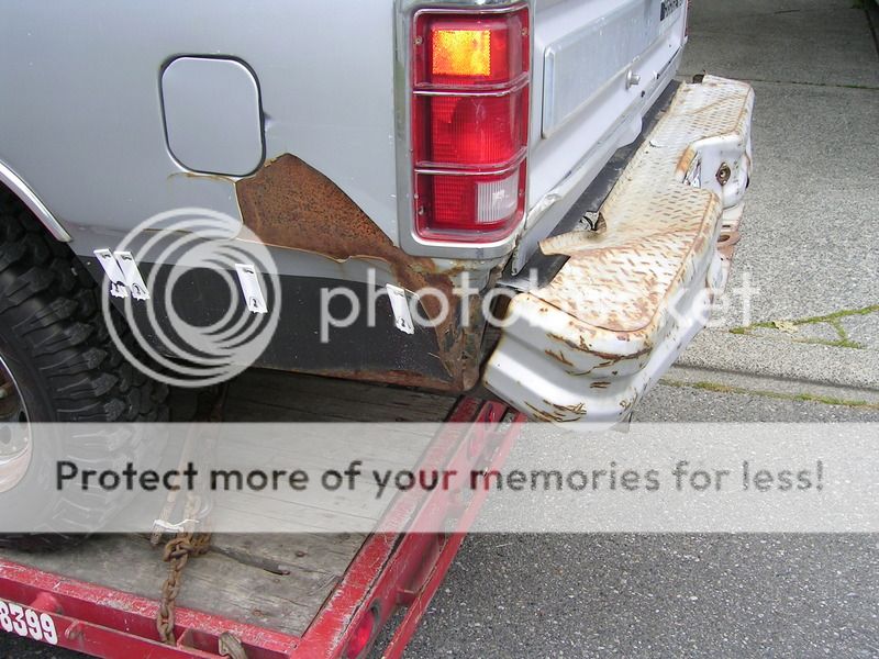

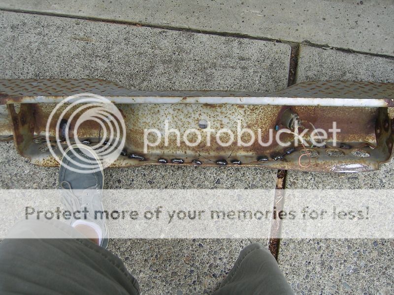

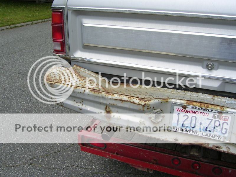

The rear bumper was bent up.....and because of that the rear hatch would not open.
So pulled the rear bumper....all the bolts broke which was nice. ;) And got the hatch open.
My friend/neighbour and I beat the thing back into basic shape with some big dunnage, couple sledge hammers and hammer and dolly.
The bumper was pretty beat, so also required some re-welding.
Coat of light grey paint and installed it back on.
Not sure if I like the light grey...was looking for silver but could not find it in Tremclad brush on. Might re-paint it later, or see if I can find a more RC-esque type rear bumper.
