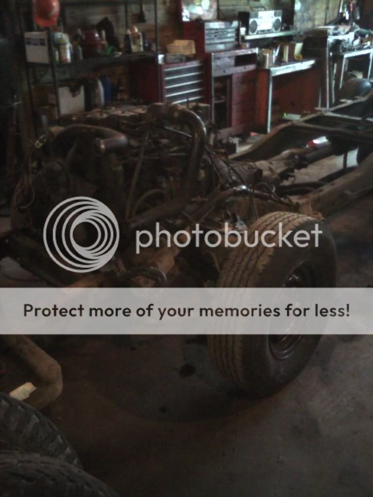

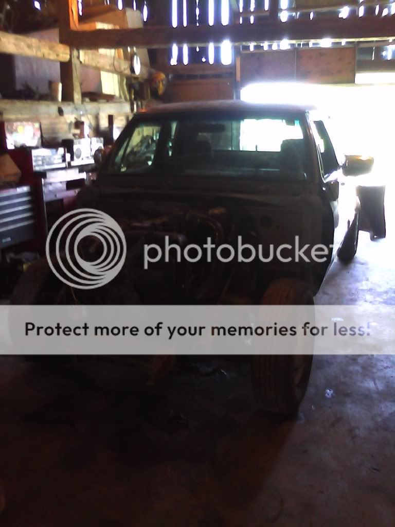

Postby dazedandconfused » Sat Mar 19, 2011 12:37 pm
Started stripping the 93 today.

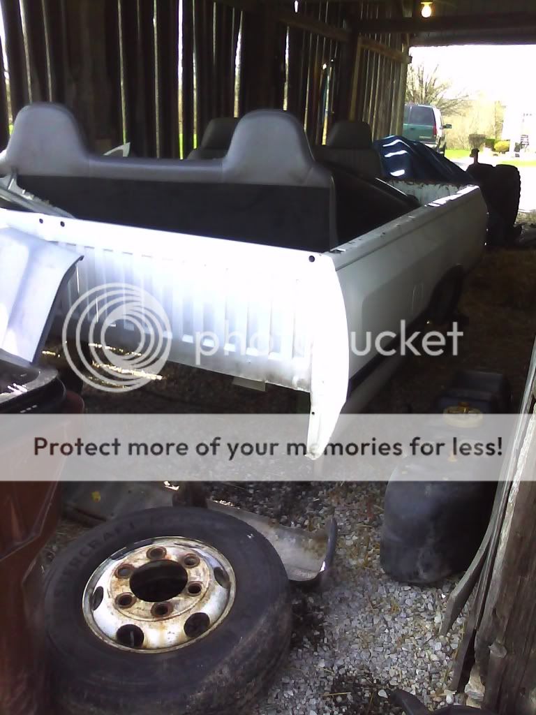

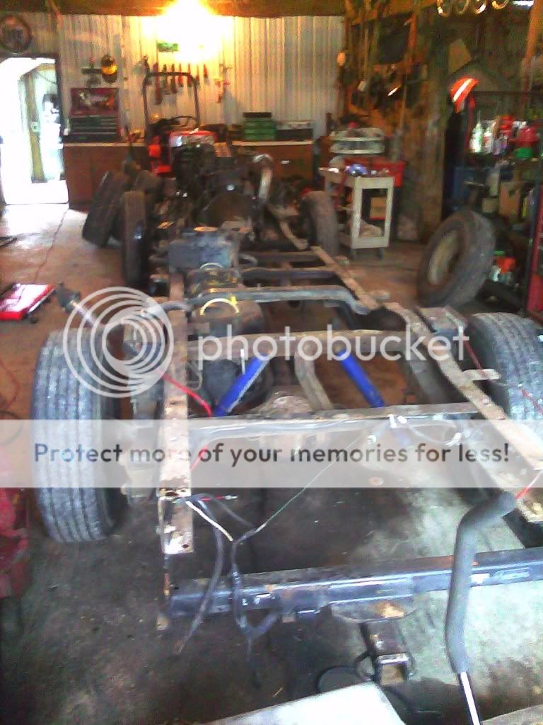

Postby dazedandconfused » Fri Mar 25, 2011 3:31 pm
Well worked on it a little bit after I got off work. The 93 is just a frame and drivetrain.
