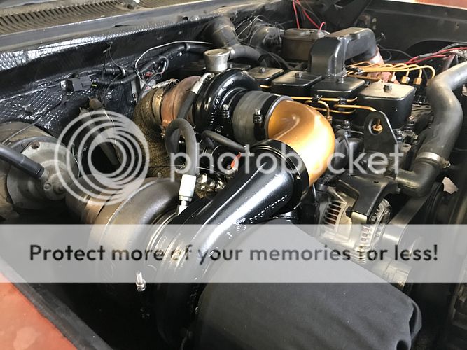

Postby 79Powerwagon » Fri Dec 14, 2018 5:56 am
About ready to fire up
1979 Dodge Warlock, I/C 12v, 518, TCS89% Converter, 6x13 injectors, HE351cw, Piston lp

Postby PToombs » Fri Dec 14, 2018 6:11 pm
That looks nice!

Postby spencerdiesel » Tue Feb 19, 2019 5:20 pm
Looking smexy are your 6x13s set to 245 bar?
