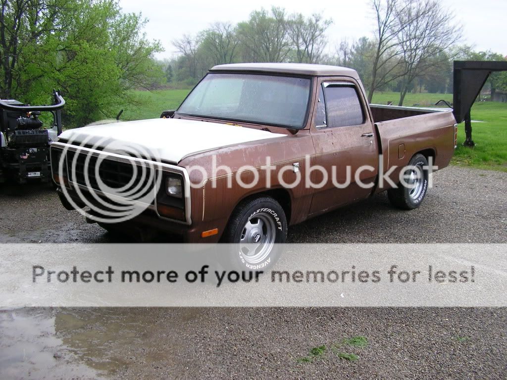

Thanks, everyone says I should leave it brown but I just can't do it. When she is done in a few years it will be light blue. Hope to pull the doghouse and the engine/trans out of it today.

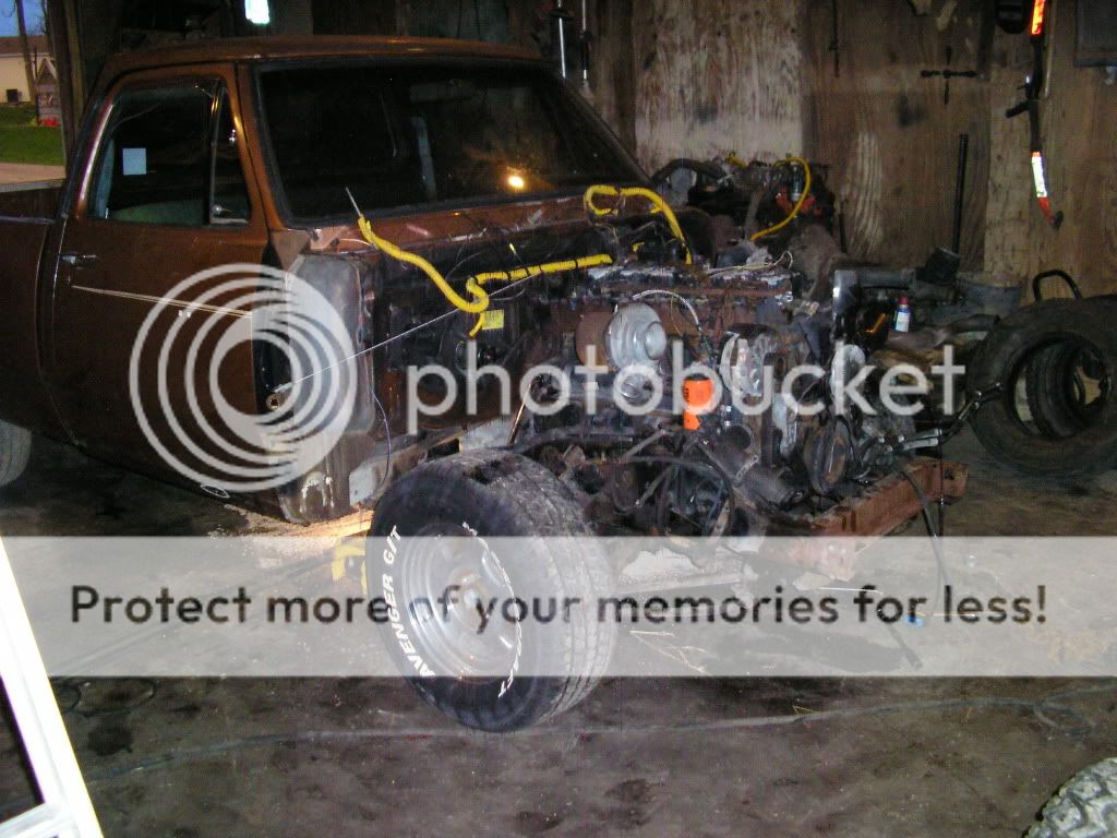

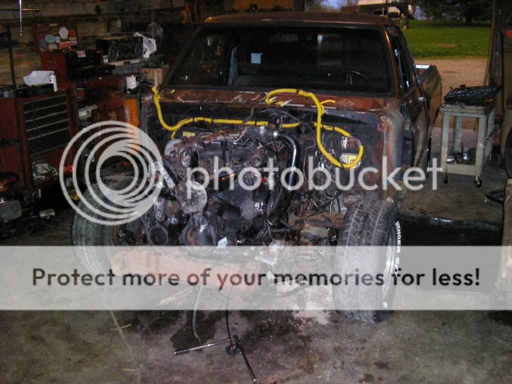

Well pulled the doghouse, engin and trans a little while ago with help from my brother. Had it apart and our mess cleaned up in a hour an 45 minutes. :D I now need to pull the cummins off the frame and start pulling crossmembers and such to swap.

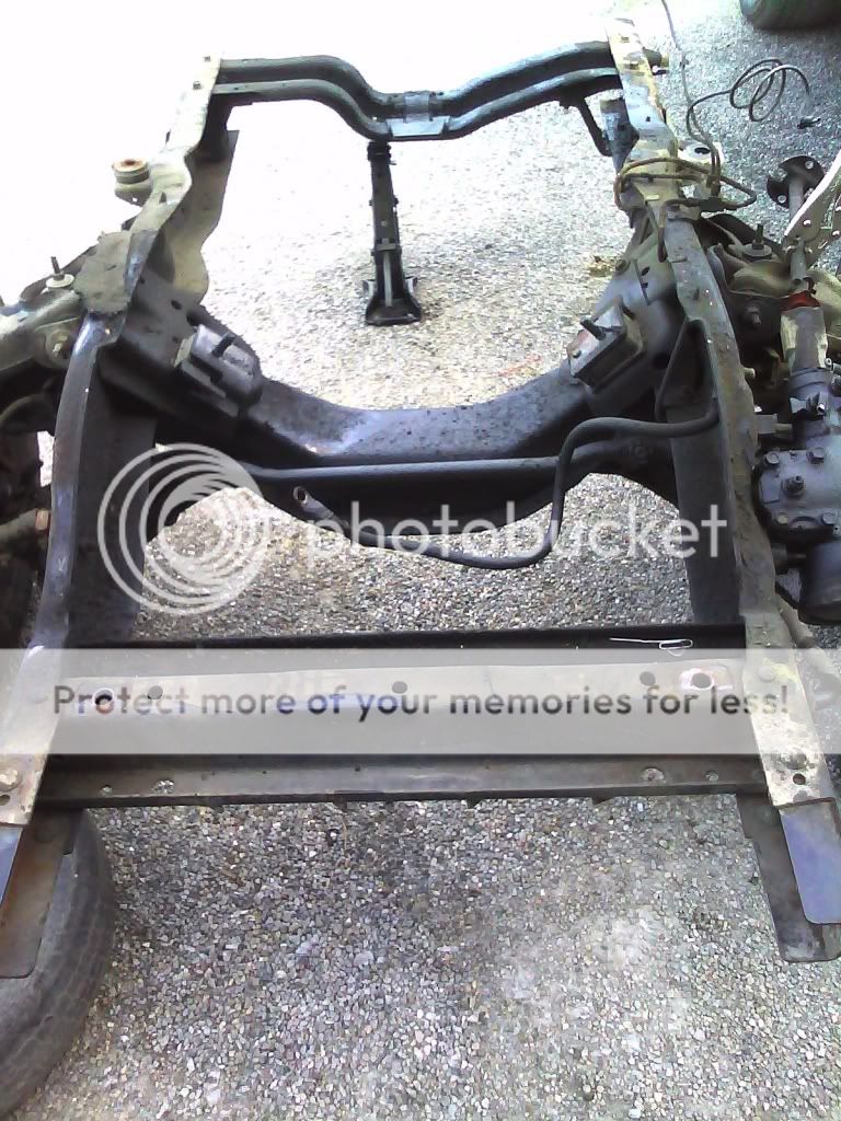

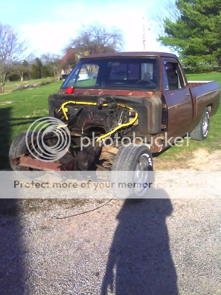

Well pulled the cummins off the frame section and was happy to see the crossmembers were so similar. I'm going to use the half ton crossmember since I found a few huge cracks on the 93's. I'm going to preasure was everything tomorrow and try to get the engine set down in the Duck.
93 crossmember
83 Crossmember

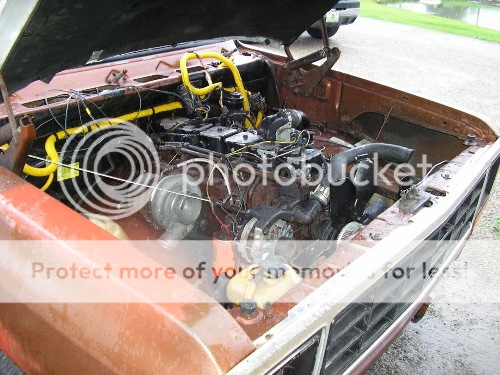

Ok so I have a few questions for you all. What all does the computer mounted to the driver side fender control?
Re: Project ugly duckling
Postby oldestof11 » Tue Apr 19, 2011 6:14 pm
Charging, speedo, codes, etc.
All of which can be mechanically controlled.
Postby dazedandconfused » Tue Apr 19, 2011 6:22 pm
Well charging is already an external regulator. What about A/C and such?

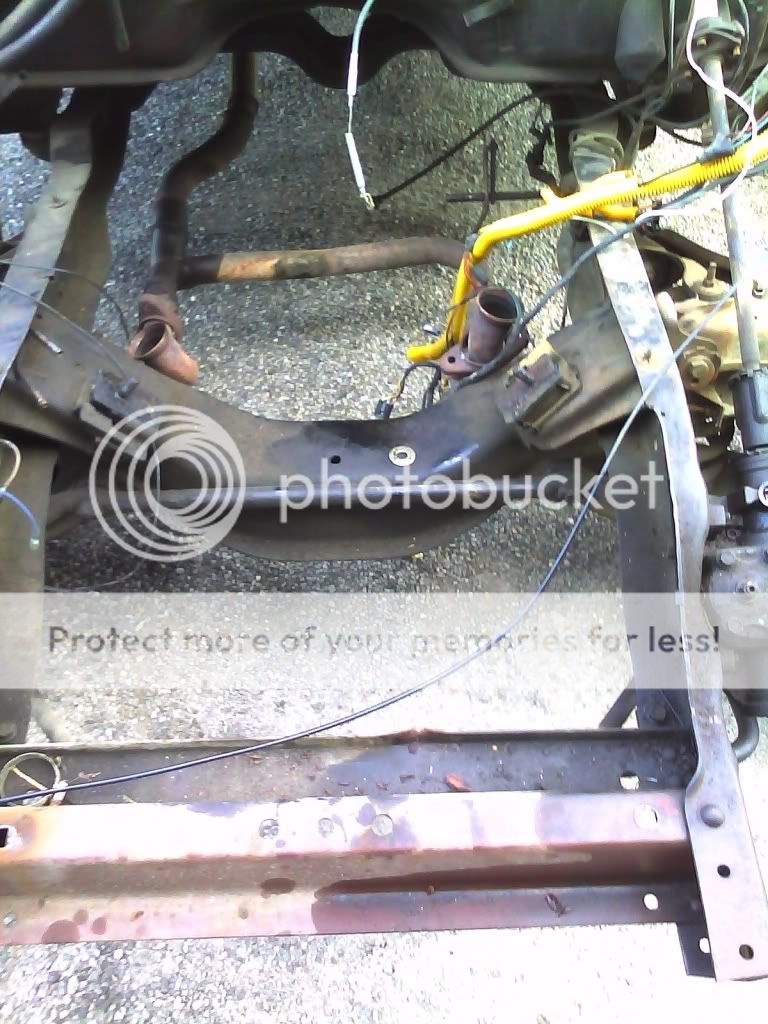

Postby dazedandconfused » Fri Apr 22, 2011 5:34 pm

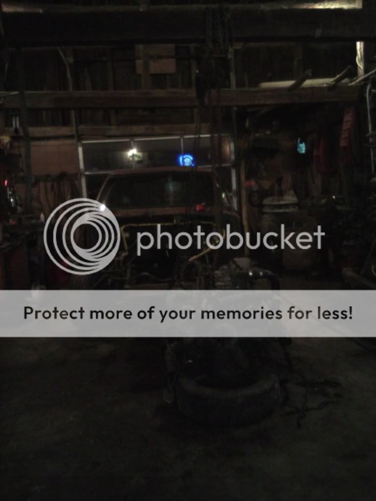

Its in one piece again so I can get it to my house..
Postby ellis93 » Fri Apr 22, 2011 5:57 pm
How's the front axle looking holding up that cummins
Postby dazedandconfused » Fri Apr 22, 2011 6:02 pm
Its actually doing better then I thought. Its all 1/2 ton right now but I have the bottom arms and springs to swap in.
Postby ellis93 » Fri Apr 22, 2011 6:10 pm
You buy the aftermarket arms or you tring the factory stuff
Postby dazedandconfused » Fri Apr 22, 2011 6:42 pm
Factory lower arms off the 93. I'm to poor for that fancy stuff.
