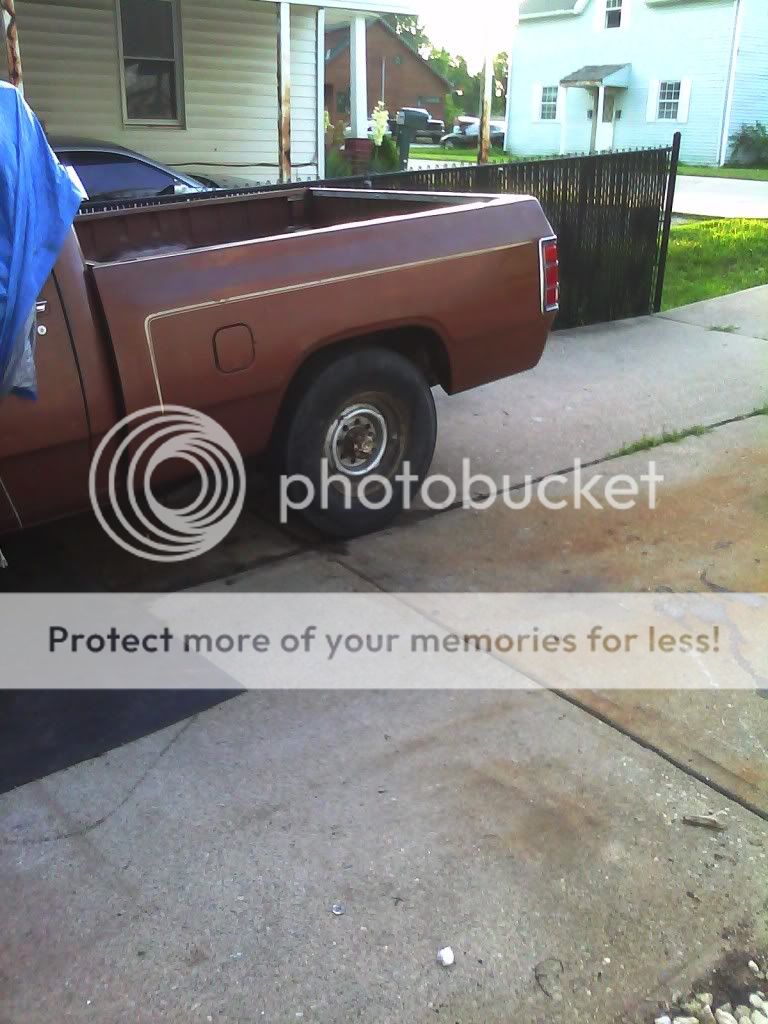

Postby dazedandconfused » Mon Jun 06, 2011 6:34 pm
Well pulled the bed and cab off yesterday and drilled all bolt holes for crossmember I needed. We put the bed and cab back on. Today I put the nose most of the way back on it. I can't get the 84 Grille on it with the A/C and intercooler on it so I just stuck my 93 grille on it. Trying to get her road worthy so I can start driving her.

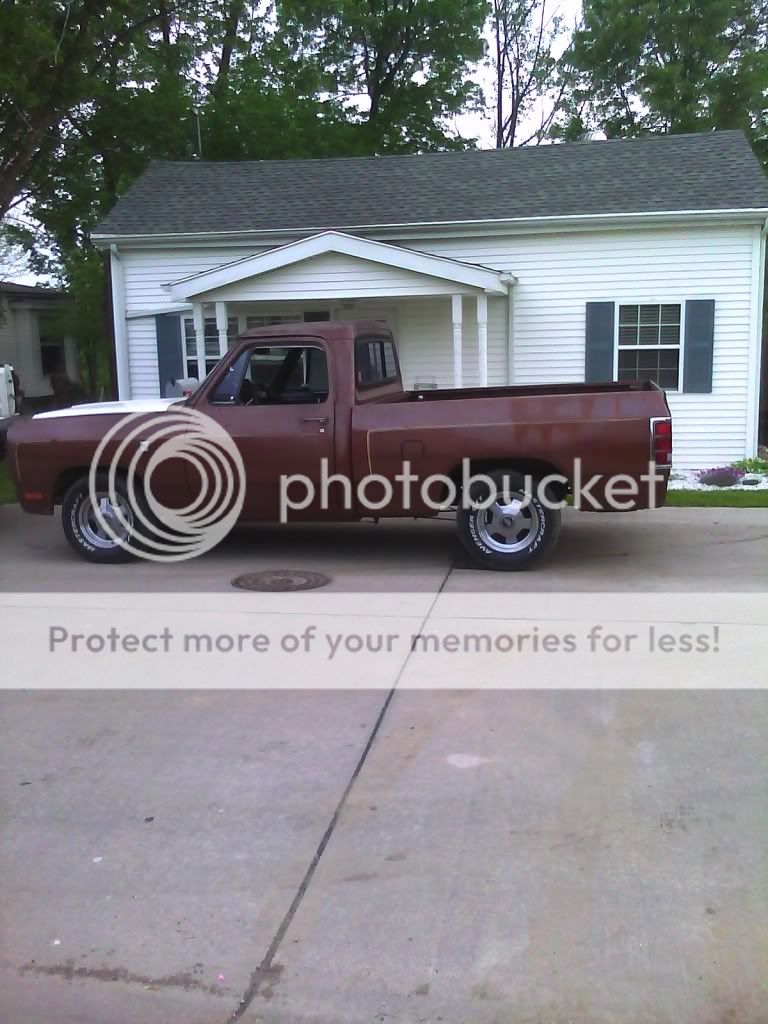

Postby dazedandconfused » Thu Jun 16, 2011 6:16 pm
Well took a big step in making her ugly. :lol:

Re: Project ugly duckling
Postby dazedandconfused » Thu Jun 16, 2011 6:24 pm
I'm going to order some 15x10 8 lug white spoke wagon wheels and throw on my hubcaps so unless you know what I've done or looking at under there it shouldn't be noticeable.

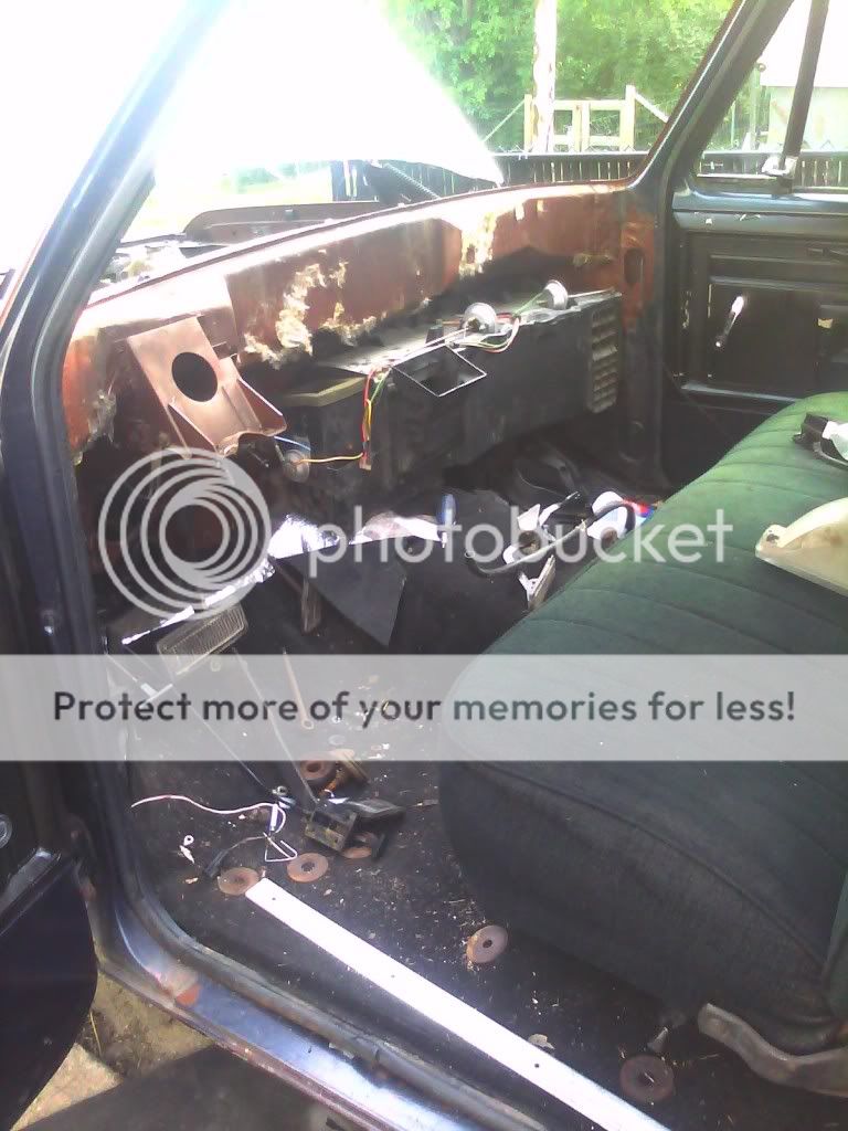

Postby dazedandconfused » Mon Jun 20, 2011 3:52 pm
Ok so I hit a wall tonight. I've changed all the wiring harness in the truck to the 93 harness. I threw the steering colum in tonight to see if anything worked but just left it laying down on the seat. The dash is still loose laying in the truck as well. So I make sure everything is hooked up and attach the battery. Turn the key and nothing. The only thing I don't have on it is the ground from the engine block to the frame. I checked the fuses with my multi meter and nothing. No headlights, no movement of any gauges nothing. The only thing that works is the 4 way flashers. Anybody got any ideas? There is an orange wire under the hood that I believe had a fusable link in it that's gone so I jumped the wires. Was agrevated so called it quits for the night. Everything is pluged in. The computer isn't mounted to the fender and I didn't put the abs box in it. Someone give me an idea.
