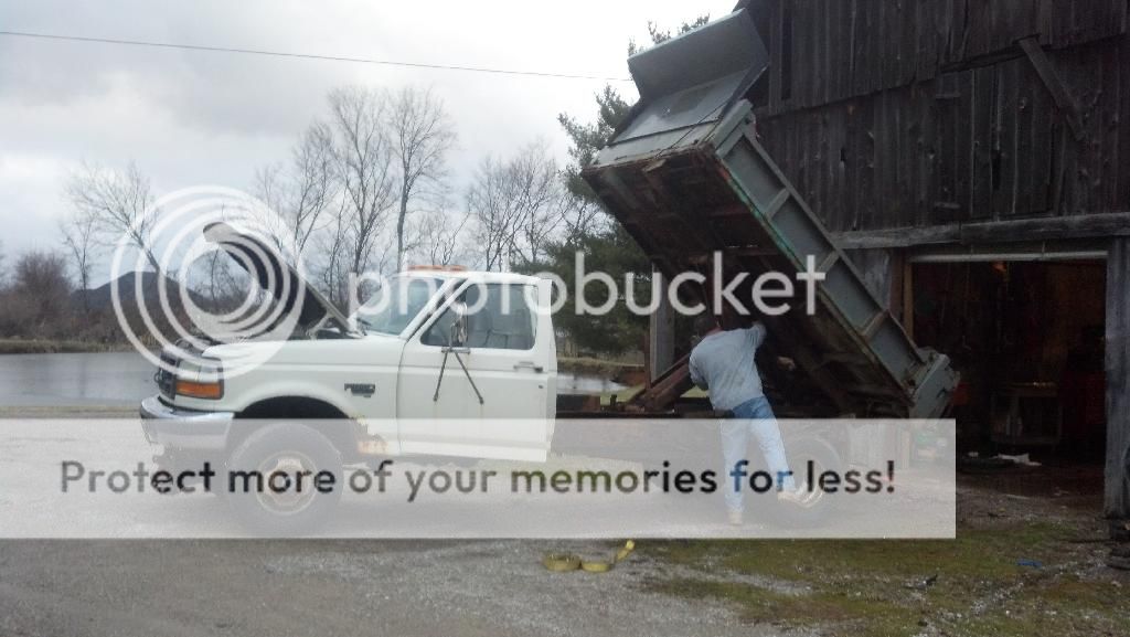

Well me and the old man worked on the Ford some this weekend. I figured out my salt spreader and got the bed working. Dad finally had enough of my procrastination and installed my mud flaps too.

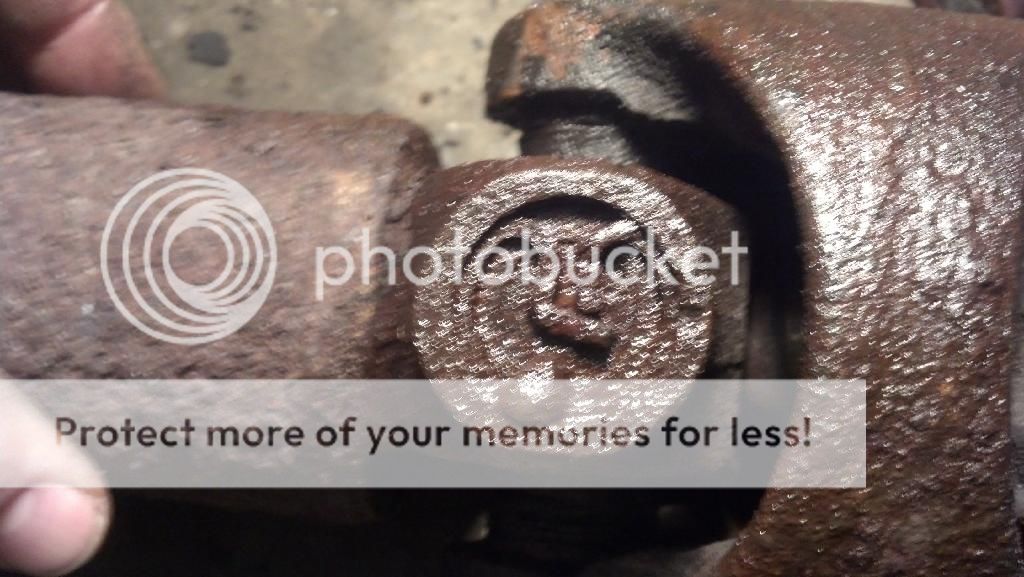

They managed to screw up the snap ring retainers so bad on one U-joint I had no choice but tac the new joint like they did. It will get a new shaft when I rebuild the 83.
Re: Project i bumped my head
Postby PToombs » Sun Feb 02, 2014 12:47 pm
I don't see a problem, the old joint didn't fall out did it? Then it was a good fix. ;)

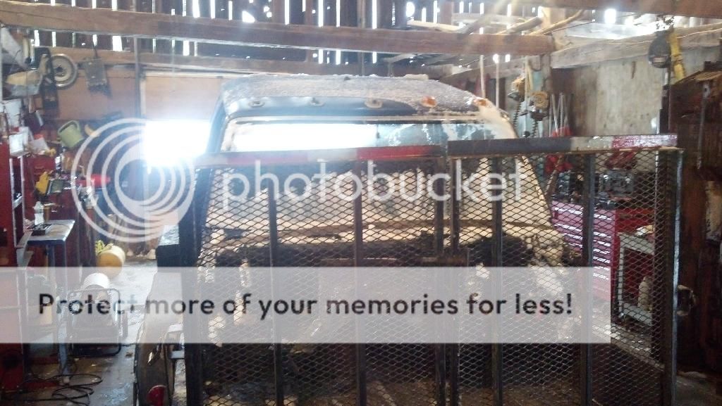

Well took the guttless bastard to pick up a cab yesterday. I'm less then impressed with this thing each day I drive it. Its way underpowered and gets horrible fuel mileage. I averaged 7mpg yesterday pulling a 16' trailer with a cab on it. Running 65mph top speed sucked also. Guess I'll pick up that 440 I've been watching.

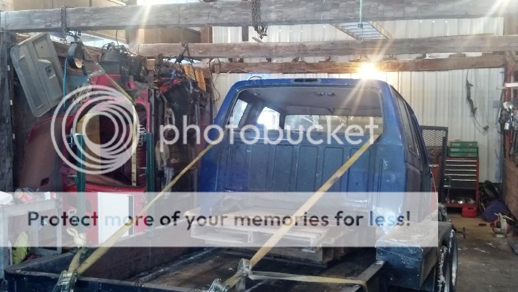

Gutted my new cab today. Need to start prepping my frame and getting ready for chassis paint.

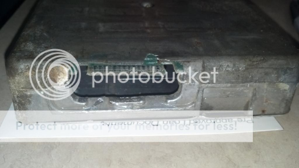

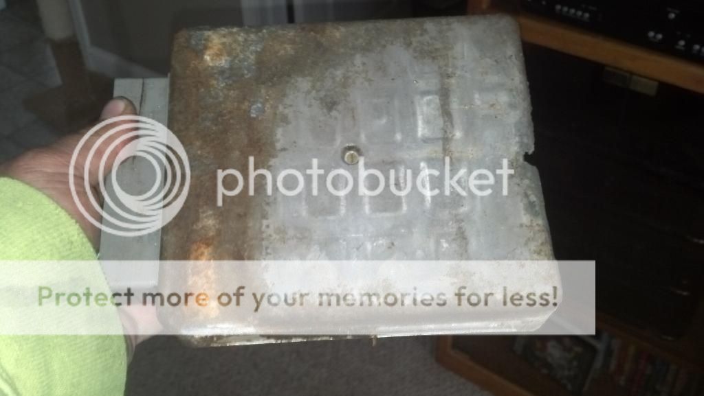

I pulled the pcm out of the dump tonight. Apparently its been wet before. I had to pull the e-brake and use a 2x4 and hammer to beat this SOB out.
Re: Ford project
Postby ellis93 » Fri Mar 14, 2014 6:12 pm
Andy you went about that as$ backwards,you should have dropped(peeled the rear of it forward) the inner fender(plastic junk) and removed it by taking out that plate with tje two nuts holding the computer in.
