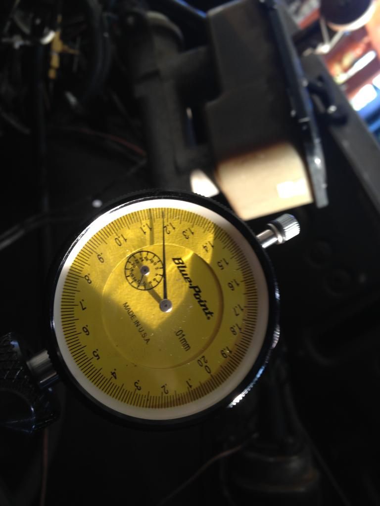

Postby ellis93 » Thu Oct 30, 2014 4:16 pm
I'm back on it,went 18* on the timing. I know I asked but this little truck doesn't weigh as much as what it was originally in so I figured I wouldn't loose enough bottom end to even notice. Plus my injectors will be going in,in a few weeks.
Anywho I got it to this
That plus the factory set should be 5.2 mm,that is 18* by the links I posted earlier.
