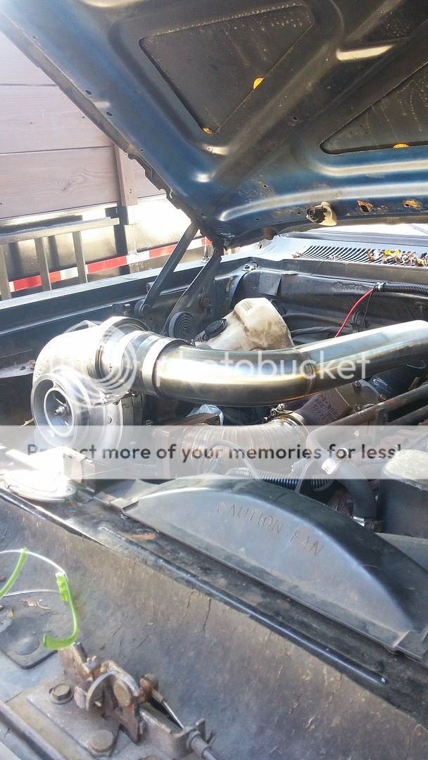

Got my s400 compressor outlet flange and am not to pleased about the quality.
I am going to fix that after I get all the piping done but for now it works for mock up.

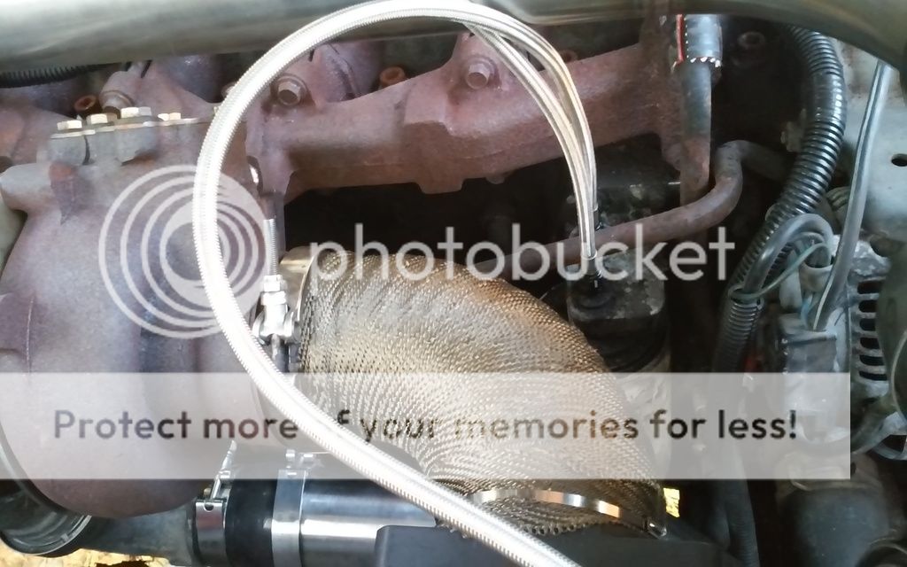

Most of the fittings came in for my drains. Now waiting on feed lines the fittings to go with the lines.

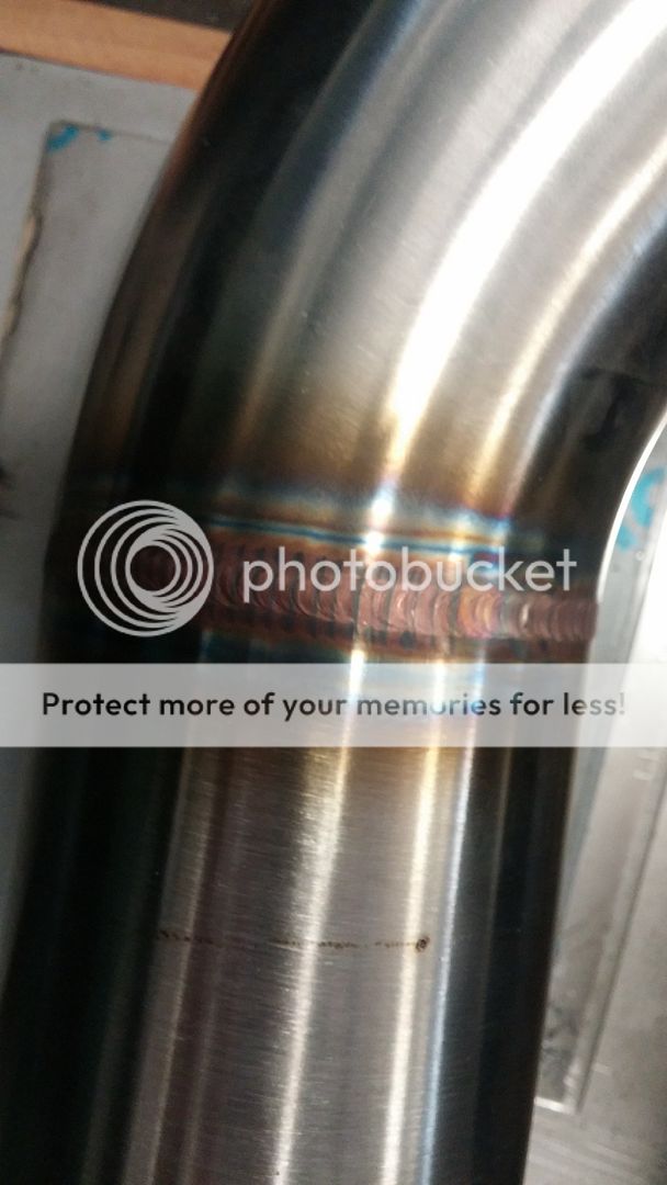

That stainless looks awesome! Better than the exhaust pipe I used. :oops: I drilled the wastegate in my small turbo out to 3/4", and I drilled the divider too. I had a brand new 12cm housing also.

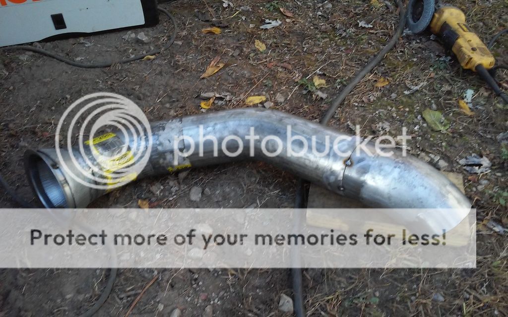

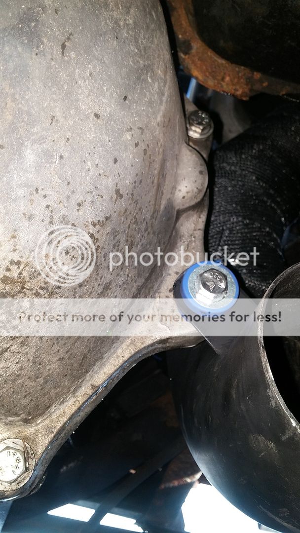

Living close to Summit is very nice, I ordered some parts last night and they showed up this afternoon. Got a good amount of work done on the truck today.
Downpipe has very little clearance.
I am thinking of making a spring gate for the super B because the diaphragm actuator hits the oil feed line.
Still need to make a mount for the s400, figure out my oil drains, finish the downpipe and figure something out for the intake.
Planning on wrapping the downpipe being so close to the elbow on the charge pipe and the heater box.

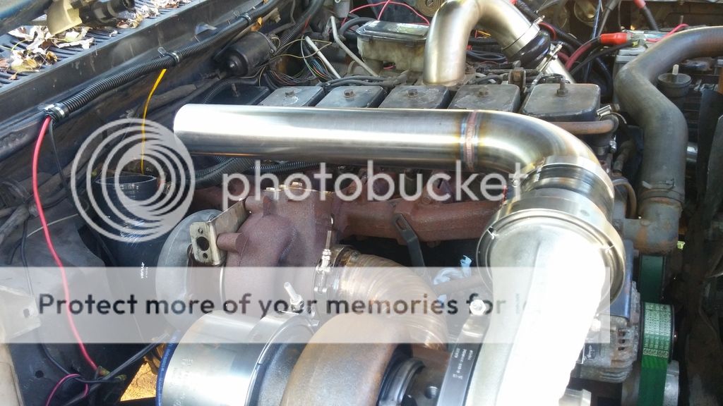

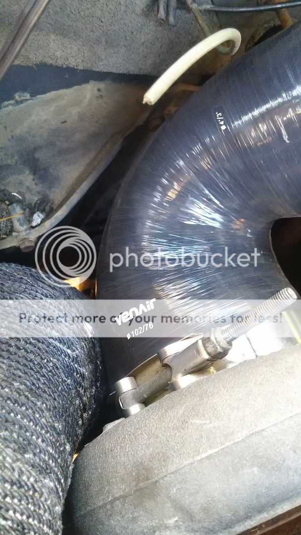

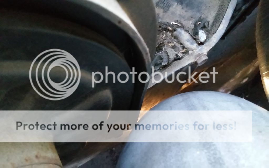

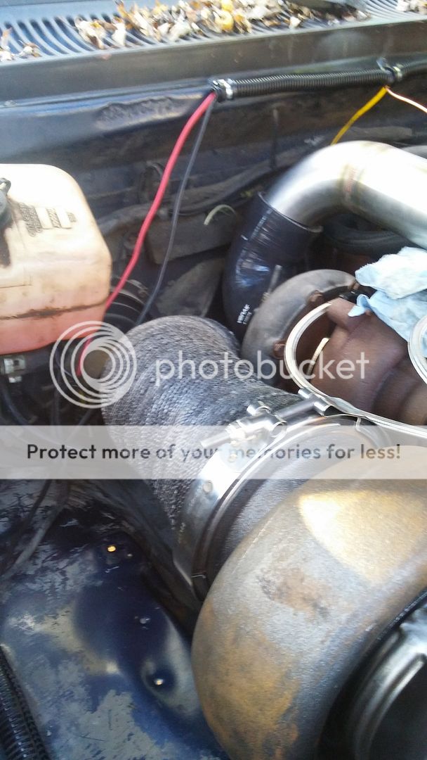

Well got it running Saturday and took her for a spin. Still breaking the clutch in, however I saw 30 psi total and 10 from the primary on a slight pull. Currently running a spring waste gate, truck idles a little white and smells like raw fuel until it's warm then it clears up for the most part. I've noticed that it doesn't smoke a black death cloud rather a lighter more gray cloud.
Took a dead blow to the down pipe to clear the intake boot. 50' of heat wrap with about a 50% overlap.

Re: superbee/s472 build
Postby oldestof11 » Sun Oct 18, 2015 2:53 pm
A couple things:
I didn't see it but what is supporting the weight of the S400?
Loosen up the spring gate some. You are driving the secondary at 3:1 ratio. You'll get more pull is you drive the big one sooner.
