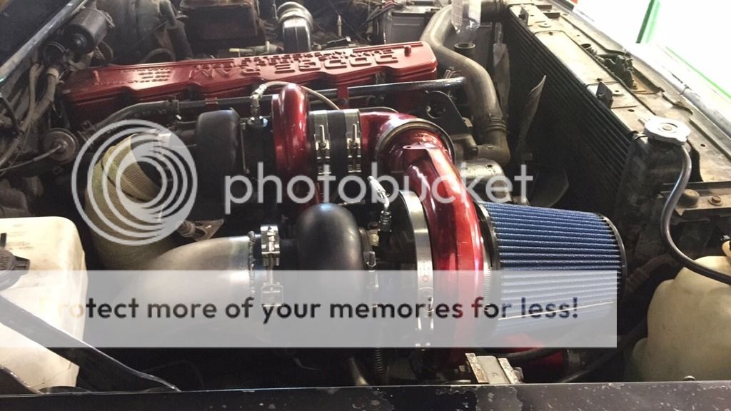

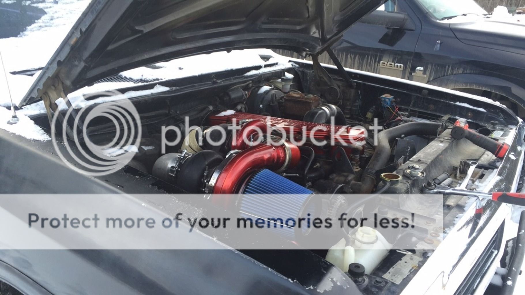

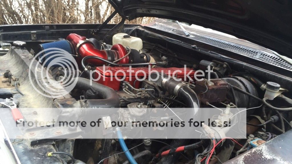

OK updating in here finally. February 10th I went out to my parents place with my completed piping, put the setup together minus a couple small things (namely the boot for between the cold pipe, and the secondary), but since the feeds, and drains were in place I could give starting it a shot, so with the battery from my dads tractor hooked up, and me standing in front with my camera ready. Unfortunately for me the truck fired so fast I missed the truck cranking, and firing.

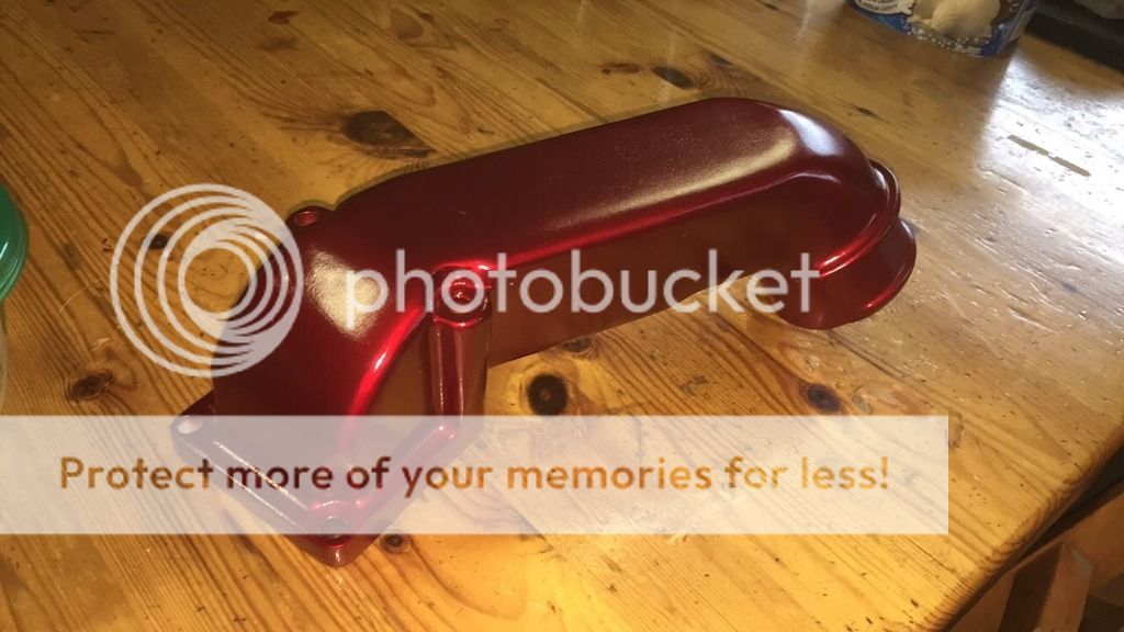

Around the middle of February I grabbed the intake horn from the 94 engine sitting in pieces in my dads shop, cut the leg off of it, smoothed the outside, made the inside a little less rough, drilled & tapped 2 1/8"npt holes in the back, and hit it with my gold, and red.

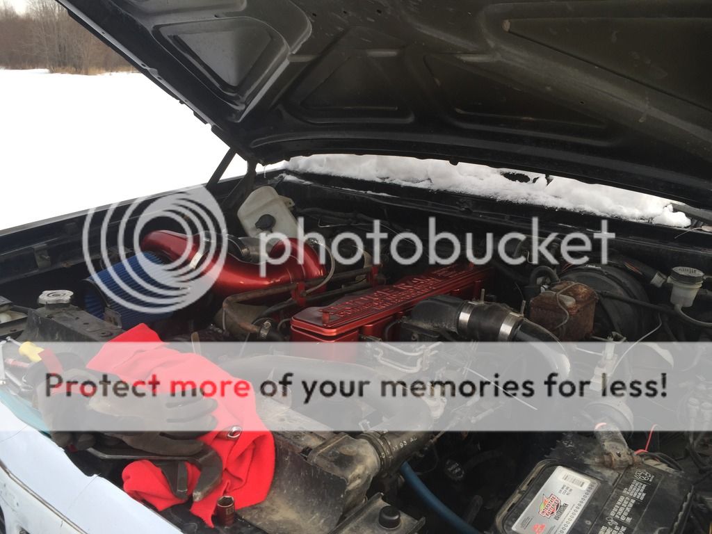

While my brother was cleaning out the gutters I took the opportunity to snap a picture from an angle that rarely gets seen. the top.

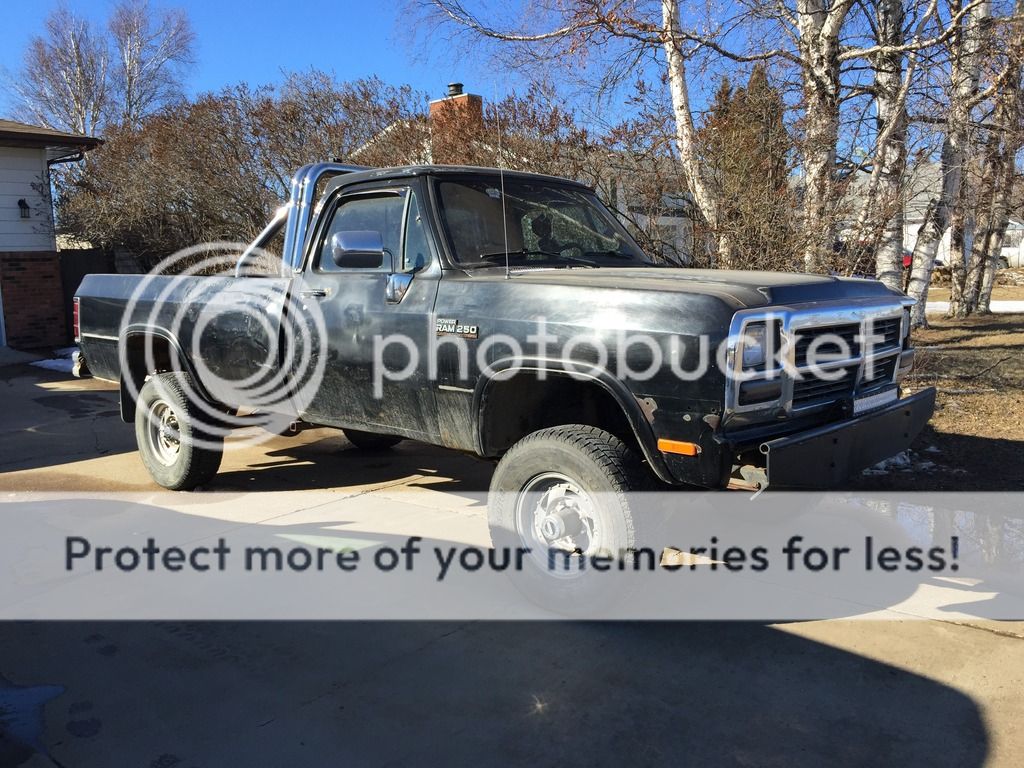

And before we left for my nieces birthday party I snapped a shot of both my heaps.
