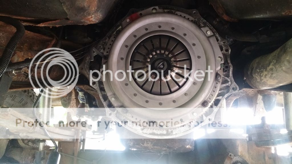

I got my clutch in yesterday after fighting a stripped 12 pt bolt for the pressure plate.

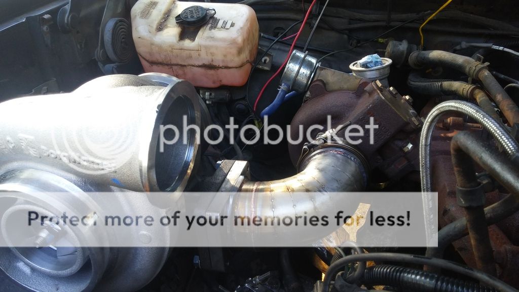

I have also been working on the hot pipe at work. T6 flange showed up yesterday so I tacked that on too
I am hoping to have the hot pipe done next week or at least heavily tacked together so I can start on my charge piping. Planning on having the trans in this weekend.

Man I don't know how you guys can stand using those rings, and having to weld all of them. I had to do 8 on my hot pipe, and it's a much longer section due to my running the turbos side by side. My cold pipe is less than a foot of piping, does a hard 90 (literally, where the inlet on the secondary meets the outlet in the primary I tacked it, and made a section of a bend fit in the intervening area) and has 3 welds

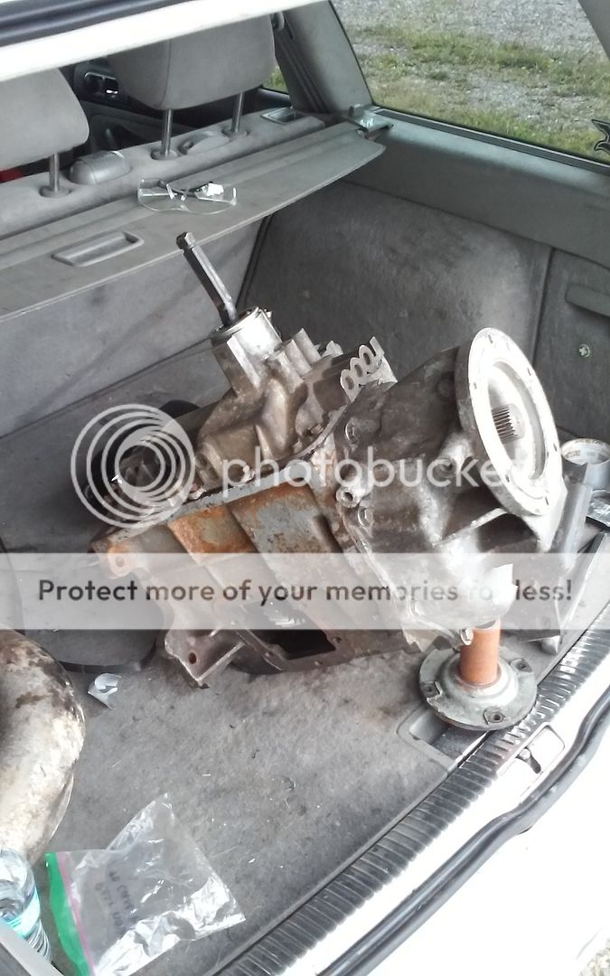

I would have preferred a 90* bend but I found a piece of pipe in the scrap bin at work and cut it up. My cold pipe will be all sanitary grade mandrel bends courtesy of the again the scrap bin. On a side not the Valair starter spacer does not work with the stock 1st gen engine adapter plate. I had to modify the spacer a little bit with a router.
Yes I used my car as a work bench.
9312v

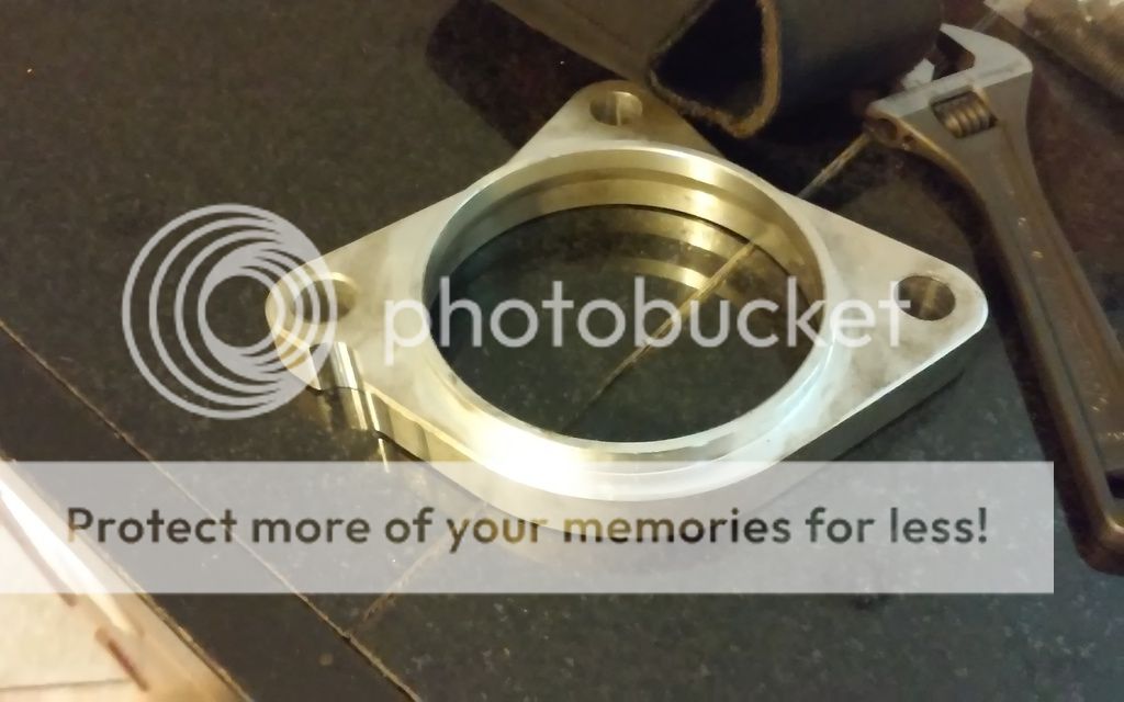

I got my s400 flange from keating machine (a lot cheaper than stainless diesels) along with the exhaust flange and clamp. The s400 compressor flange and clamp are going to purchased from race part solution as they have a nice pre-made adapter to 3". All of my piping is SS so I'm trying to keep as much of it that way .

Postby PToombs » Sun Sep 20, 2015 4:16 pm
I got my flange for the big turbo from Race Part Solutions too. It was what I thought to be pricey, but it had the holes all predrilled for the support bracket.

Postby 9312v » Mon Sep 21, 2015 3:06 pm
Cumminspower: ALH 5 spd. I had the trans in the back for a couple weeks. You could definitely notice the power difference. It can also fit three 35" tires with the seats down.

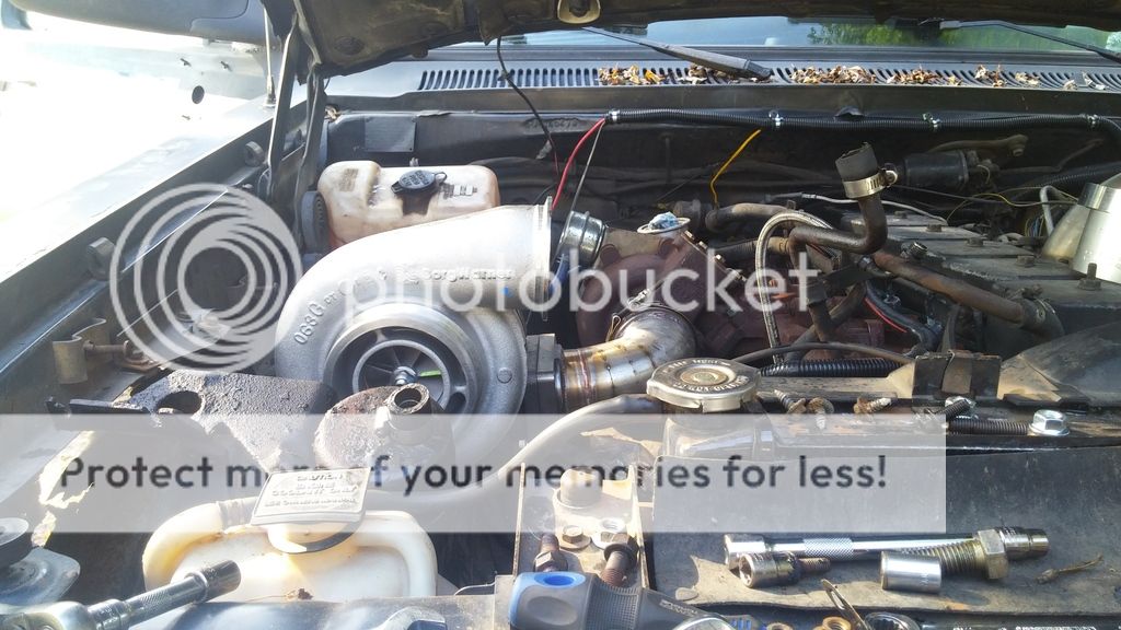

Well I wanted to tuck the turbo down low but my hot pipe didn't work for that so now the 400 will be up front.
now working on the charge pipes.
