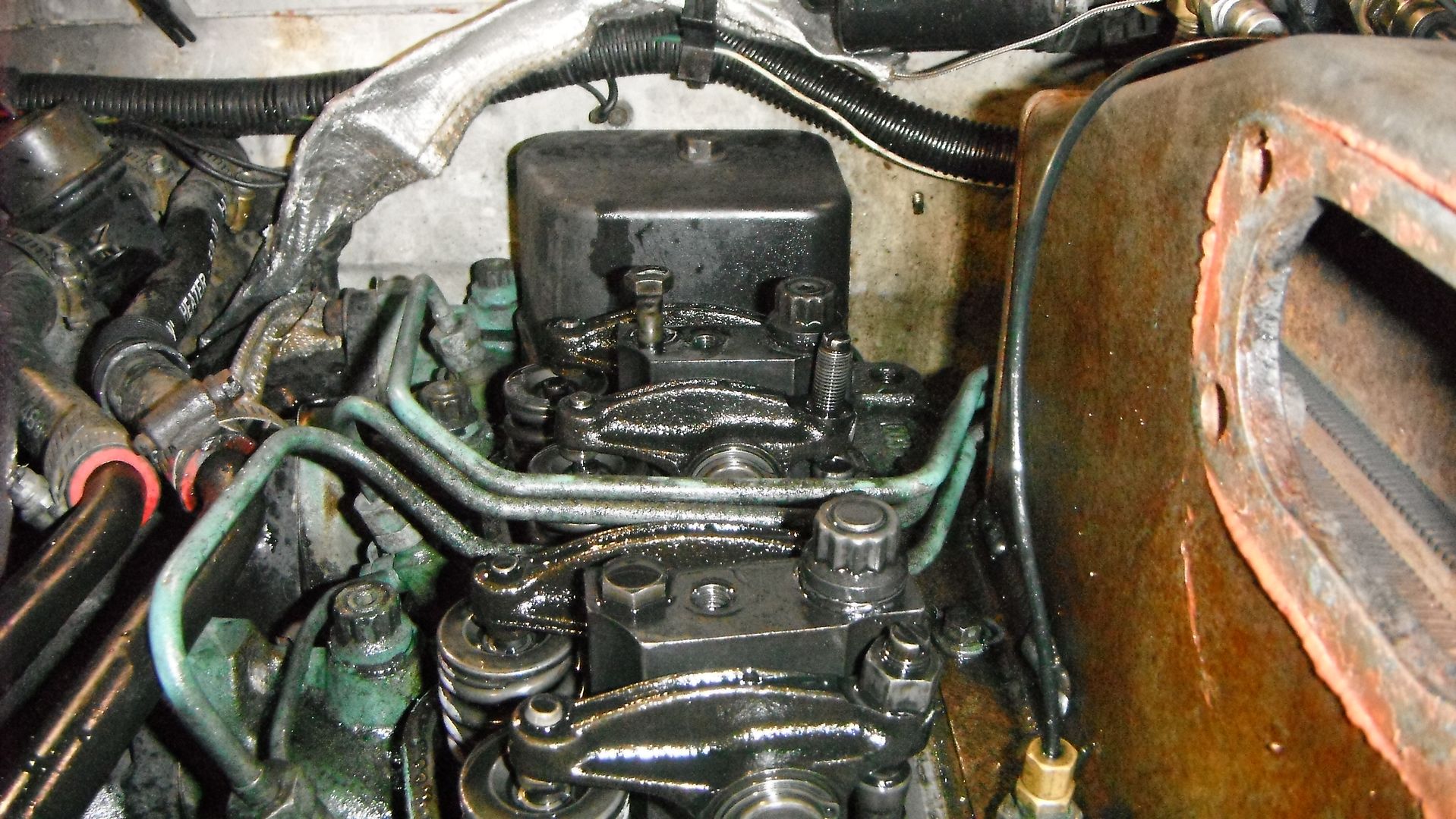

The truck developed a miss on the way to work the other morning. I knew what it was before the damn thing even finished opening all the way up. :roll: This is the second time that particular nut has backed off. I really put the torque on it the last time, I'm not sure why it keeps doing it. The threads got a little boogered from this bout so I just kinda cleaned them up and ran it back on. Instant locknut. 8) I had just loosened the support bolt and headstud.

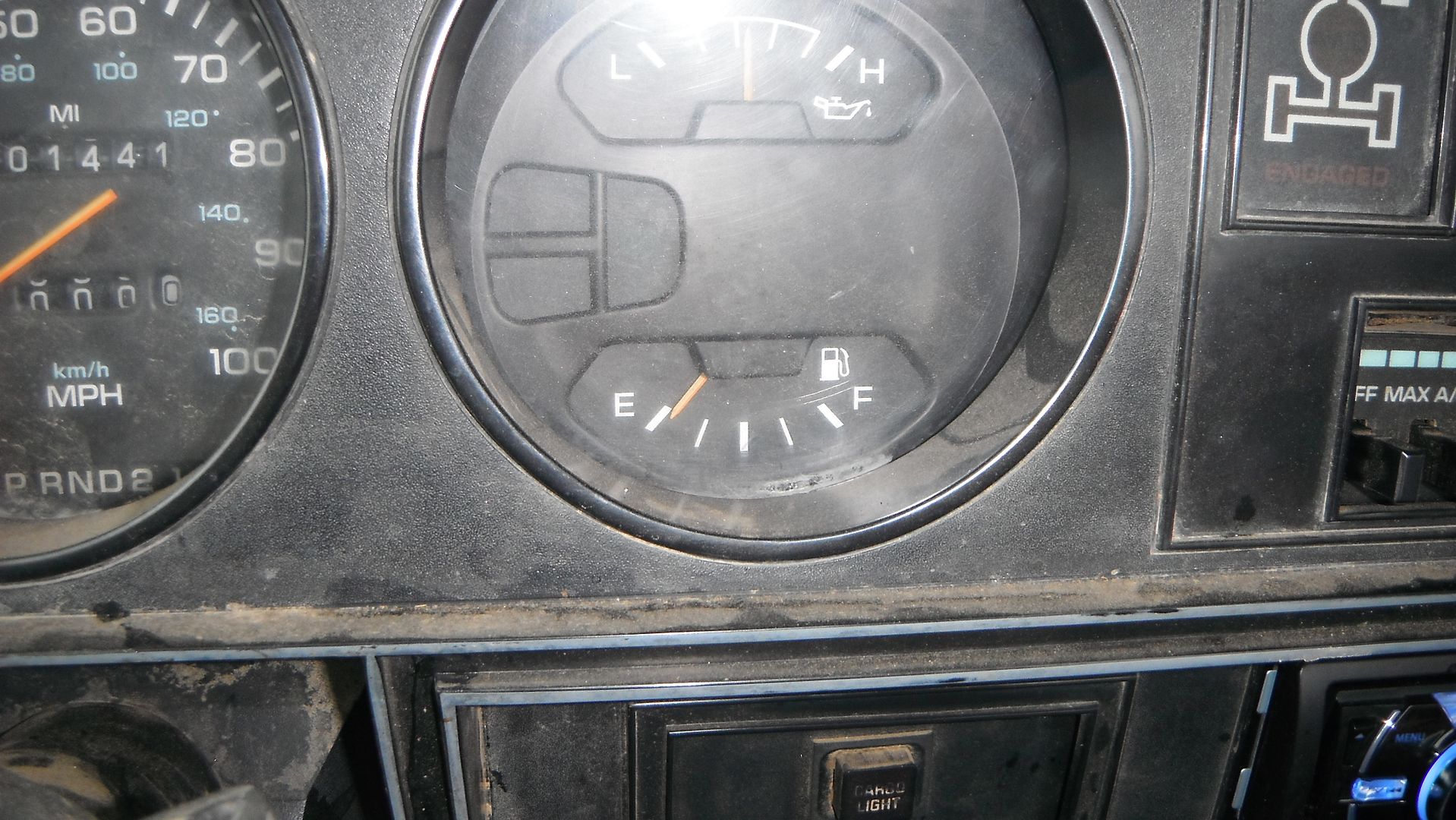

Some proof that my homemade draw straw is working as intended, it swung down below E when stopping or accelerating.

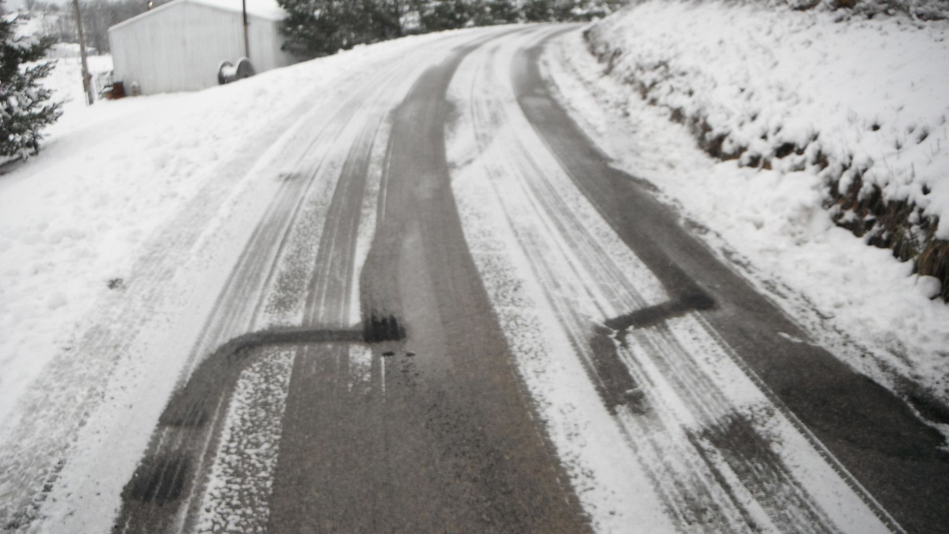

And some proof that the No-Spin does indeed posi up if you run it hard enough. The first mark on the left side was 2nd, it didn't torque it enough in the snow so I hit third and it locked right up. Stayed locked up through it's whole ride off the side of the road and everything. :lol:

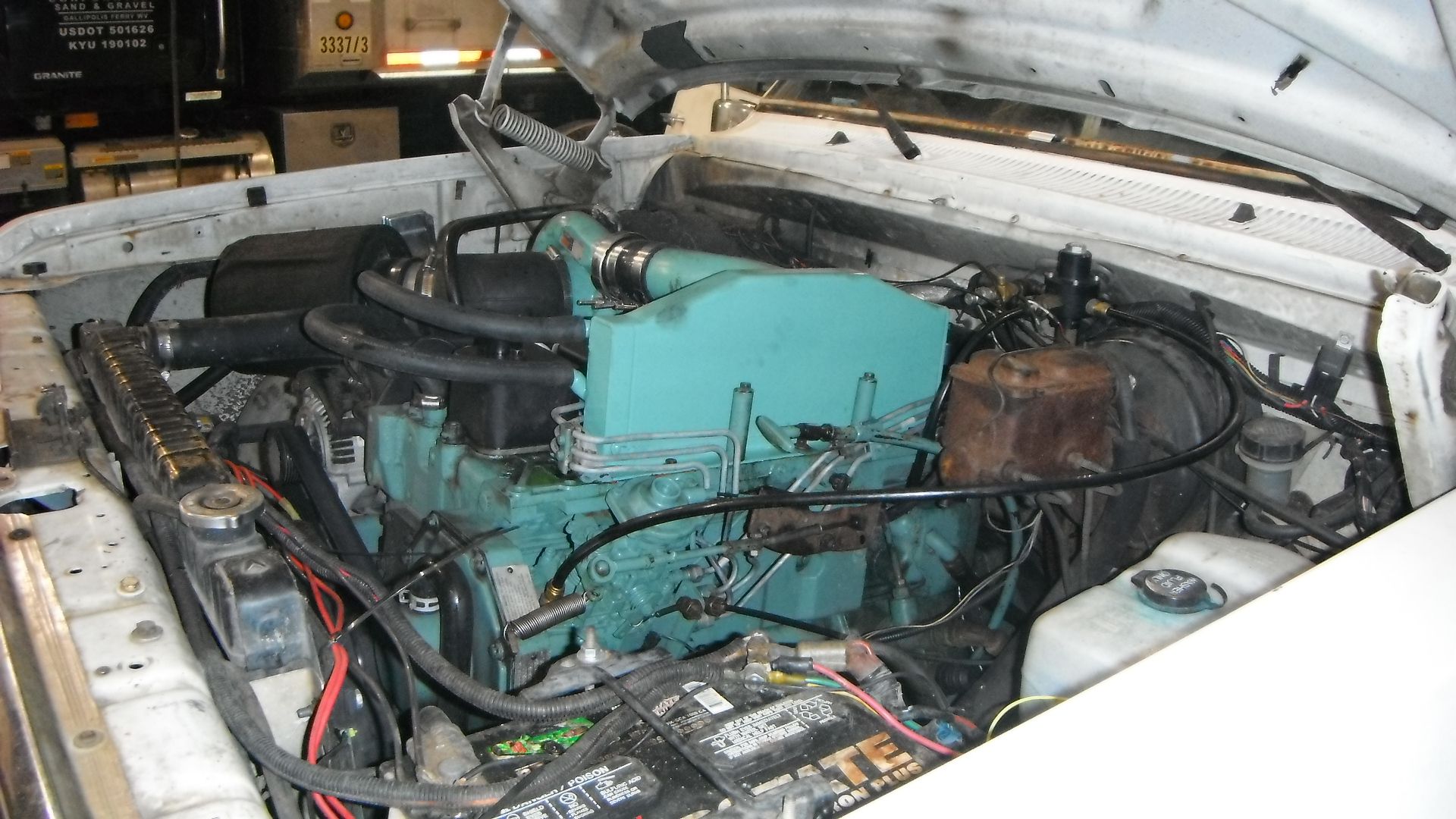

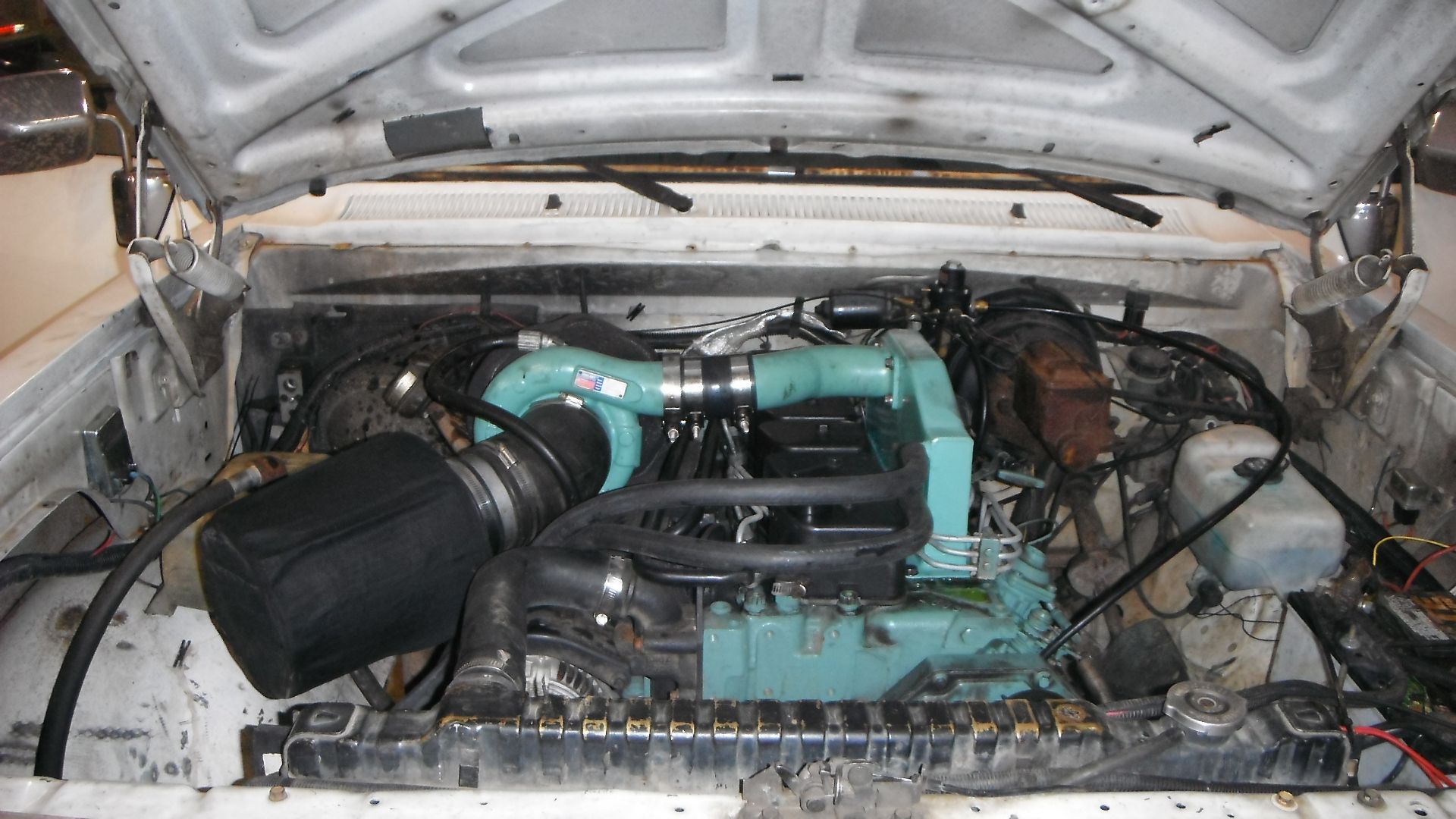

I pulled off the mega cowbell tonight, rewelded it, cleaned it up, and got it with paint. It's drying now, so il have pics up tonight or tomorrow.
Re: Boring stuff again. :(
Postby AHineman » Sat Jan 05, 2013 3:12 pm
MORE COWBELL!!! :lol:
Postby Tacoclaw » Sat Jan 05, 2013 5:00 pm
Obligatory grease smears all over it since I'm terrible at the whole patience thing. I'll let it bake on then wash/sand it off and rehit it. No more boost leaks anywhere, besides around the individual boltheads themselves and their all extremely tiny so I'm not sweating them. I'll have updated boot/EGT numbers when I can see my gauges tomorrow.

Postby coolhand_luke » Sat Jan 05, 2013 9:58 pm
I was reading back through this thread and I'm guessing the "middlecooler" came off the cummins generator? I like it, has a raw industrial look to it. Thats why I like the 1st gens, when my truck is parked next to my buddy's 3rd gen at work, its raw parked next to refined.
