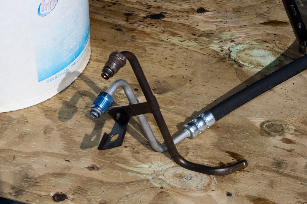

Not too long ago, the stupid power-steering pump went out.
The crap's wondering all over the road as far as I'm concerned so, I replaced the power-steering pump with one of those that sports a slightly higher pressure and higher flow volume . . . .
Screw it, while I'm in there, I replaced the steering box with one of the Red-Heads . . . . .
Naturally, the steering box mounting-plate that I replaced ten or so years ago was cracked, so I replaced it with an intact used one (I'm gonna weld-up/beef-up the cracked one for later use) . . . . .
To ensure a good long life of the two above items, I went ahead and replaced the associated plumbing . . . . .

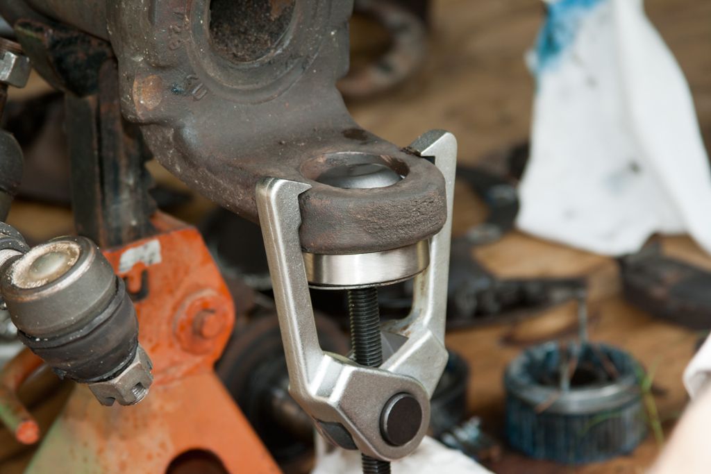

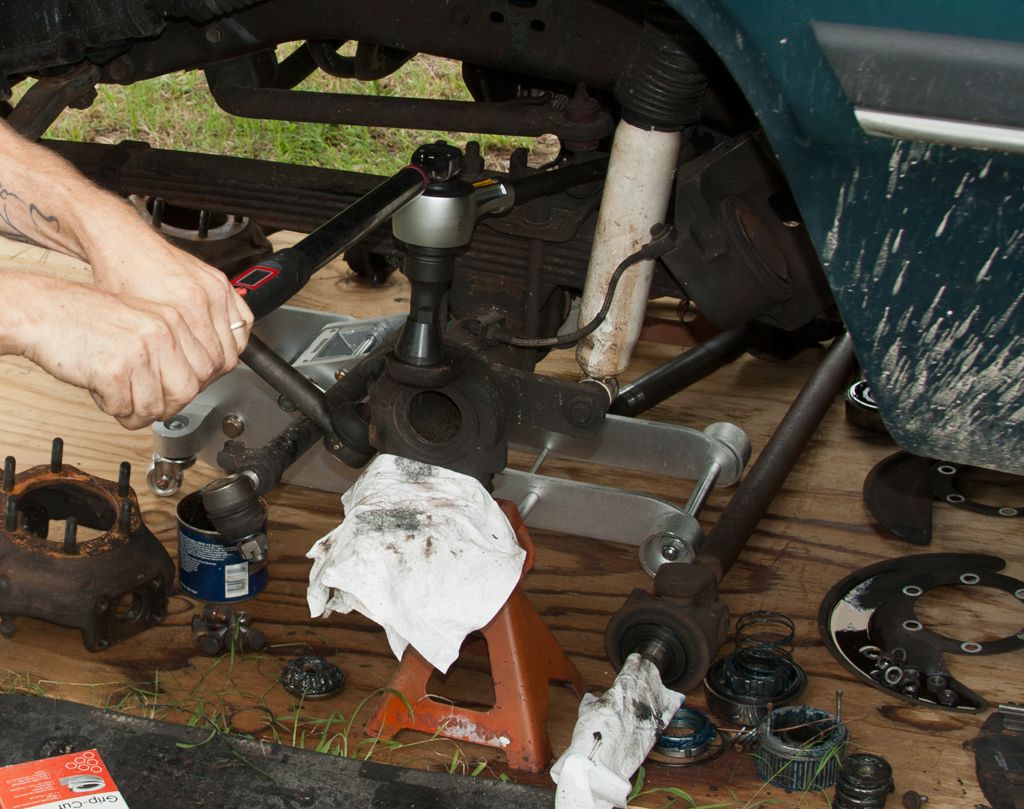

While I was in there, I noticed the tie-rod ends were sloppy. So, I replaced them, the drag-link, and rebuilt the steering knuckle king-pins.
Folks:
- I bought a torque-multiplier, and steering tool assortment. BEST! THING! EVER!
- I'm blessed to have a Son, who after all these years of showing "how to", chooses to return the favor . . . .
An honest 500 ~ 600 ft/lbs torque . . . . .

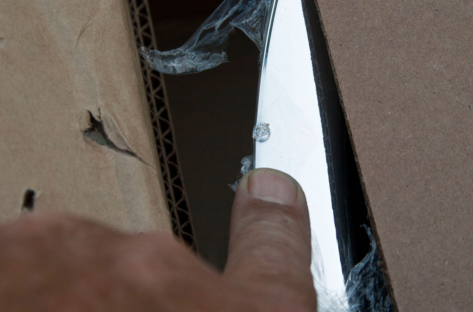

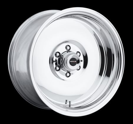

So, I've, EIGHT or so weeks ago, ordered some 20x10 Frontier Smoothy rims from CenterLine. There were none in stock, so I had to wait for them to make some.
They finally arrived and . . .WOO HOO! . .. . aw . . . . . chit!
All four, damaged in shipping, the exact same way . . . . .
Words cannot express my disappointment.
So as to avoid six or more weeks for UPS to get around to correcting their mess, CenterLine was good enough to send call-tags to ship them back to repair (dings/cosmetic in their eyes). That's been three weeks now.
I like to think my rims will be shipped back to me this coming week so I can have them mounted and wrapped with some NITTO 420s. 305/50/20. Should offer a much better ride, better traction, at a lower cost.

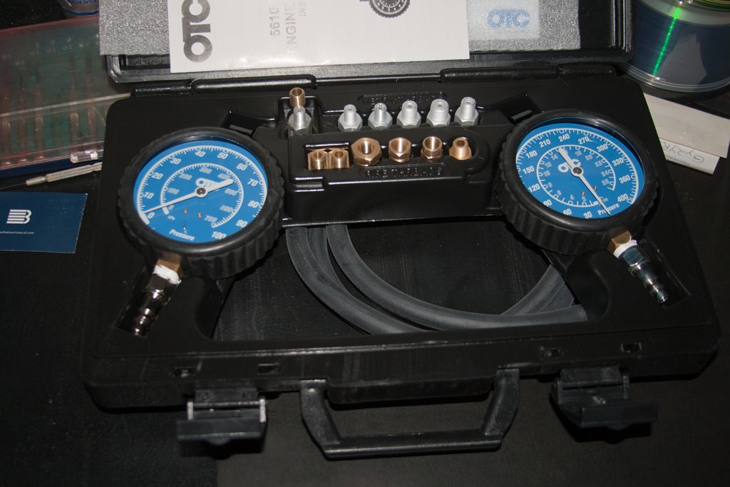

I'm embarrassed to say that, with all the beefing-up of my trans, I've never had gauges on it. I'm gonna pull the pan and see what's in the sump, and decide if I'm gonna pull it and refresh it. In the mean time, I got a set of gauges to see where I'm at pressure-wise . . . .

The overall dimensions of the new rim/tire combo will match the original less the new tires will be shy of .8" smaller in diameter.
305/70/16 . . . . . vs . . . . .. . 305/50/20
32.8" . . . . . . .Diameter . . . . .. .32"
12" . . . . . .. . . . .wide . . . . .. .. 12"
8.4" . . . . . . . . sidewall . . . . .. . . 6"
103" . . . . .. . circumference . . . 100.5"
615 . . . . . . . . . . RPM . . . . . .. . 630
https://tiresize.com/calculator/
Both call for a 10" rim. Both old and new rims have a 4.5" backspacing.
To look at it, it's the same old rim, just larger in diameter, with no bullet-holes. And no, we won't be doing the "Stance" crap. By my ciphering, they should be just inside the fender.
