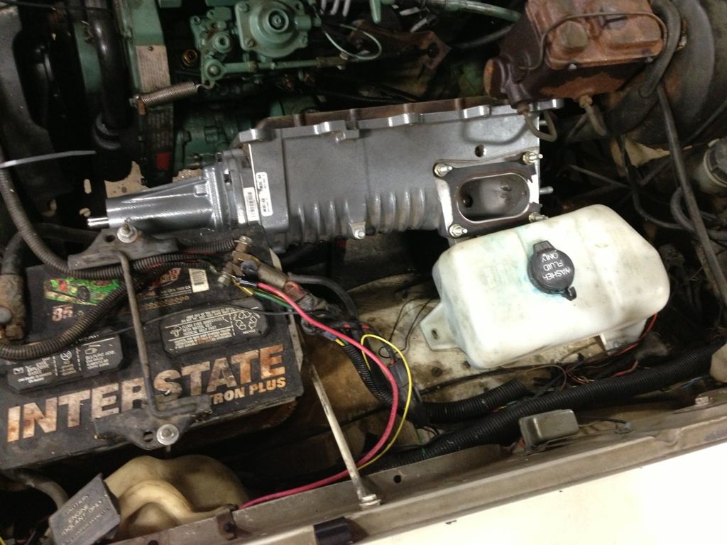

Now then, here's some pics to put a size to this thing:
Not gonna happen. :(
Here's where I plan to try it at for now. Point the compressor down and do a 180* loop into the inlet of the blower, then run a pipe over the turbo inlet tube and bring it right into the middlecooler. I'll be milling off that part that sticks out of the bottom, it's to mount a heat exchanger core into but those things are hella expensive so it's just in my way.

Postby dazedandconfused » Sat Feb 16, 2013 5:14 pm
Just a question for me but if you put it on top of the valve covers how high does it stick up? Could the hood be closed?
