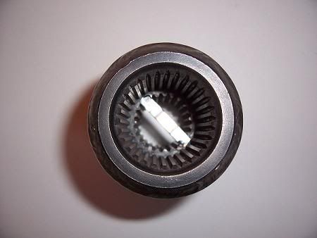

BobS wrote:Do those have the provision for the internal snap ring to keep it from walking fore and aft on the splines or a way that it always remains in the correct position?
I added a piece in the middle so there will be no issues with it walking forward or back.

I see some broken transfer case input shafts in the future from the guys putting a getrag in front of the unbelievably tiny input shaft of the auto (23 spline) transfer case. This coupler looks really good and I don't ever see it being the failure. I should get a picture, or maybe someone else will before I do, of the tiny 23 spline input shaft versus the larger 29 spline input shaft. It's not the splines, it's the diameter of the shaft.

this may allow guys to run a doubler 203/205 kit now as any one with a 29 spline trans output was out of luck as no 203's ever fit a 29 spline trans output... i had asked soem places to make what you made and they didn't want to build it for me.

therabbittree wrote:this may allow guys to run a doubler 203/205 kit now as any one with a 29 spline trans output was out of luck as no 203's ever fit a 29 spline trans output... i had asked soem places to make what you made and they didn't want to build it for me.
I probbaly will be picking one up when i get some extra cash.
Sounds good and thanks for the info, I am finding out there are many different uses for the coupler other than my original intentions.
Question: Are there 203's with a male input shaft? The only ones I have seen had a female input and didnt use a coupler.

HA my Bad, You are correct the connector is a spud shaft any way you could make up a spud shaft that is 29 spline female and 23 spline male?...
