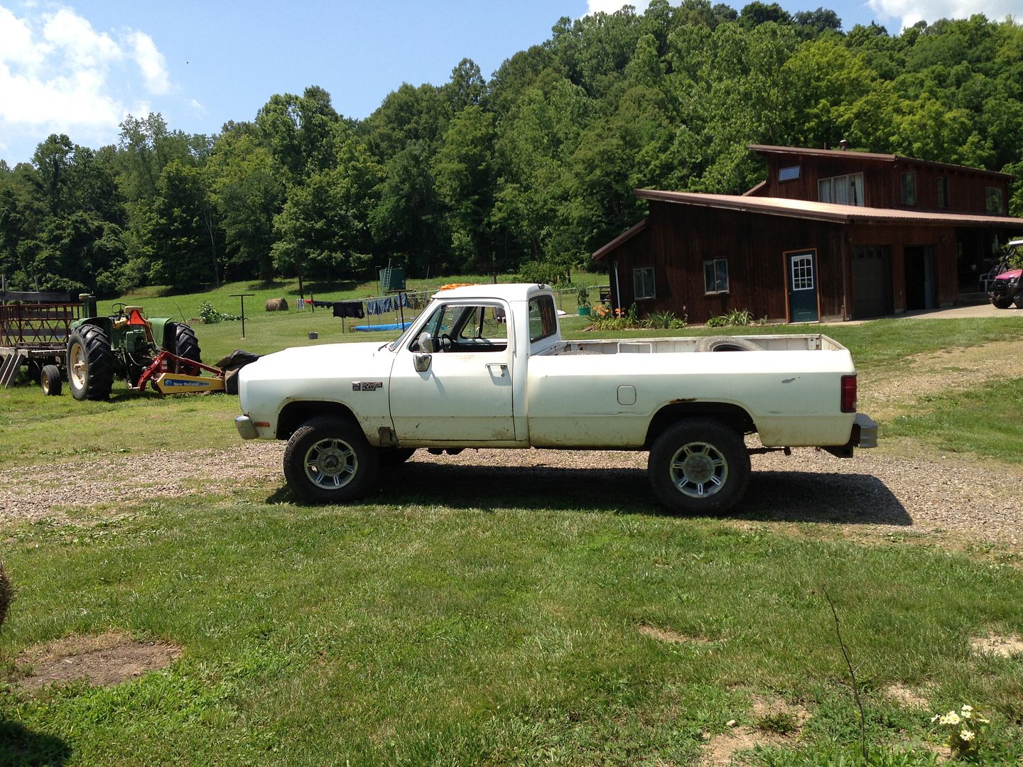

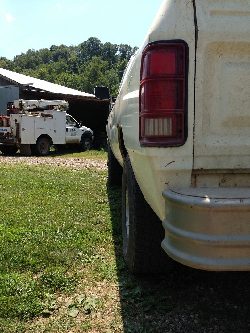

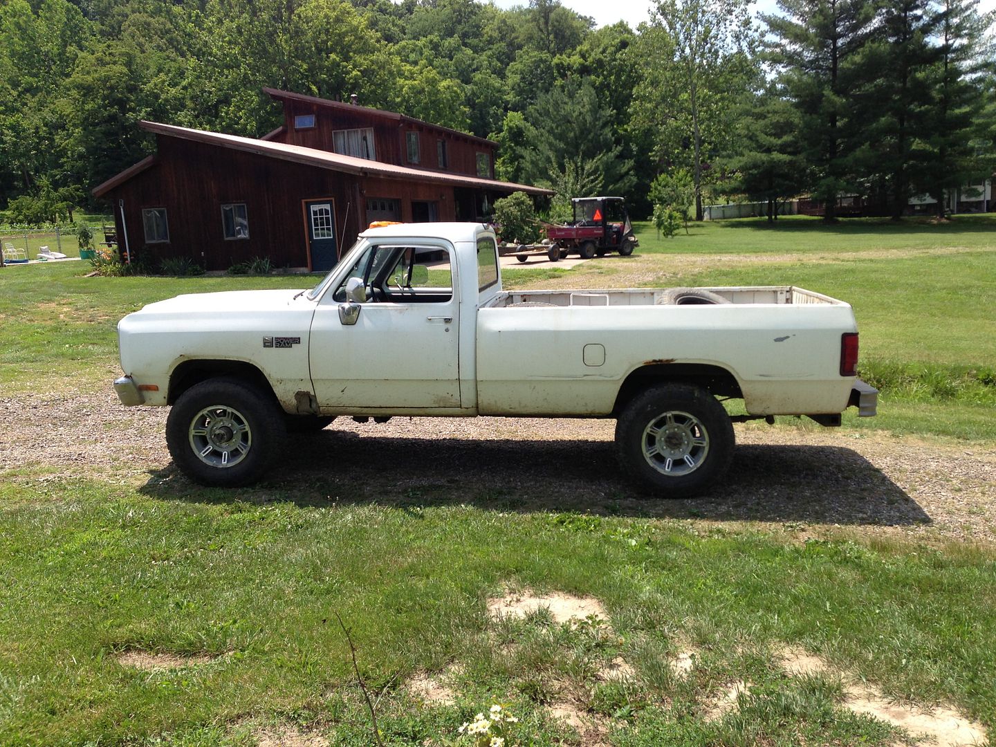

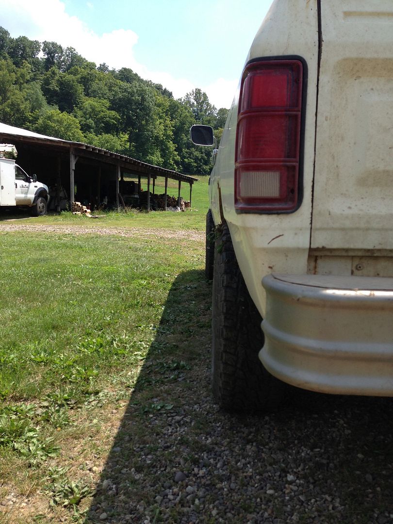

Grabbed some new wheels, not the 3rdgen wheels I was looking for but I think I like these a bit better. H2 wheels, no spacers and 295/70/17 Nitto AT's. Only slight rubbing anywhere on the truck, even at decent flex, was at full lock right it rubbed the draglink at the steering box end.
Then I decided to throw on the spacers I bought in anticipation of 3rdgen wheels. 1-1/2" front and 2" rear. Still no rubbing, though I haven't flexed it much with these on yet.
Daddy likey, and they're big enough that they won't look ridiculous with the 2-3" lift the RC will end up with.
