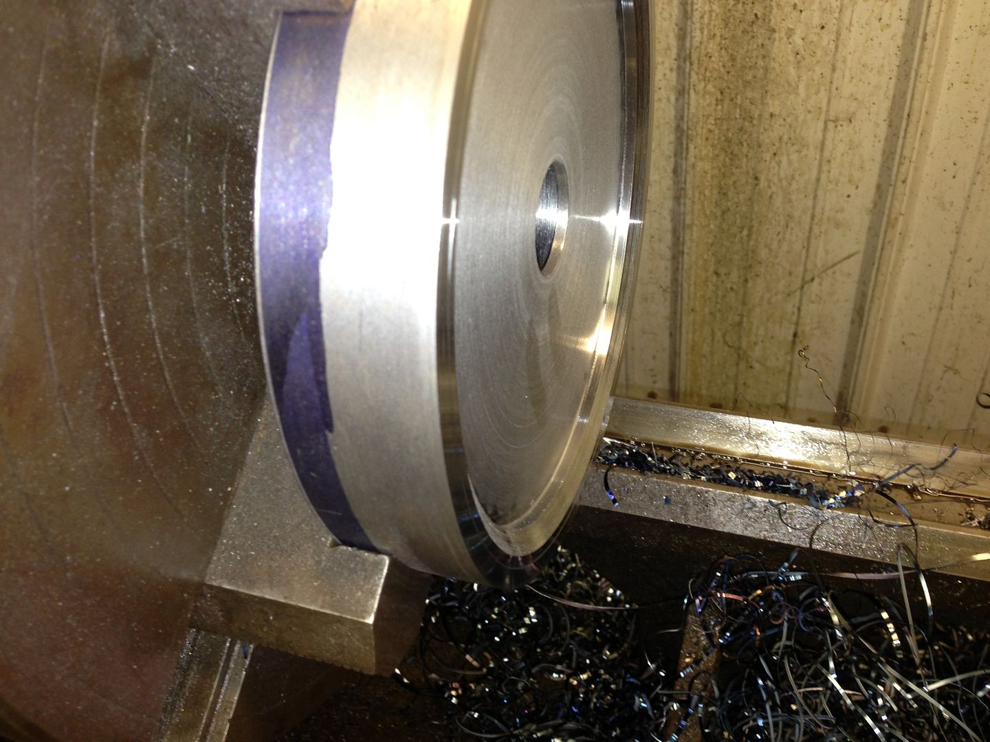

I'll edit when I get home, I'm still working. Here's the pics so far.

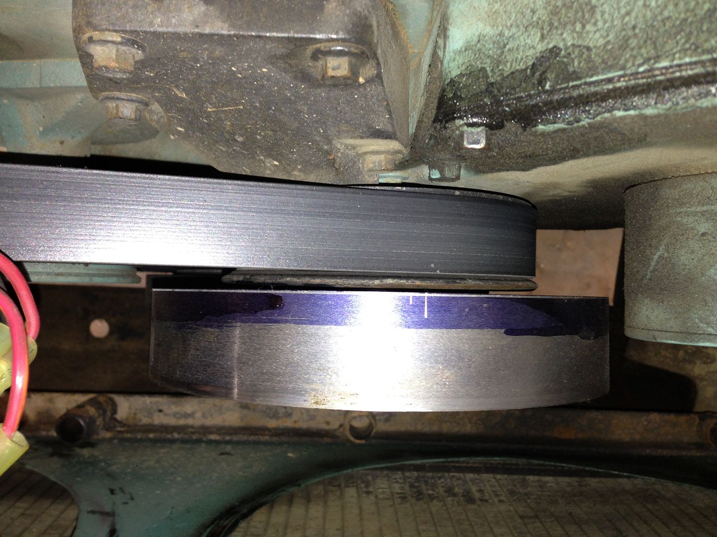

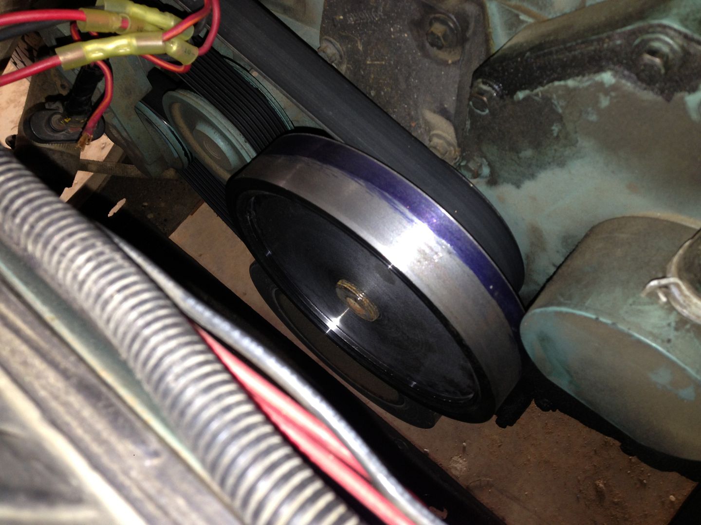

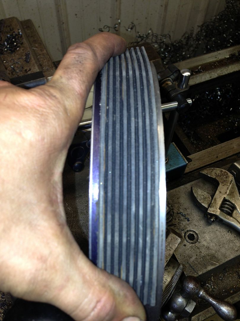

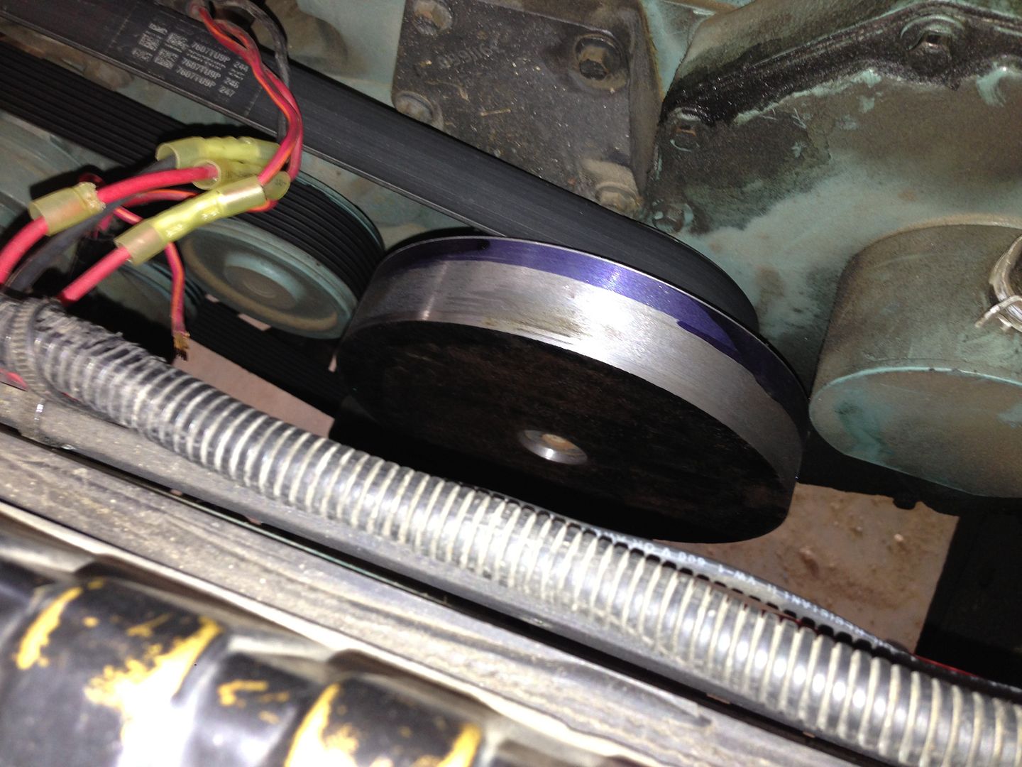

Bleh, it's 10:15 and I honestly don't have a lot to sat that you can't see in the pics.
I will say that I cant get my finger between the breather and the pulley and the balancer is even tighter. Tight enough to make me wonder if a belt will fit in there, but just in case I left enough meat on the pulley to turn it down to 7" if I need to. Once I get it sorted I'll drill as many holes as I can in the thing to try to lighten it up, along with lathing off any material that I don't see the need for.
Mounting flange is 1/8" thick, I figure that'll be strong enough, the stock fan pulley is thinner than that.

Postby ellis93 » Wed Jul 17, 2013 7:49 pm
It looks good Levi :thumright:
Have you figured on how to add tension?

Postby Tacoclaw » Wed Jul 17, 2013 8:01 pm
Not really, I figure I'll just get a standard tensioner, possibly the very one our trucks have already, and just have a surface to mount it to off of whatever holds the blower to the engine.
As usual, I'll worry about the details after I've wrestled a 70lb blower in and out of my engine bay 40 times. :lol:
