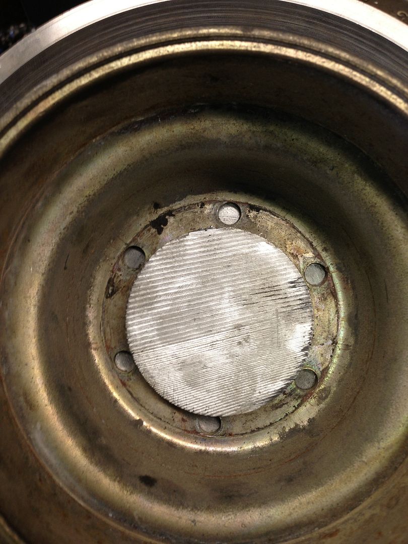

It's not all progress though, my cutter didn't even scratch my pulley, I think someone threw a piece of keyway in with our HSS blanks, so I just marked the grooves on it and quit for the day.
I've got to order that multifunction switch and see what it consists of so I can tear the column down.

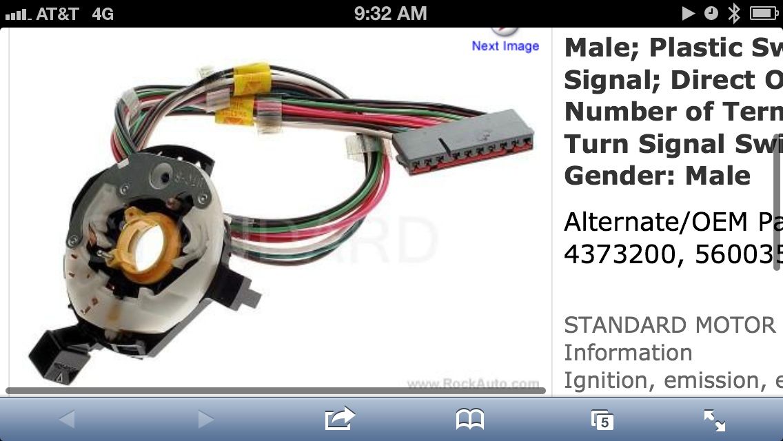

Is this what I'm after? I ordered the deal from Carquest but it's a newer-style switch.

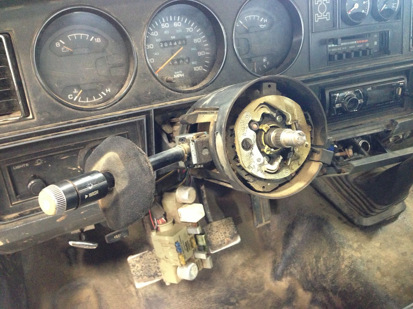

This is what my truck has for a column. :?
Re: '90 W250
Postby Tacoclaw » Mon Jul 22, 2013 6:50 am
Never mind, got to looking at that pic and noticed how long the wires were. Tracked them down to the base of the column, gave the connector a wiggle, and I now have brake lights.
