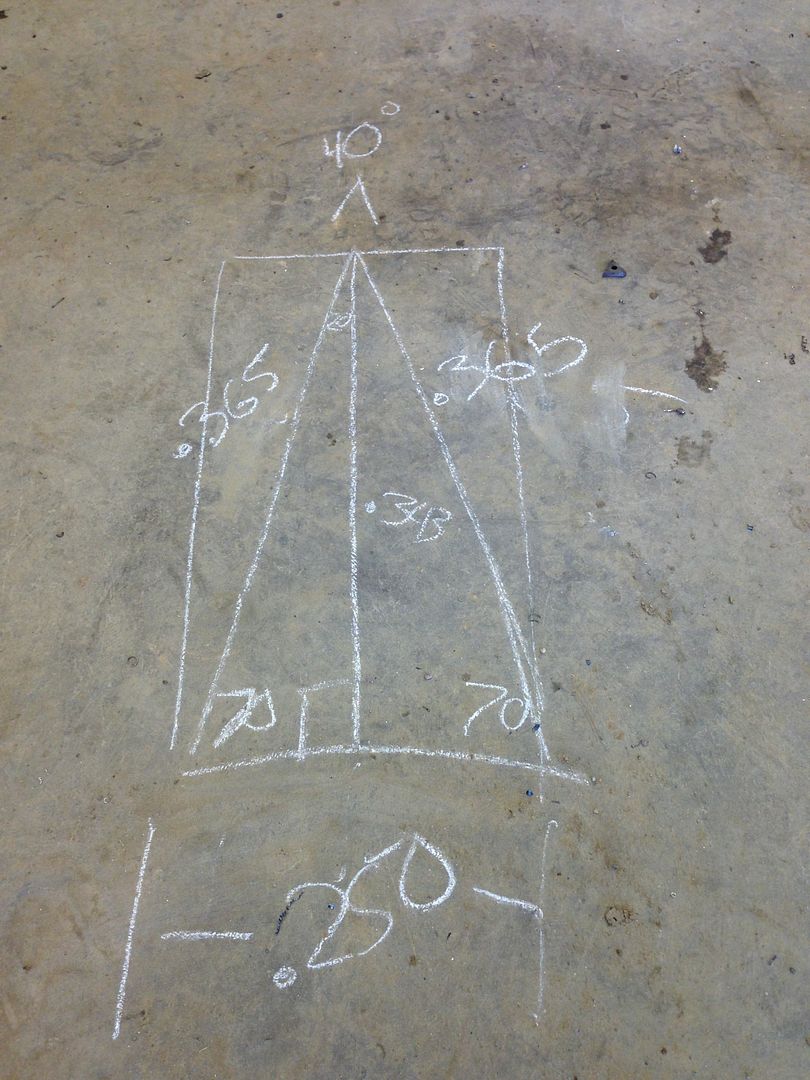

Just in case any of you drive my specific truck here's my blueprints of the blower pulley. This will get you just clear of the accessory belt with my specific fan pulley and mount. I'll get their part numbers later. Also, the smallest hole sits right on the fan threads, I figure you could fit your stock fan back on there if you enlarged it enough to clear the hex. Dunno if the blades would clear the belt though. =\
Also, I'm still not sure if this thing will clear the balancer with a belt on it, 7.5" may be too tall.
Here's the cutter you'll need to make serpentine grooves, the point is actually radiused a bit but you'll just have to experiment that for yourself.

The way I run a lathe it's more like hangman. :lol:

Postby Tacoclaw » Tue Jul 23, 2013 2:57 pm
You've got to know your limits and here's mine.
Re: '90 W250
Postby PToombs » Tue Jul 23, 2013 3:23 pm
That doesn't look like a 7.5 inch pulley to me! Or is the camera way far away? :?
Re: '90 W250
Postby Tacoclaw » Tue Jul 23, 2013 3:27 pm
Practice piece, I'm not as dumb as you think I are. :P
